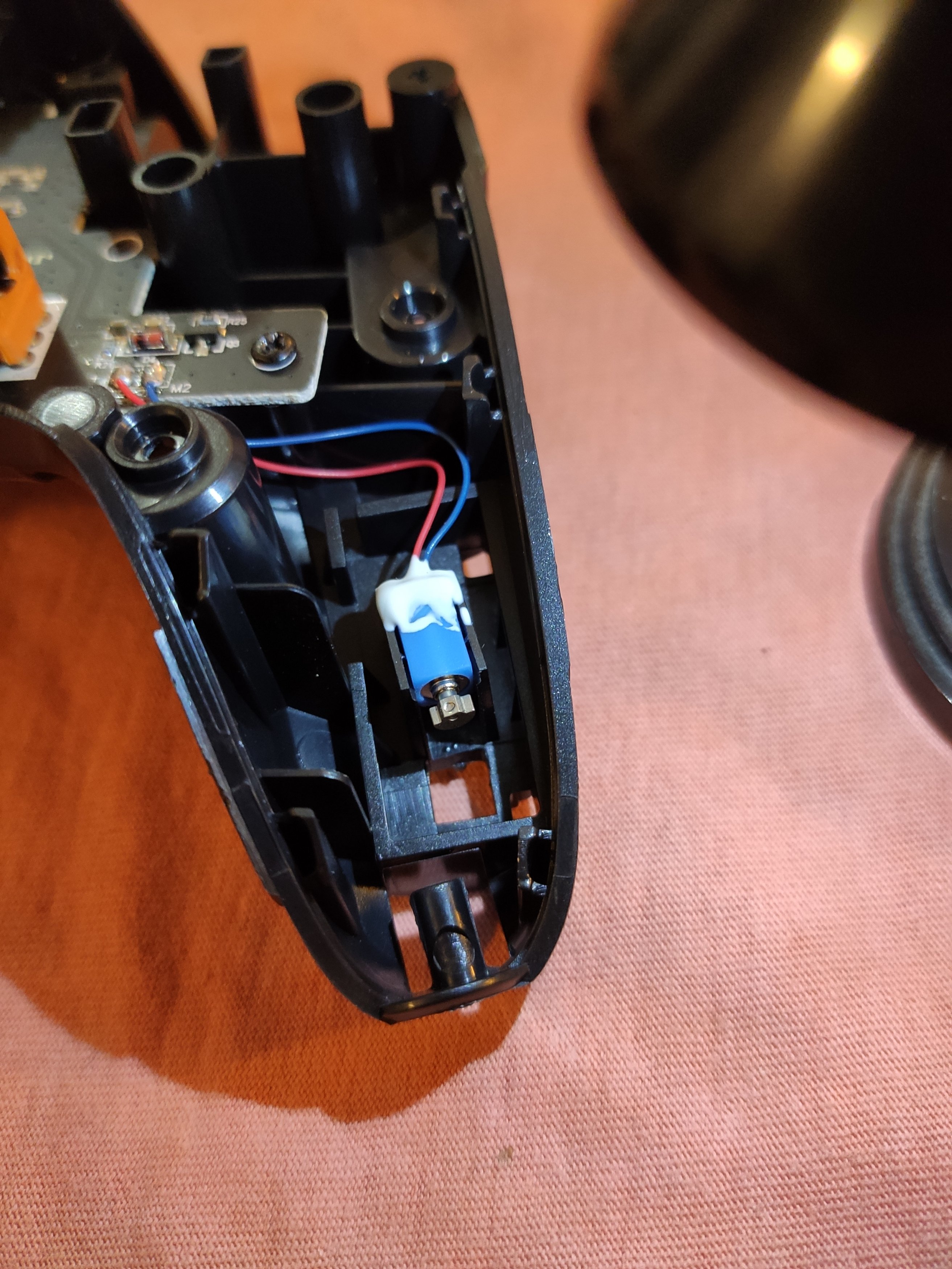

Some Tips to mod the fake controller.
Remove the Motor from the plastic and cut out this plastic tower.
Then glue the motor with hotglue in the Plastic.
That make the motor more silent then Original and it feels better then Original.

Let this try to install hd Rumble.
It's not the work worth.
They work but it is ultra low and hundert of miles from a correct working HD Rumble away.
It like the Power they got is too Low because the Vibration Motor take less power then a HD Rumble.
Several Uer Try it and I Try it on my 2 different Boards too.
Result I build they out and insert the motors again because they are better then a HD Rumble in these Controller

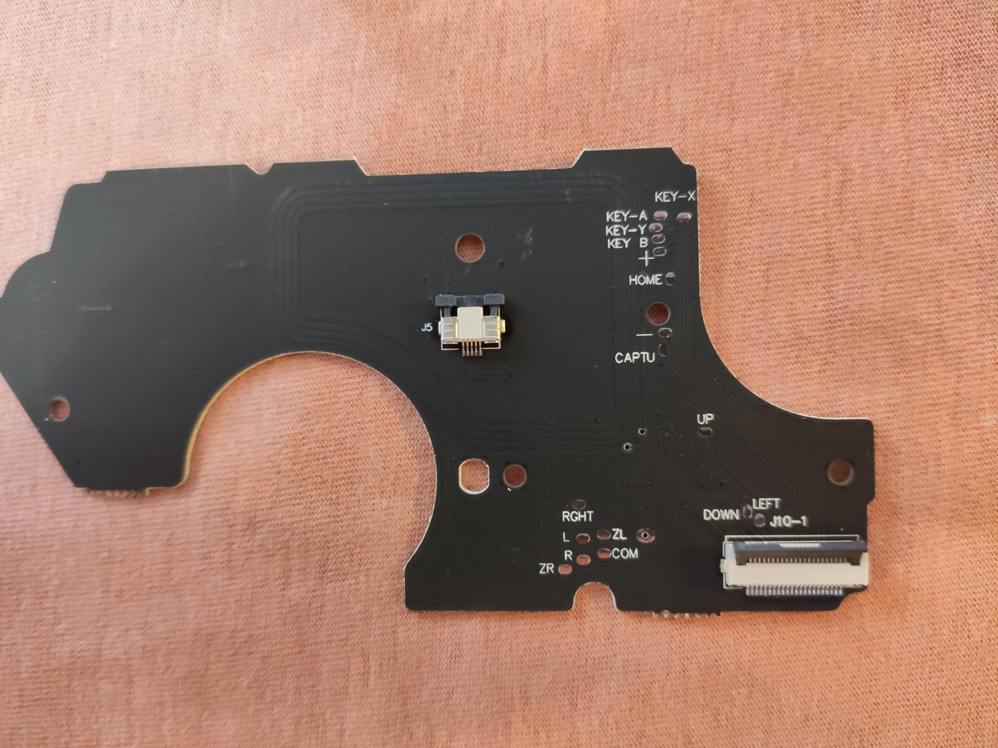

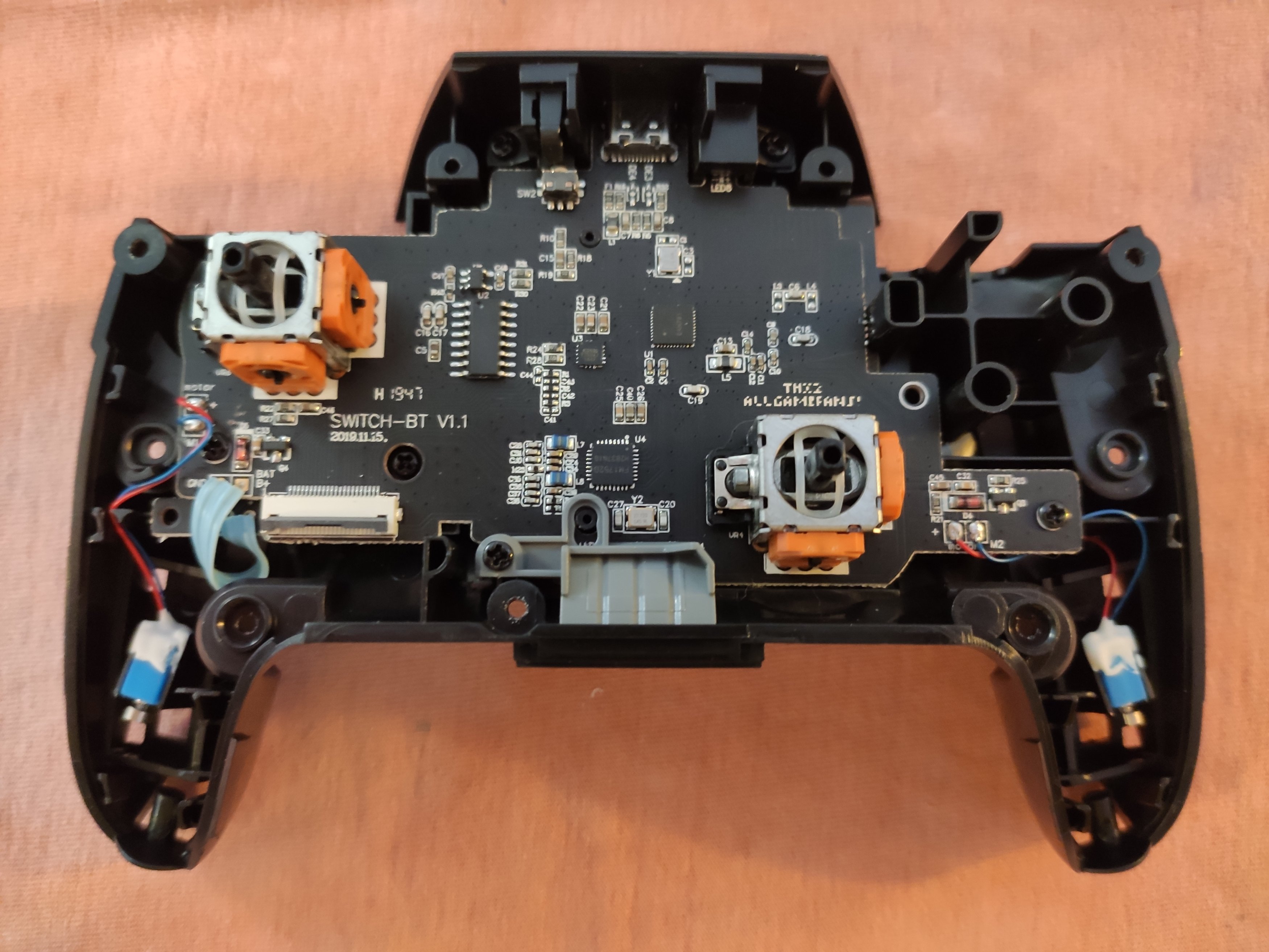

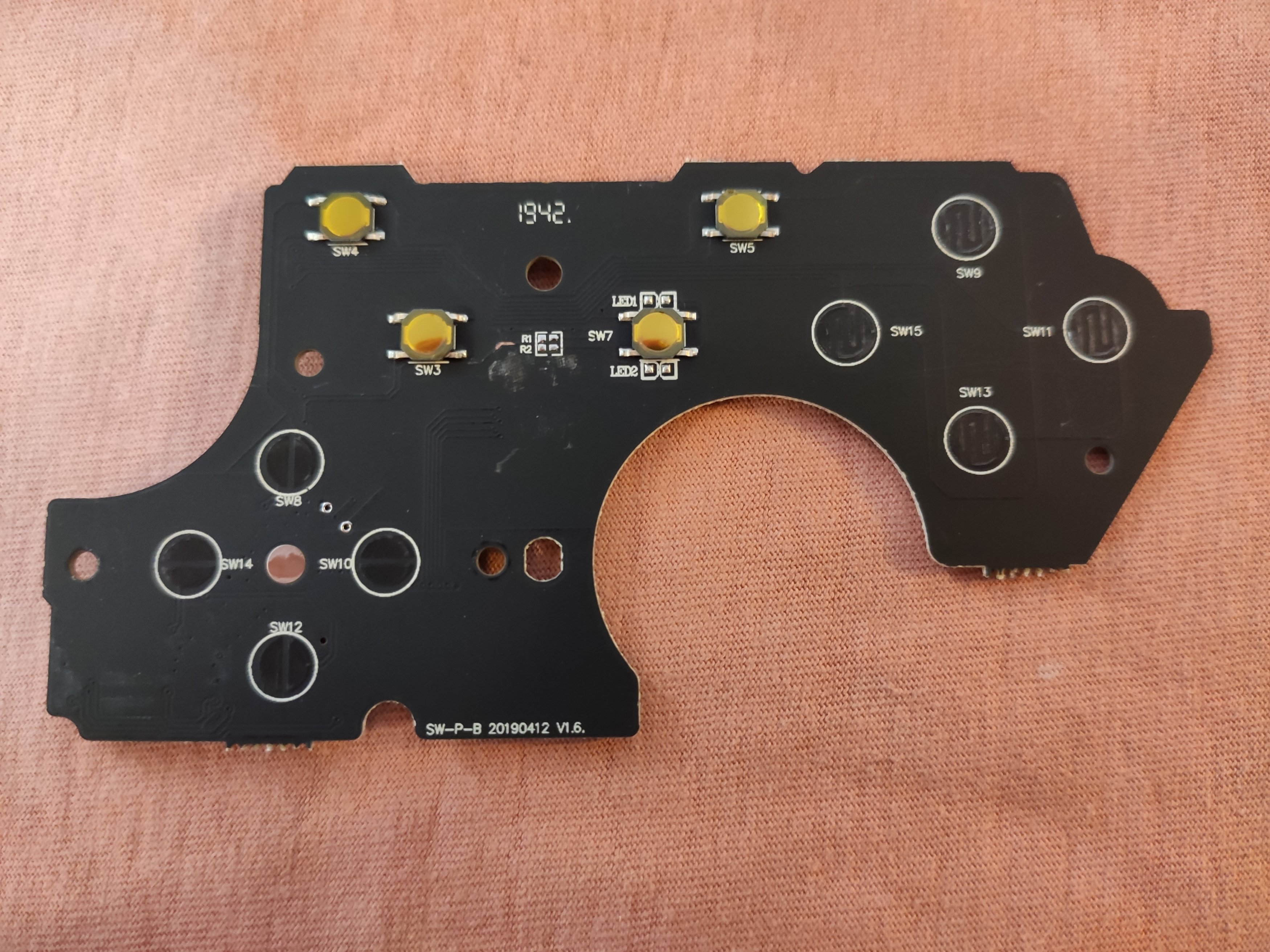

I recently found a new fake switch controller that was told that does include NFC functionality, after getting one that actually not, disarming it and finding this forum in the way of searching how it works I decided to buy it and finally came.
First, it displays Nintendo logo on the front and in the backward, weights a bit more and feels like the others.
Once opened we can see this board.
Pretty different from our 1.3 and 1.6 PCBs that I saw here but looks like joysticks are the same. It is dated of 2019-11-15 but seems to be from another manufacturer as it is not 1.8 or something like that; same material even though.
The main reason why I bought it was to know the differences between this NFC version and the other ones, to see if it could be implemented in someway. Surprisingly, the top board are exactly the same (that means other controllers also have the NFC antenna but that PCB does not implement NFC at all). No notificacion led but I found that despite not in the description of the product, it does wake up console.
View attachment 216323 View attachment 216324
We know that upper PCB is compatible with new controllers if they broke or don't work properly.
I also discover that as the original, plastic letters and arrows are plastic inked, so cannot be erased with use. Don't remember if other also have it
Battery looks the same.
View attachment 216320 View attachment 216321
Finally I want to test if this PCB does support HD-rumble, not likely but possible. Have to mention that rumble in this controller is terrible, even to disconnect it.
I wanted to share it if it is usefull to anybody and listen your thoughts about it.
