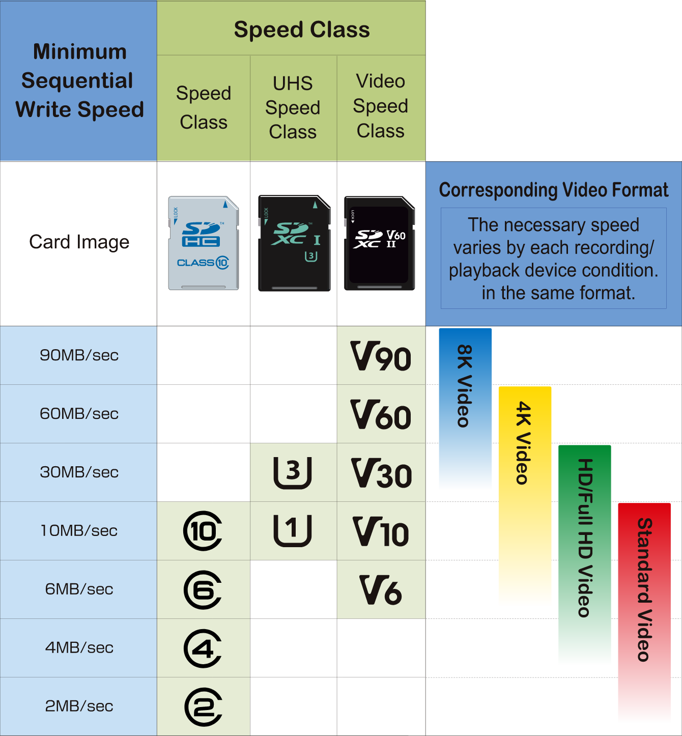

One question though. How do you tell what cards have good random read/write as you guys mentioned above? Is there anyway to check?
Edit: Oh and I saw someone mentioned about what R4 I used and what kind of microSD I have. It was an R4 2021 with an 8GB V-Gen microSD
Sypherone
Gaming Ninja
GBAtemp Patron
Apr 28, 2019
1,660
44
2,890
Germany
The Cards have specific symbols wich determine the minimum write speed.
Depending on the model you can then check the manufacturer manuel for read/ write speed details. There are also a lot comparisms and test tools available on the web.
