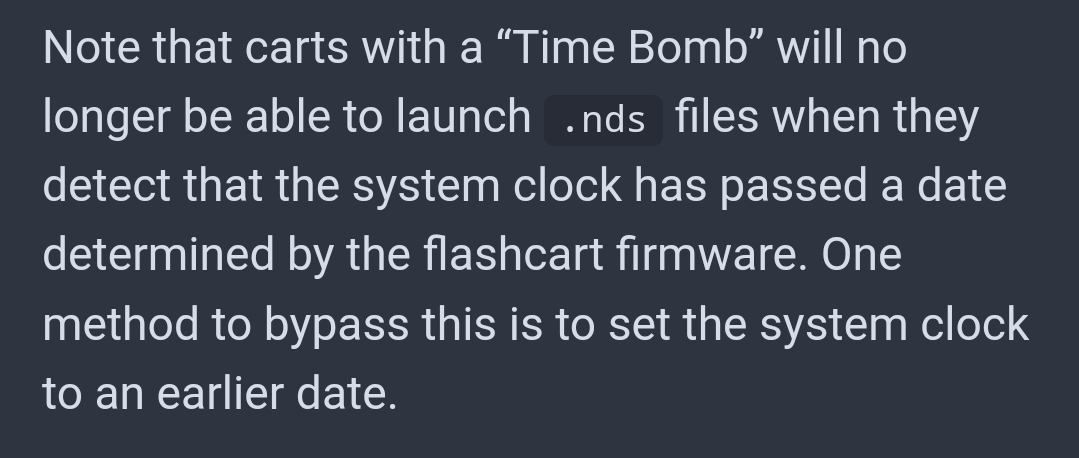

Iam not sure atm if it change something, its just a try. U can try dont using the latest kernel for the Card, but the one from 2020. For using the outdated kernel set the time of the 3ds to something befor the timebomb expire.
