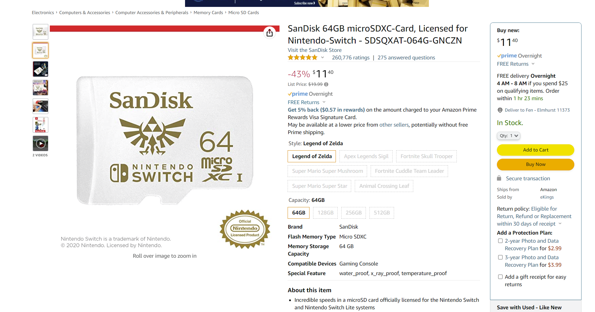

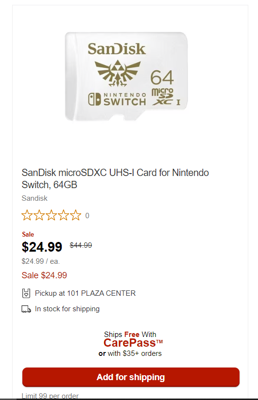

Actually you over spent when you shop at CVS Pharmacy. Seriously who the hell buy SD card from Pharmacy, obviously it is overprice at $24.99 compare to Amazon at $11.40. What I was saying if you just buy a non Nintendo branded SD card you can get higher capacity at the same price probably.
