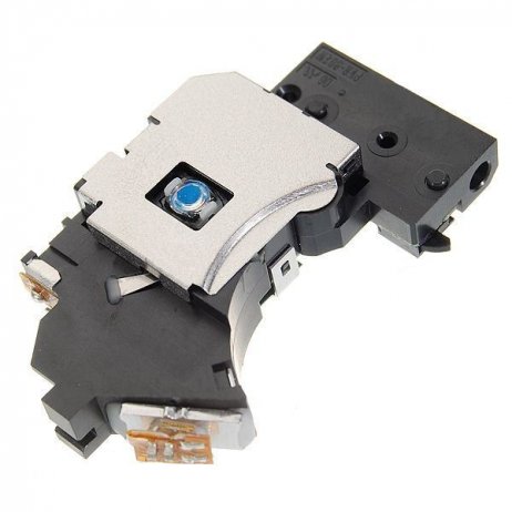

Maybe you´ve ordered/got the wrong Laser type.:unsure:
You need this one:
PVR−802W
https://www.amazon.com/PVR-802W-Console-Repair-Replacement-PlayStation-2/dp/B074Z5F77Q
You are most likely right!
I bought a KHM-430A. What is the difference? They look exactly the same :/
I had difficulties to find the exact model of the laser since it is not mentioned on the laser unit itself so I decided to buy the model above. The product information mentioned compatibility with 7xxxx models. That means 77004 is not part of it :/ What a weird thing to put it that way.
Thank you anyway! I'll buy the new laser right away so I can fix it in a few weeks.
Reactions: Alexander1970
Thank you.:)
Differences:
PS2 series 700xx - 750xx uses both types.
PS2 series 770xx ONLY the PVR-802W.

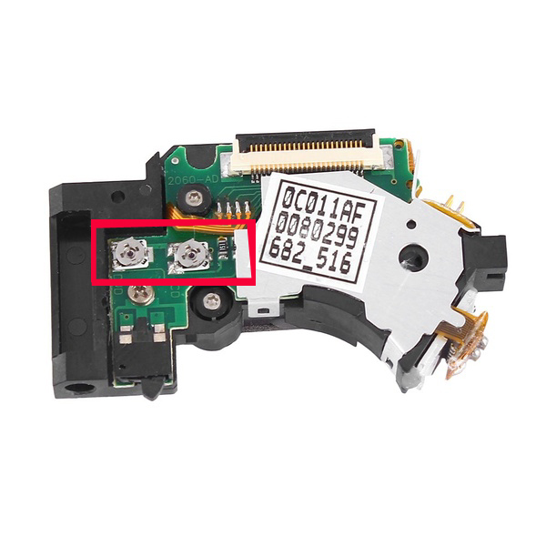

Maybe also the LASER of CD/DVD has to calibrate first.Some customers reported that (Amazon)
I hope yours looks like that:
Sorry,i don´t have any Idea how much you have to adjust.My tip: slowly,in tiny,little steps and carefully and after each move,try it.Maybe you can look in the Internet/Youtube if someone has experiences with this Lasers.
