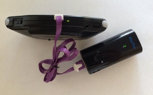

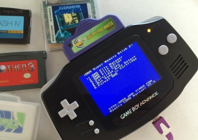

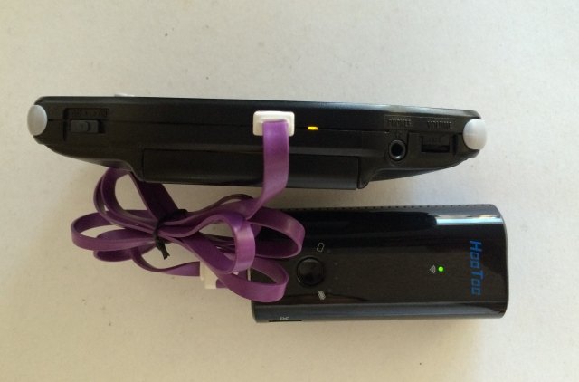

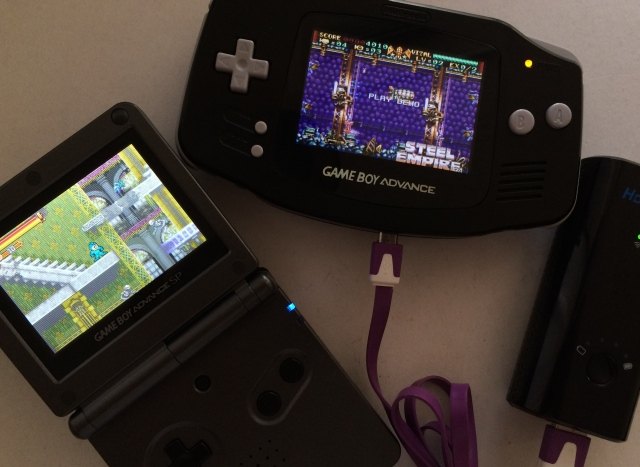

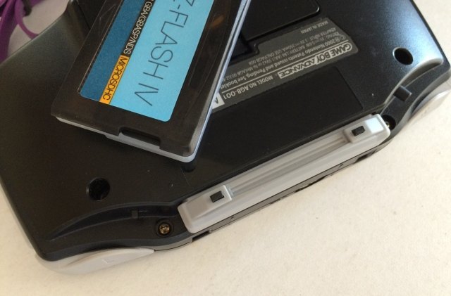

so,it's my 3rd gba [hoarding] project, modded about a couple of months ago, i think.
featuring a legit black japanese gba housing, pcb, and buttons. AGS-101 backlit screen, ags-101 adapter cable with dual brightness switch [ebay], new slide switch on the left shoulder edge of the unit for 2 stage of brightness, pushbutton Reset switch on right shoulder. 8Mhz Crystal for 2x speed with a flip of a switch [swapped with brightness switch on the lcd cable] inside the battery cover [overclocked doesn't work on all retail carts. gba flashcarts will not boot at all except gameboy carts], an Amber LED power indicator on the front, microusb port for 5V charging and external power, lithium battery charger board, internal lithium rechargeable battery, 3V regulator circuit, dual LED battery charging indicator, glass lens and..that's about it. i think.
