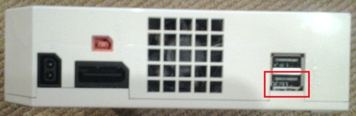

Did you plugged your USB Device in the correct Port 0 please ? :)
i've tryed the wii sports (300mb - .wbfs) and sonic unleashed (3gb - .iso). My HDD have 300GB, used to work before i format.
I try both plugs and the port 0 initialize the usb loader but returns to menu and the other port don't even open usb loader
