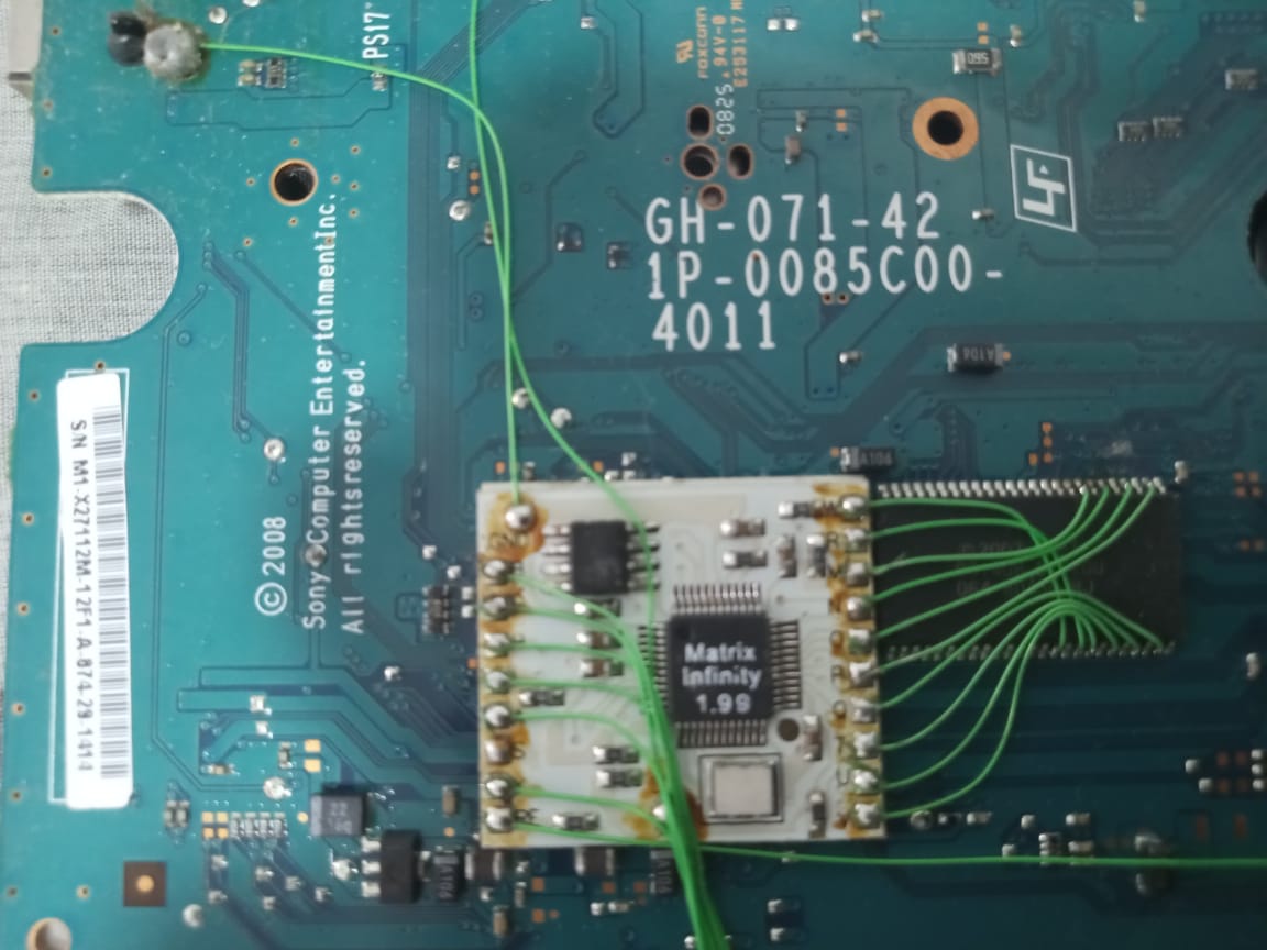

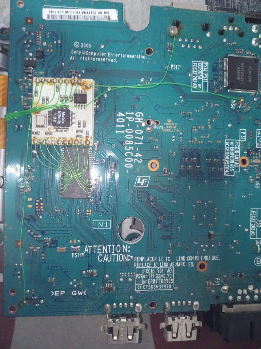

Okay, I just decided to open up my console to find out what Modchip it has installed. Here are the pictures, maybe someone knows what chip it is and what is causing the problem.
This is a Modbo/Matrix Infinity clone. The firmware, v1.99, is not official and doesn't contain major differences over the final 1.93 release. Depending on which place you get them from, some doesn't save the configuration properly. Maybe swap the chip over for a Modbo 4 or 5.
