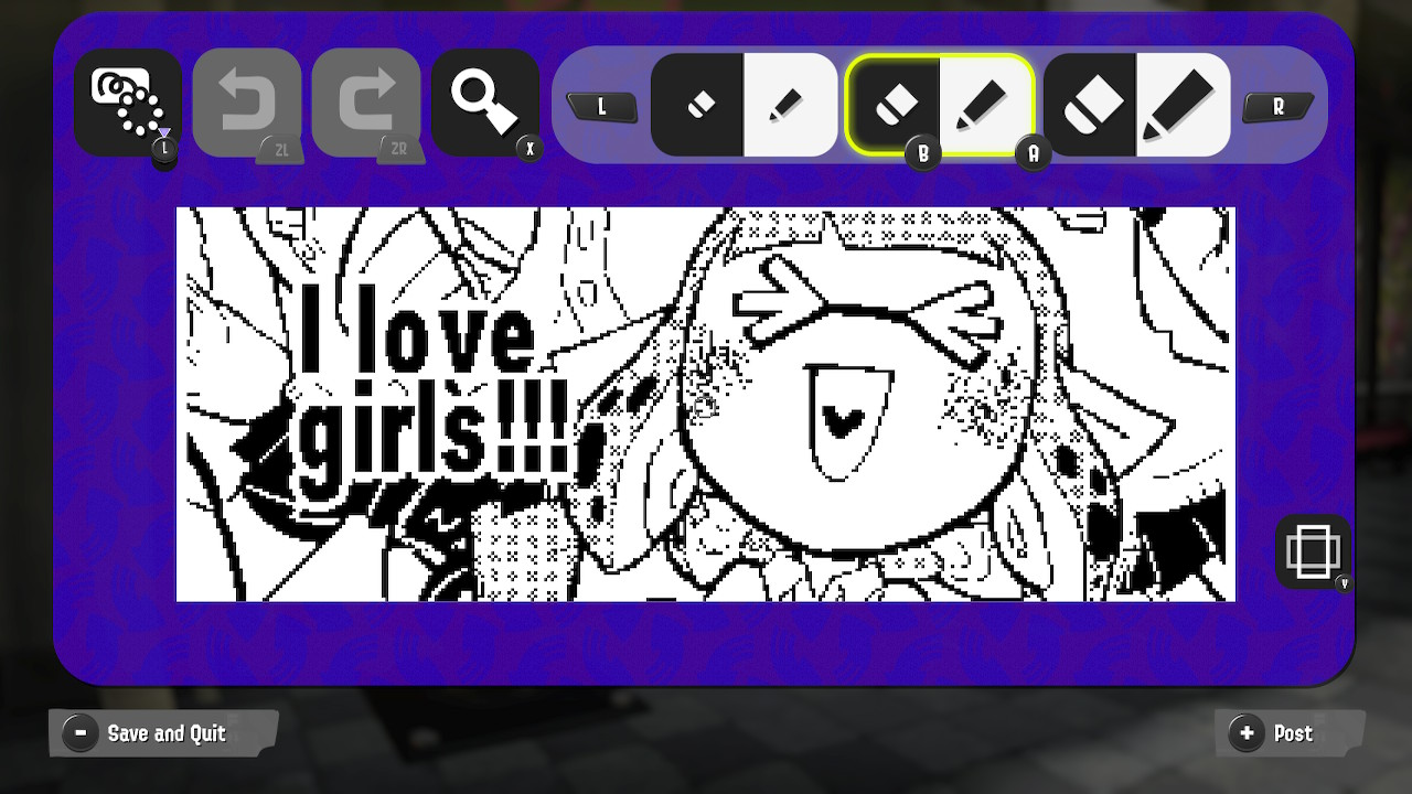

Hi, I have a teensy 2.0++ and Im new to this entire thing. When trying to print, it would print the first line correctly, but afterwards, it would print only from the center, and completely ignore the right side of the canvas, while also skipping a line. It was already a pain to get the teensy 2.0++, do i really have to get ANOTHER board or is there really a solution to this?
