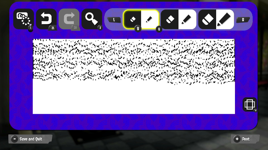

You can also replace "SWITCH_MINUS" with "SWITCH_LCLICK". My only problem now is that the cursor is wiggling and rubbing up alongside the sides of the canvas.
This is what happens to me
Reactions: Kamille and Rayya
How were you able to get your arduino to choose the left most pen option? for me it's constantly using the middle pen.
EDIT: I managed to fix the problem is an unorthodox way. This works for splatoon 3 players who want to change the pen size. This will use the smallest pen available instead of the medium sized one by default. It follows the same steps as outlined in Raaya's post except instead of the button being linked to clearing the screen, it's now used to change the pen size.
// Clear the screen if (command_count == ms_2_count(1500) || command_count == ms_2_count(3000)) ReportData->Button |= SWITCH_MINUS;
to
// Clear the screen if (command_count == ms_2_count(1500) || command_count == ms_2_count(3000)) ReportData->Button |= SWITCH_L;
Someone else out there probably knows a better way to do it, but since I have zero experience in coding anything, I figured I would just switch a command to do something else. The only downside to this is that it will start with one dot that is medium size, until it switches to the smaller pen.
