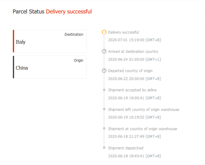

I read pretty much each page of this thread and I guess I‘m ready to order now
Still I have 2 more questions:
1. Compared to a PS2 Modchip install on a slim console - do you think the soldering to the caps on a core is easier or harder?
2. I‘m from Germany - what’s my best option for ordering it right now? Ali+DHL or sth else?
1. Quite a bit harder, the caps are way smaller but its definitely doable if you have a steady hand
2. Ali with DHL if you want it fast, slow shipping if you dont mind waiting a little. (I used slow shipping and it took 12 days from china to italy with half of it, 6 days, being stuck in customs)

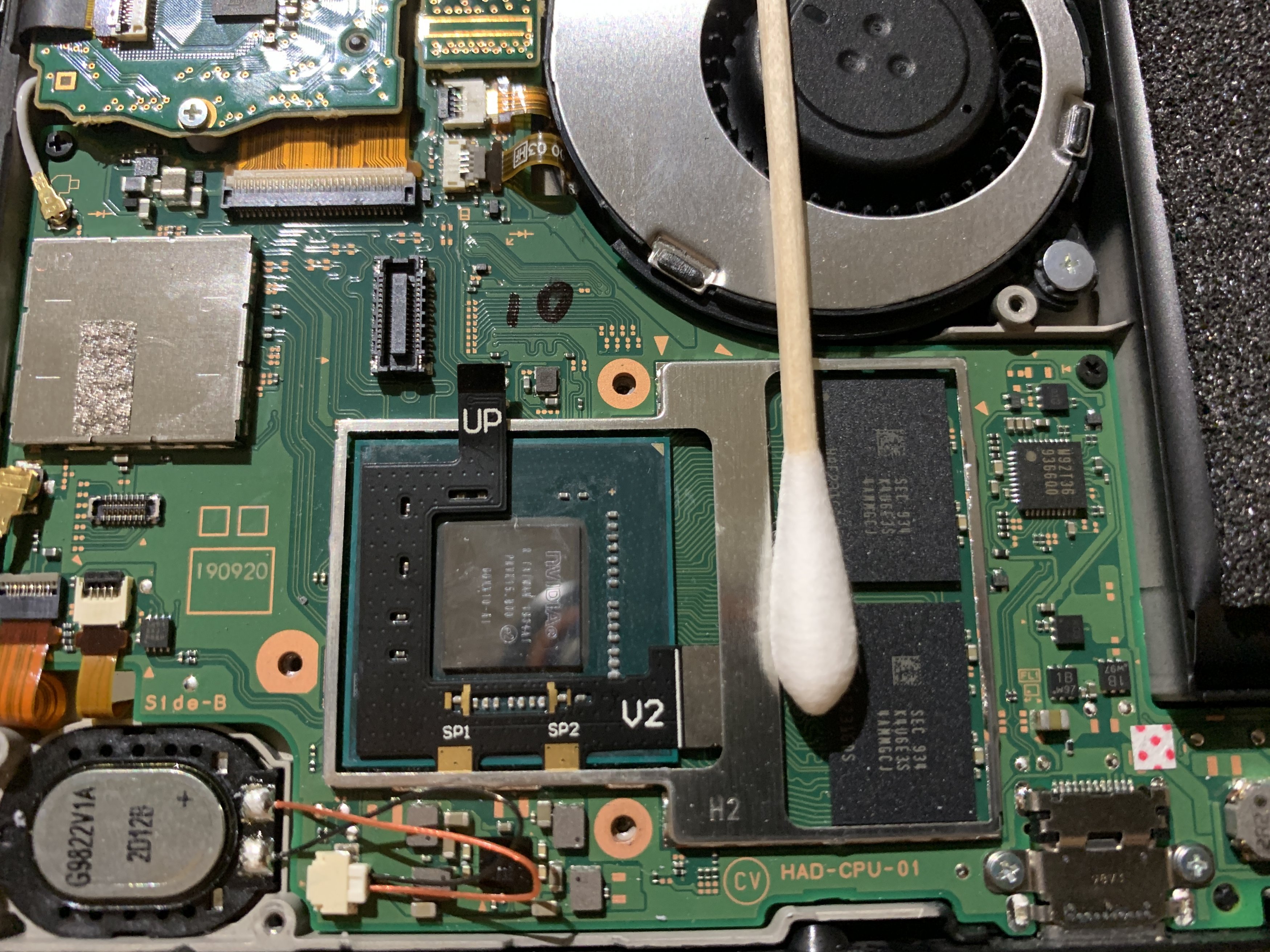

Well my Core arrived and there is no way on Earth I'm attempting the install. I've stripped down the Nintendo Switch in to it's constituent pieces and cleaned all the paste off and will be pasting with MX4. Here's a before shot of my Switch before someone does surgery on it! Please let me know if you see any defects in my tear down. I was very careful.

its looks fine no defects and yeah its tiny, the left SP1 and SP2 are real annoying
thats whyt he V1 People have it so easy lookm at the solder points,
yours should look something like this when done
Reactions: Retic1337

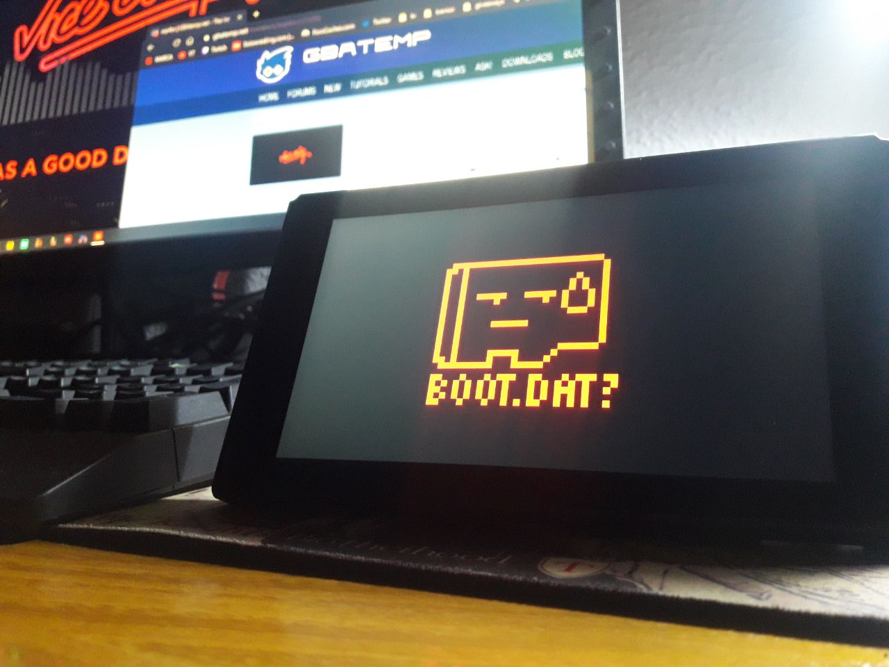

Success! Didn't give me any problems soldering and I got the green light and grumpy face on first boot.
The problem came after I'd added the boot.dat to the sd card. It was stuck on the SX OS logo indefinitely.
I tried a bunch of stuff (reformatting the SD, redownloading etc. ) but it still wouldn't boot past the SX splash screen.
Thinking I'd try updating the firmware via USB, I plugged it into my PC. As soon as I did, it autobooted into OFW. I shut it down, and it immediately booted into SX OS and its been fine ever since. Crazy
Dumping NAND now :D
