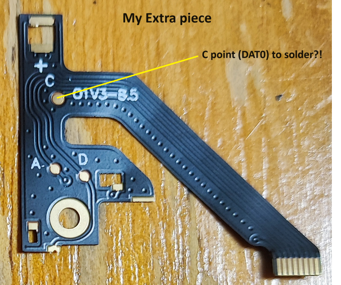

Hello @Eveldee , thank you for asking for a picture because now I've noticed that the photos in the product description, where it referred to a piece labeled "Version 11," don't have any writing on the piece (perhaps it's their internal numbering to indicate the eleventh revision?!).
In any case, this is the kit I have, but also I'm not sure if I need to use the soldering points 3v3, C, D, A, and B on the main chip board, or if it's enough to use the various connection ports once the various board pieces are soldered in their respective positions. I've seen millions of videos with different methodologies, but for a clean job that reflects my kit, do you have a guide to recommend, please?
This it's the pic of the kit:

You have a HWFLY OLED V4 chip.
Perfect :D, I ordered that chip a few weeks ago when I wasn't well-informed about all the chipset details. I was initially searching for the Picofly, and now I find something different in my hands.
Alright, do you have more information about the firmware, how to upgrade, and where I should refer, as mentioned in my first message in this thread, please?
I believe I've found a similar diagram for my chip. Can anyone confirm if it matches the picture below, please?
I think the main difference is that the C point (DAT0) needs to be connected to my additional piece, which is not present in this diagram. Instead, I should connect it to my extra piece at the soldering point C.
As for the B point (RST), it should be connected as shown in the diagram. Apart from that, everything else remains the same as the diagram, except that instead of soldering the 3v3, C, D, A, and GND, I will use my extra piece and connect it to the port connection. Am I correct?

C point goes to the small rectangular flex that tucks under the eMMC for DAT0. You can go directly to the board as well, they're just trying to make it easier

Thank you @MrGrinch, yes this C point I got, but I saw many videos that they don't connect the B point from the back of the Switch motherboard (as the DIAGRAM) to the chipset mod board on B point ; this makes me confused if the installers are omitted this point in purpose or for careless reason. Any idea about the B point?

They're either using a different chip or not showing it, for yours you need to connect the B point. Overall your assumptions are correct the flex cable takes care of a lot of points for you, you can leave it out and solder the points with wire leads instead of course.
