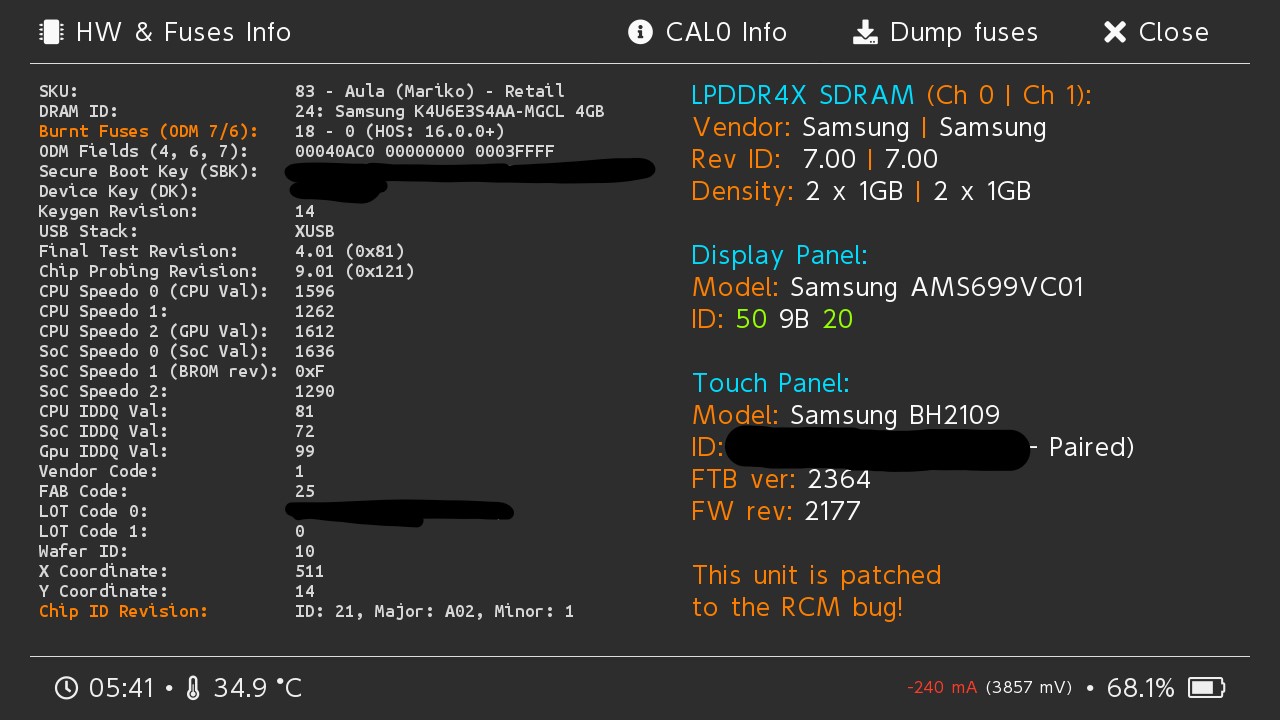

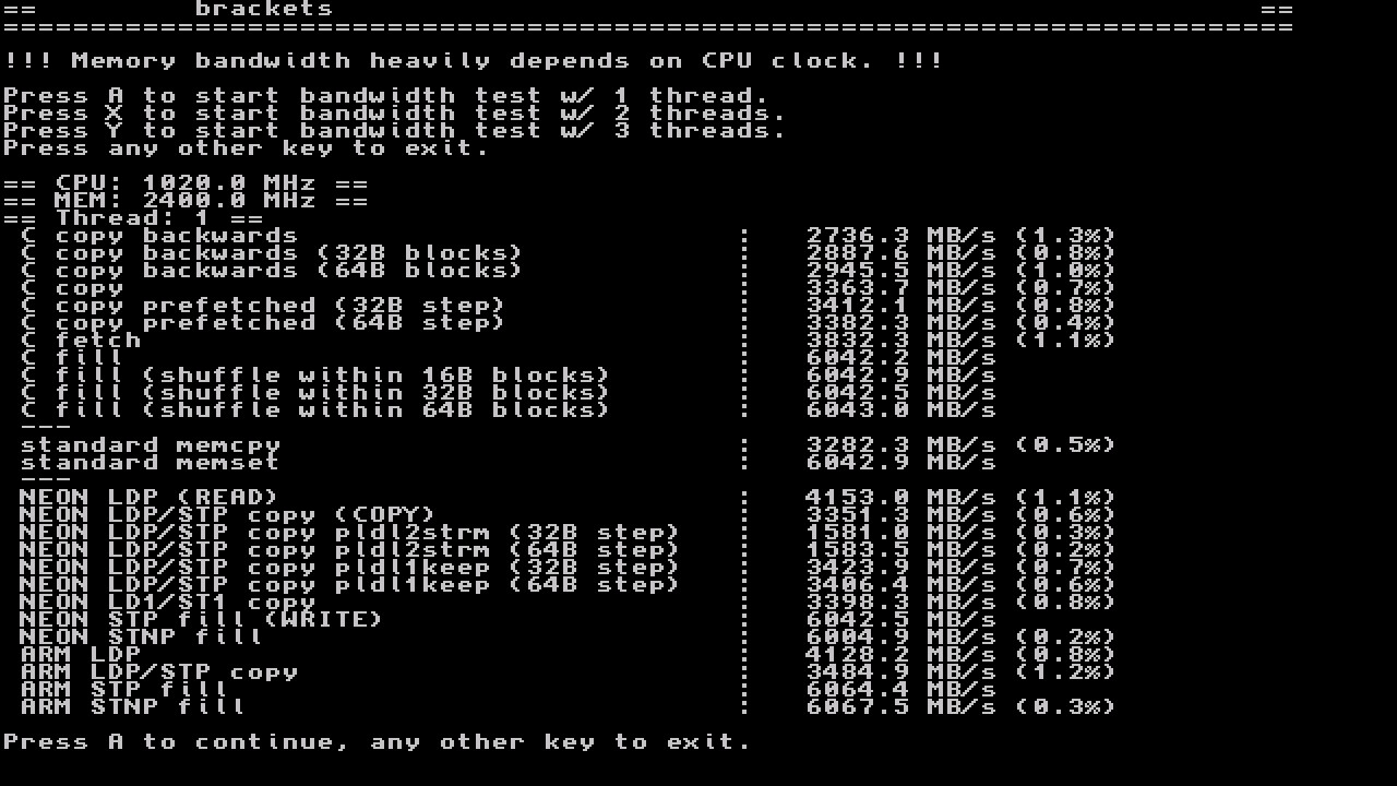

First of all: Huge thanks for this utlity. I love tinkering with clocks, timings etc. on my PC as well :D
I wanted to share my findings using this utility the last couple of days. Please keep in mind that I have not the greatest understandings of RAM timings nor do I think myself of some kind of expert. Before I start here are some infos regarding my switch unit:
Switch Oled (picofly mod) with Samsung MGCL RAM. For more details take a look at the HardwareInfo picture.
I started with the suggested RAM timings for Samsung MGCL values found in the github discussion section , which unfortunetly didn't work out for my unit. I lowered the Timing values each by one and tested again and it was stable. To do that I used the provided memtester to stress test the new values - after looping the stress test 11 times I decided it was stable. After that I played OctoPath 2, which did not crash with the new values after hours of gameplay.
So here is my adjusted config: Samsung MGCL : DRAM Timing: 1 Vdd2 1150mV, vddq 625mv, 2400Mhz: 4-2-3-3-4-3-4 - can also be found on github discussion.
To check what the results are I used the tinymembench tool in applet mode and did the bandwidth test with 1 thread. CPU clock at 1020 Mhz and RAM at 2400 Mhz. The results are generally higher transfer speeds and maybe more importantly lesser deviation. Pictures below show the results. 2400default is 2400 Mhz with autodajusted timings, the other two are with the tweaked timings. Two so it is at least somewhat comparable.
Btw if anyone knows of a better way to test using the memtool please let me know.
I'm currently playing OctoPath 2 and couldn't see any noticable improvment but I haven't really put the system to work. I will test with 60fps and higher settings the next few days to see how much of an imporvement it can provide while under heavy load.
I hope this can provide some helpful information on the topic.
