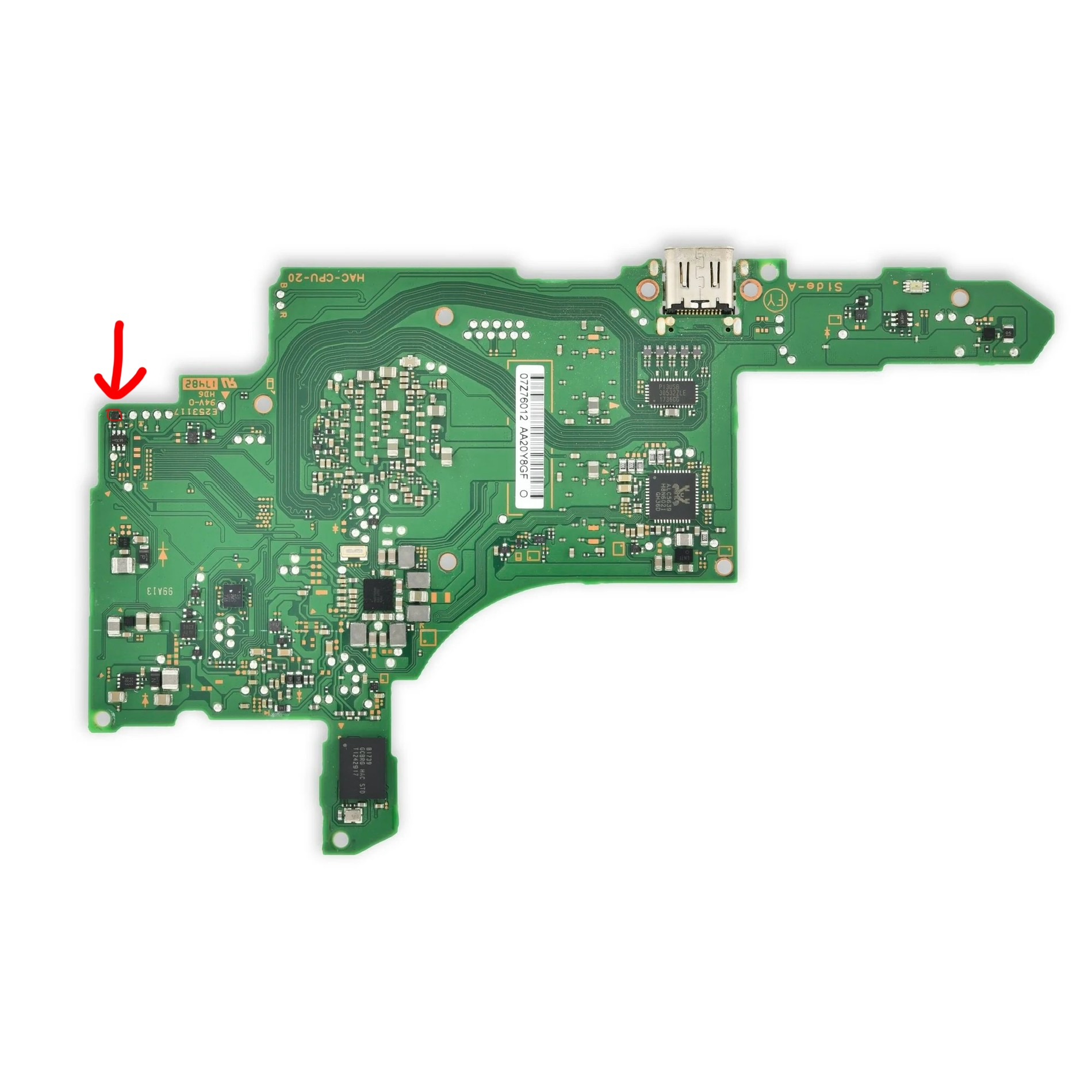

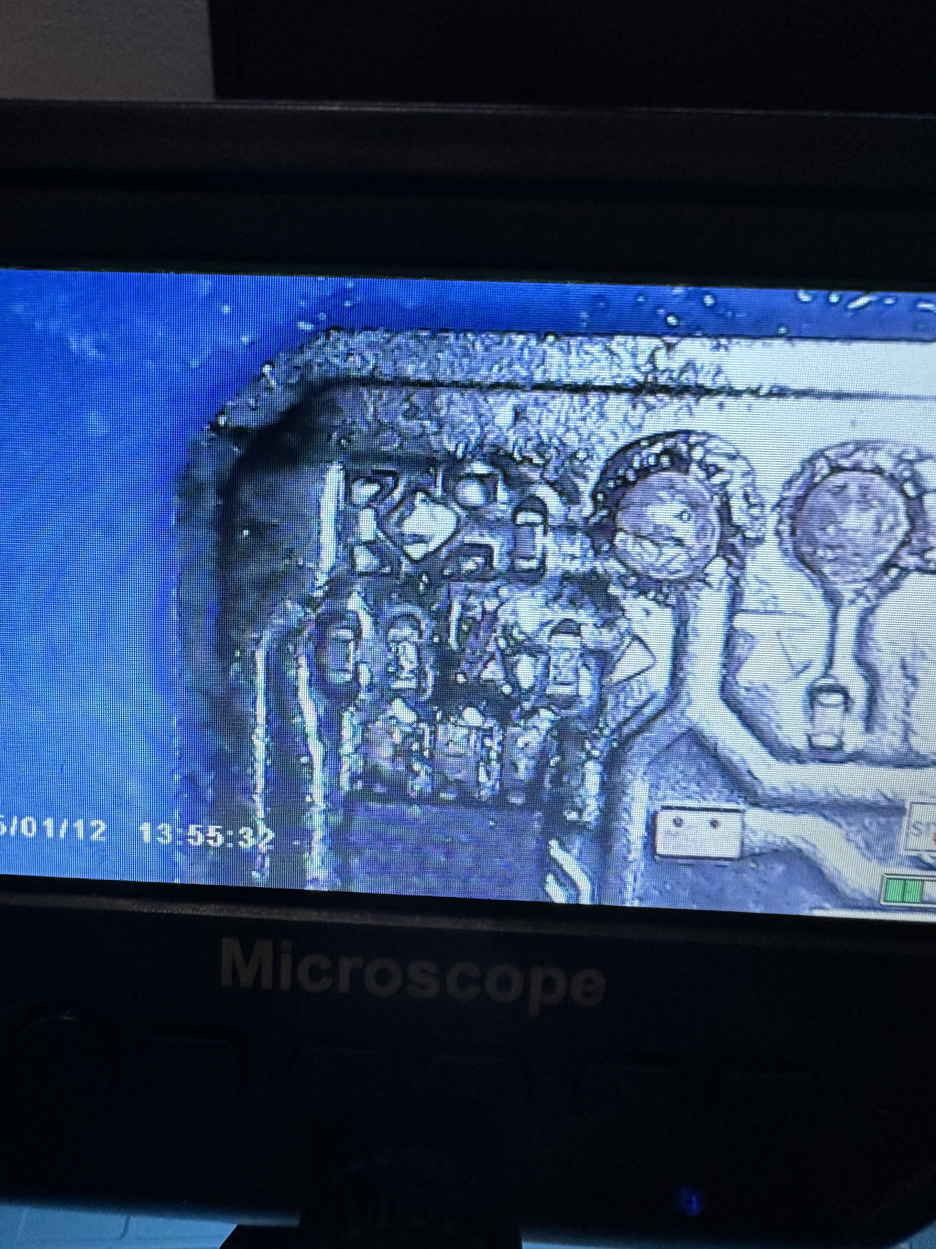

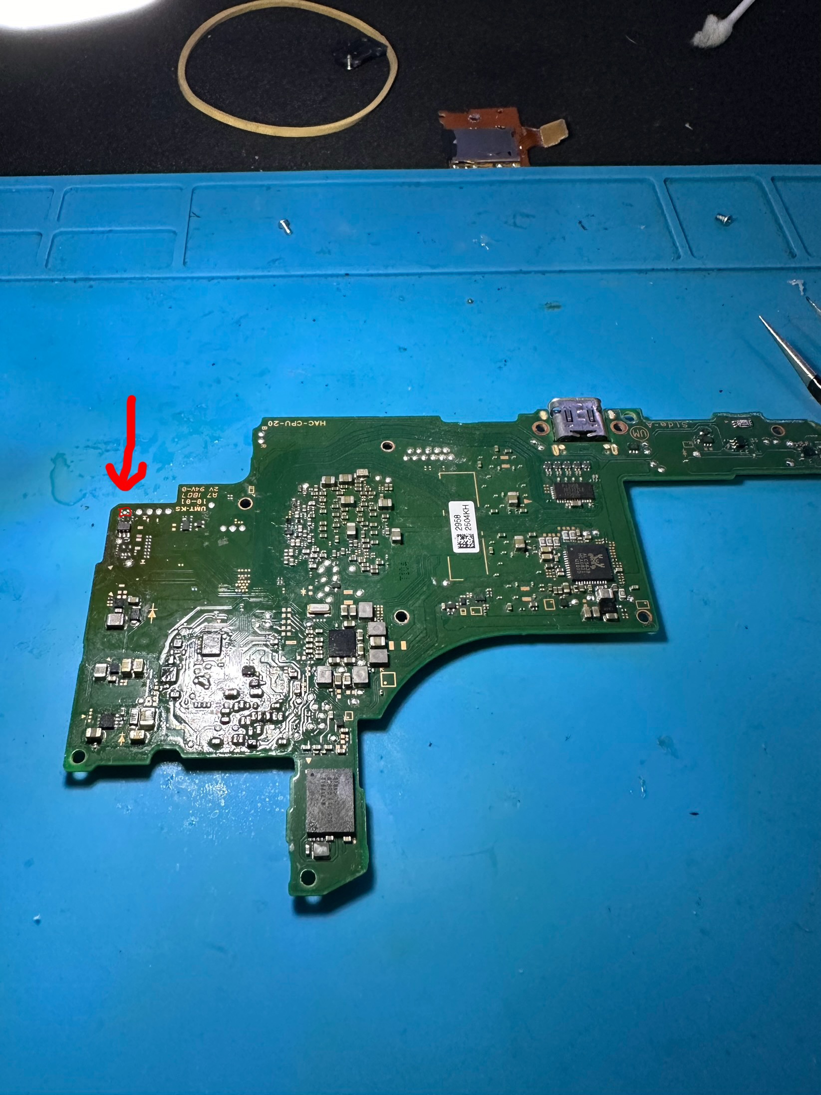

Hello,
I accidentally blew out this small black component just right there but I don’t know where It is now.
I was wondering If someone is able to identify It and give me the reference please.
(Nintendo Switch V1)

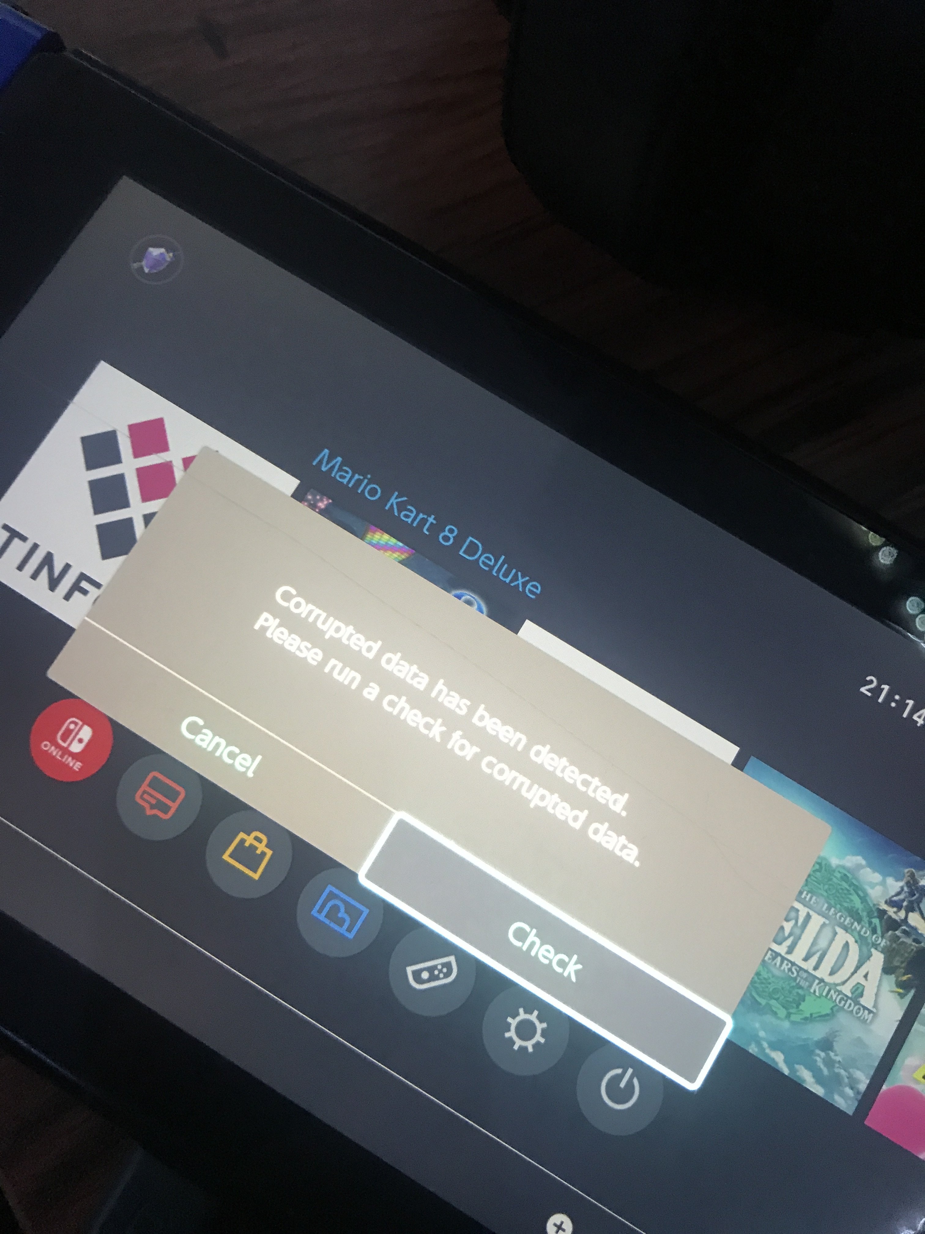

Hi im having problems with some games on tinfoil it keeps saying corrupted data detected for my smash bros. I have the latest sigpatches (i think) and my ams version is 1.7.0
Also i tried to get mario kart 8 and smash again and it says completed but nothing is there on the home menu or tinfoil
Someone please help me out 🙏🙏
Edit: forgot to also say it said when I downloaded the game failed register placeholder nca?
Another edit: this just happened help sometimes hate this thing
Is your SD card legit and working properly? If you're not sure, check with h2testw and see if there are any errors. Note that during testing, you will lose your SD card's contents.
If you're sure that it's not an SD card issue, check if there's enough free space on your SD card. Otherwise, I'd update or reinstall Tinfoil and try again. Or, even better, try another installer like DBI. Here's a decent video tutorial on its usage.
