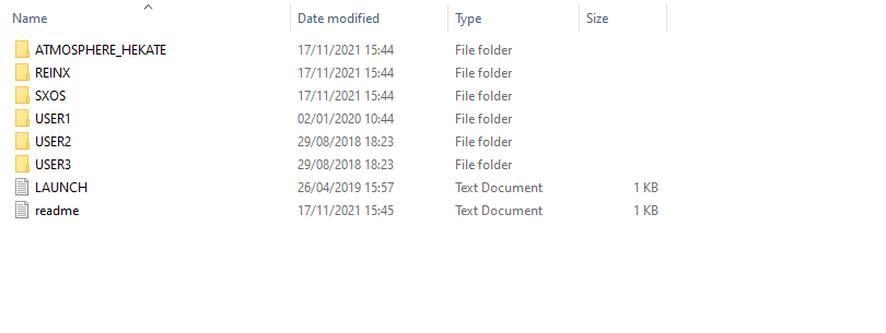

Hello,
I just received an RCMloader. I know I need to update it with the latest version of hekate (the one I've been using with Tegra RCM). Should I copy it to one of these folders already on the RCMloader or delete everything and then put it in?

Hello,
If it‘s one of the “new V5” RCM loaders, check the size of the partition. If it is ~700k it is a stripped down revision that doesn’t have all the features of the original and cannot be modified. This includes trying to update firmware, which will brick you loader. Investigation is under way but so far nobody has been able to modify these. The best way to get these to work is to chainload Hekate and allow it to update to latest version stored on your SDCard.
TheJinKazama
Nov 20, 2011
130
464
Are you averse to using a Trinket M0 in your Erista?
Trinket M0 Hardware — The @mattytrog Bible for installing the Trinket M0
Trinket M0 Software — The @mattytrog encyclopedia of Trinket M0 software (source here https://github.com/mattytrog/FUSEE_SUITE)
Thanks for your reply. I ordered this from AliExpress after deliberately checking for positive reviews but when I opened the Properties in Windows, it does appear to have a capacity similar to what you're referring to.
Could you help me understand how to chainload Hekate and allow it to update to the latest version from the SDCard? Thank you.
