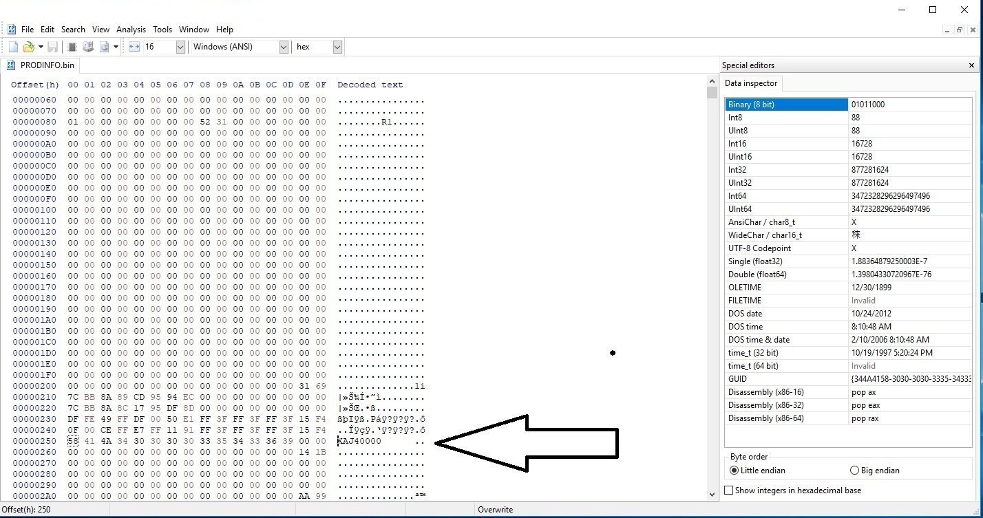

Run Lockpick_RCM obtain bys keys
https://github.com/shchmue/Lockpick_RCM/releases
Use this guide only for HacDiskMount
https://gbatemp.net/threads/how-to-...nofficially-without-burning-any-fuses.507461/
Mount your nand backup with https://files.sshnuke.net/HacDiskMount1055.zip
Decrypt and save prodinfo.
Then open the prodinfo with https://mh-nexus.de/en/downloads.php?product=HxD20
Look for your serial number.
Compare the serial number with the one on the tablet.

If you already have biskeys obtianed in the past just compare with the new one obtained after you recived back
This will not help you repair the hardware problem.

BIS keys and Serial is the same as before i shipped it, so the motherboard has not been maliciously swapped.
