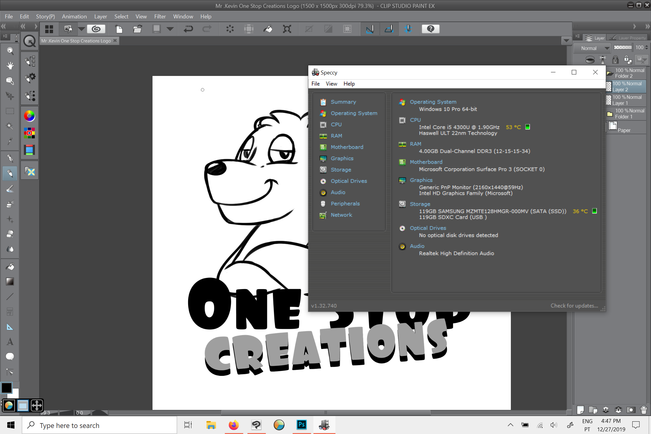

What are the reported temps?
You can use an app like Speccy to find out.
Sorry about the cartoons in the back lol im working.
Anyways, please see attached picture of Speccy.

53C at medium loads sounds about right so it won’t be the temp sensor misreporting. This makes me think that either the fan curves are a little too aggressive (e.g. set to blow 100% at 45 maybe) or something is bypassing the fan curve to send full voltage to the fans.
Unfortunately I don’t know any troubleshooting steps for this. You may want to raise a support ticket with Microsoft and see what advise they can give.
