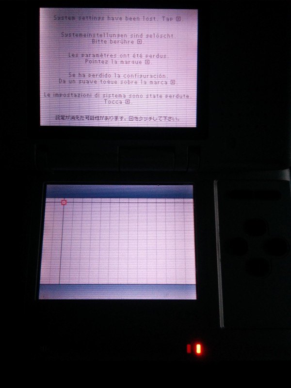

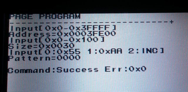

Hi everybody,
I have a question and suggestion for the Firmware Editor: is it possible to clear user settings from the firmware dump?
Sure, just blank the firmware in the 3FE00-3FE30 and 3FF00-3FF30 (for example) ranges; this will make the checksums fail
(plus 3 other blocks for wifi networks)
If you have access to the factory rom (NTRAging, NTR-EVA, NTR_TESTER_NTRJ00.nds), you can do this directly on the console:
start the app while holding Start, select Misc > Test Nvram > Page program > then do as in the picture (twice, over both ranges I recommend):
The one in the video you mentioned (perfectly fine to link to) is actually the "short" setup you get after removing the battery, not the one you get on a unconfigured system!
