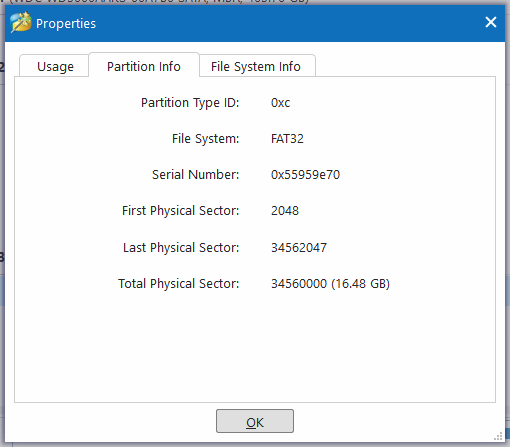

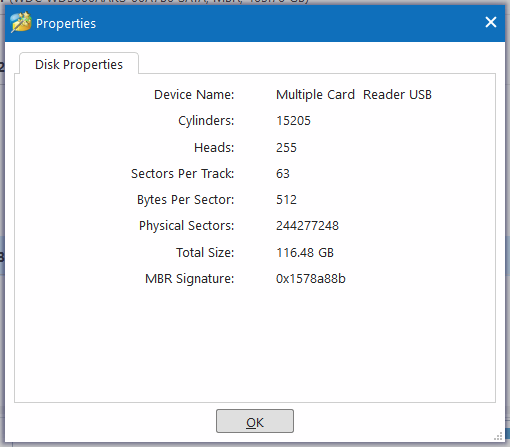

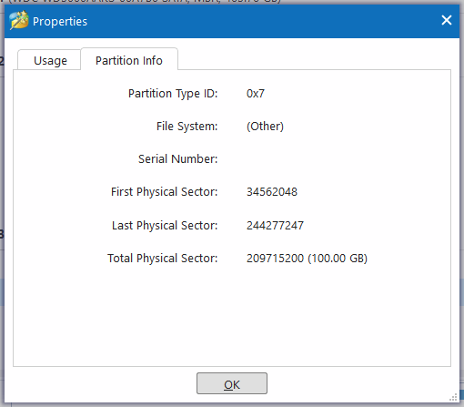

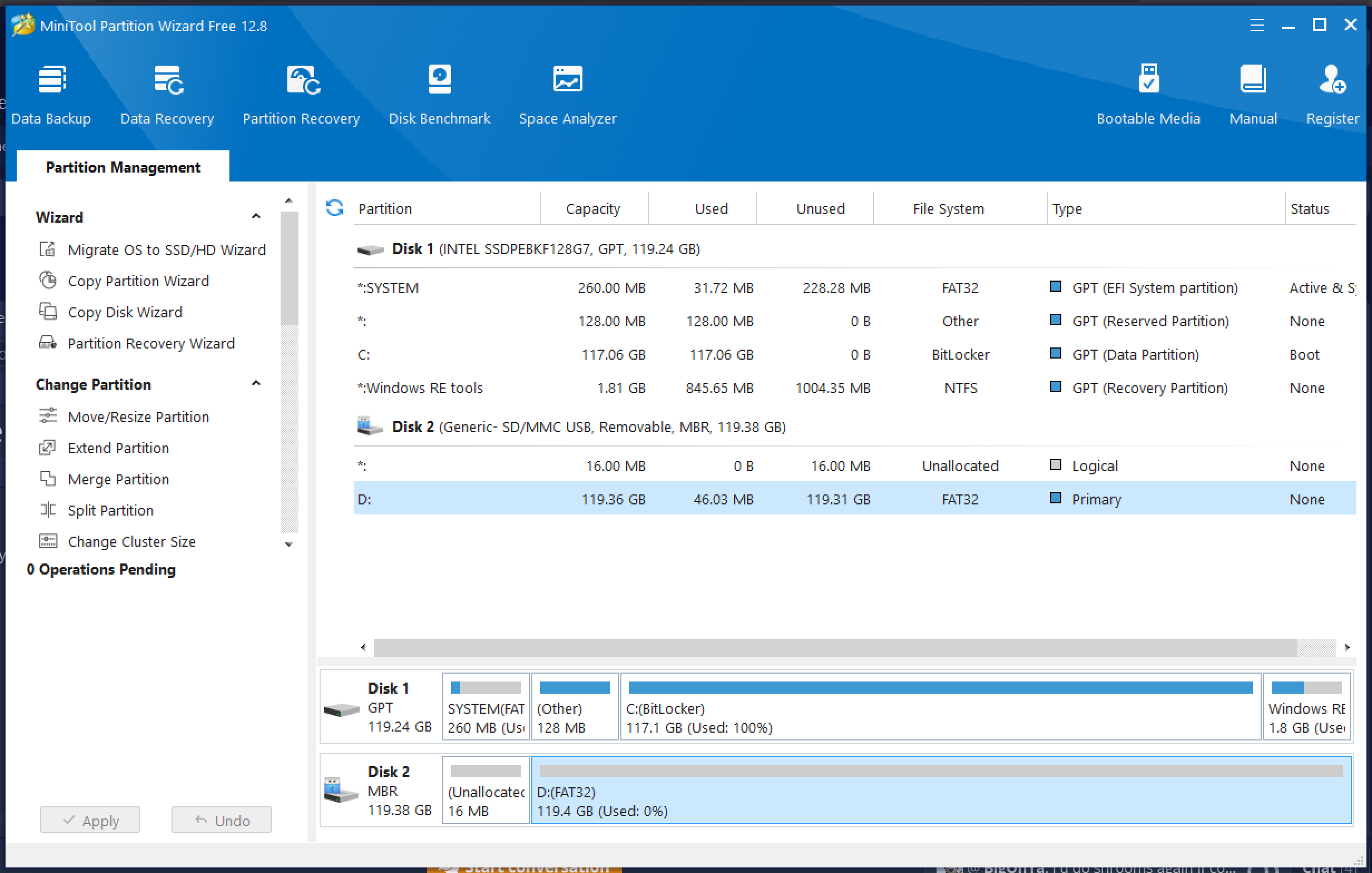

It's also possible that the SD card is just incompatible. I have two old samsung cards that can't run Wii VC, even if I have them as MLC, without any patches.
The one I'm using right now is the ADATA Premier 128GB microSDXC card, not sure if it's the issue with it? I've tested it with h2testw before formatting and adding stuff to it and it returned no errors. I'll definitely pick up the Endurance one later down the road after I do some testing with this one, see if it fits my needs. If I can get VC titles to work, that would be awesome.
What is the start lba of that partition?
I'm not sure how to check that, but here's the partition info from MiniTool. I hope that's enough?
That should be fine. To make sure I checked with what is HAI is using on my console. The address base for the nfs extends is 19 in my case. It's possible for that to change but I only ever saw 19. so 2^19 = 524288 (512KiB), so the MiB alignment which todays partition manager usually do should be enough for HAI to work. Since one sector is 512Byte on an SD that would mean the alignment needs to be on 1024 sectors. The start address of your partition is 34562048 is divisible by 1024, so your alignment should be fine for HAI.
I only have the 64MiB aligment there because I saw that new cards had their first partition 64MiB aligned, so I just put it there in case that is more optimal for the card. Maybe I should remove that note, as it seems to cause more confusion
