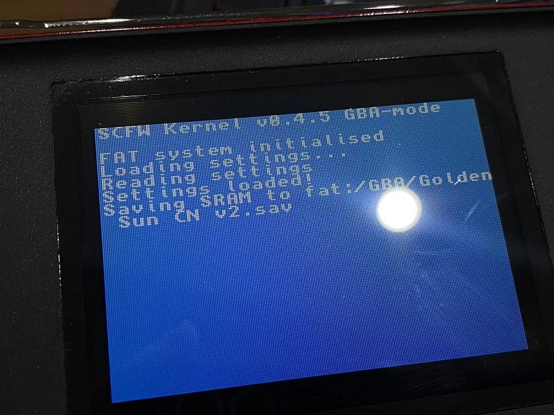

It's me again. I didn't realize there was a new version so I decided to update to the 0.5.1 release and at some point some games got their savefiles deleted. Specifically Zoids Legacy and Medabots Metabee version (didn't really bother to check other games after the incident with Advance Wars 2 so those were the only games I've been using with your custom kernel).
I think Metabee got corrupted because even when it doesn't have a savefile it says something like "saving will overwrite previous savefile". I thought this happened because I updated the kernel (I'm just running it inside the cart, didn't flash it into it) but then I realized Baldur's Gate was fine.
Did I do something wrong? I just don't understand what happened here or why.
metroid maniac
An idiot with an opinion
May 16, 2009
2,088
2,636
Have you been playing games using both the official firmware and SCFW?
It might be that the official kernel loaded a save file without SCFW knowing about it, causing the wrong save to be written later.
