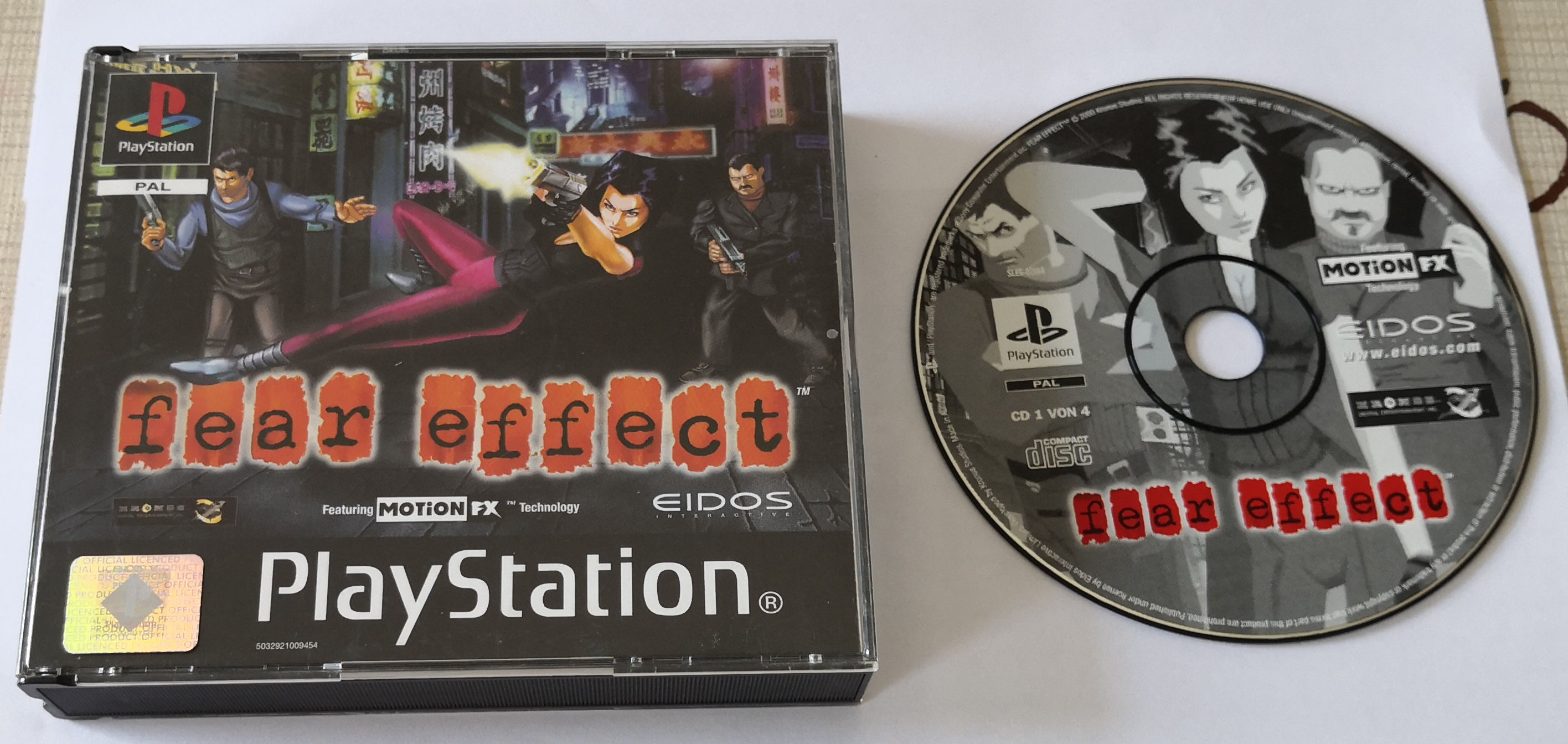

You could try loading a game from CD-R (and or the Japanese disc) by unlocking the drive with FreePSXBoot. If you can play Fear Effect for an hour the drive is probably okay – it tends to stutter on weak drives
For testing purposes you should have some legit game discs at hand. Preferably some Fifa or other sports game shovelware you can get for pennies and you don't care for if they scratch up in testing (or PS2 consoles ruining them with the ribbon cable).
