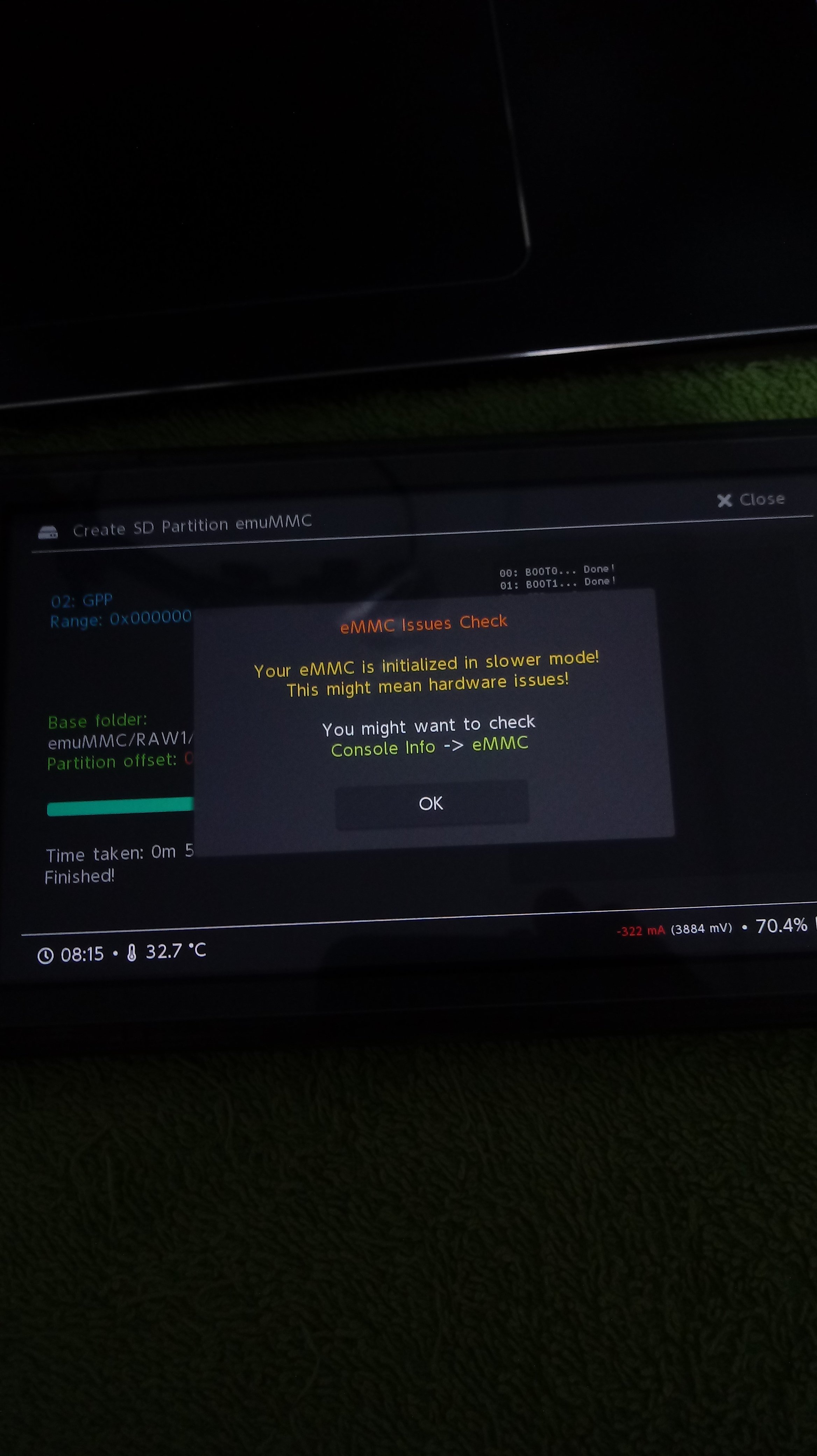

Partitioning went smoothly but the good news stop here. Next, I created "SD Partition emuMMC", which finished successfully but popped up a warning after completing the process letting me know my eMMC is initialized in slower mode.

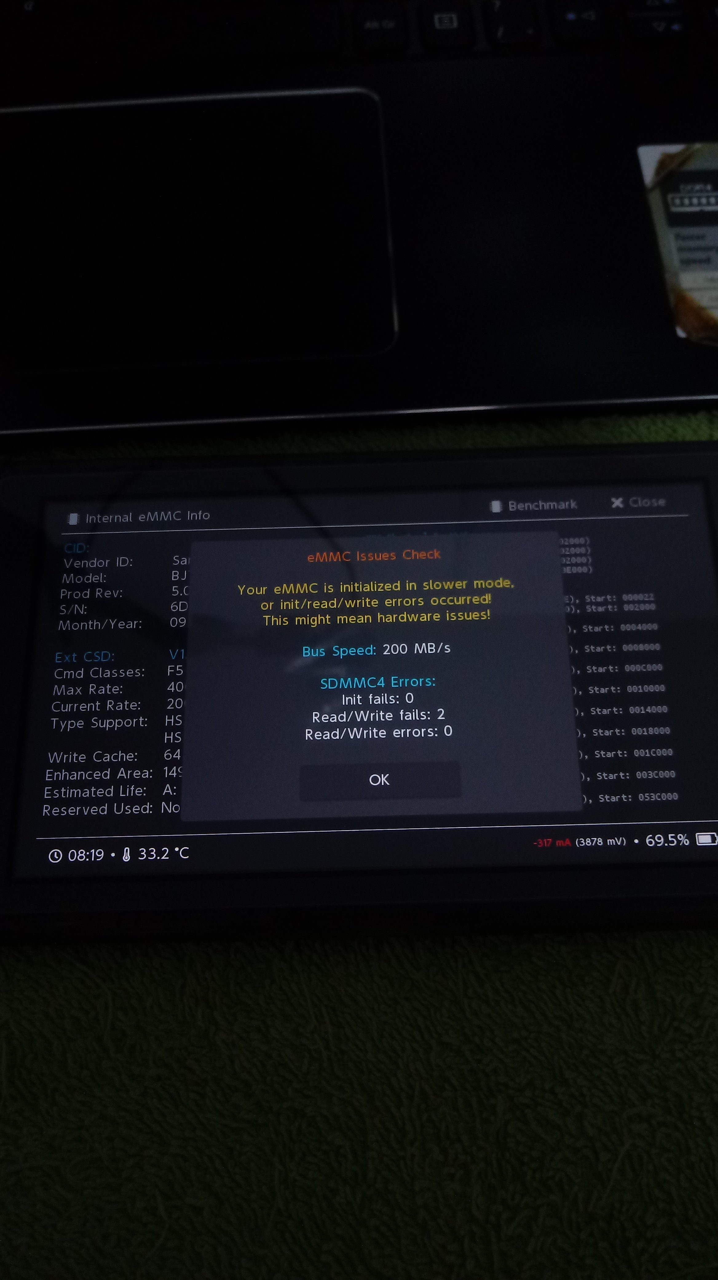

This is my second microSD card I'm attempting this with. It was the same deal with the first one, which was a 256GB one. Anyway, I did as it suggested and went to Console info > eMMC to show you what it has to say about it:

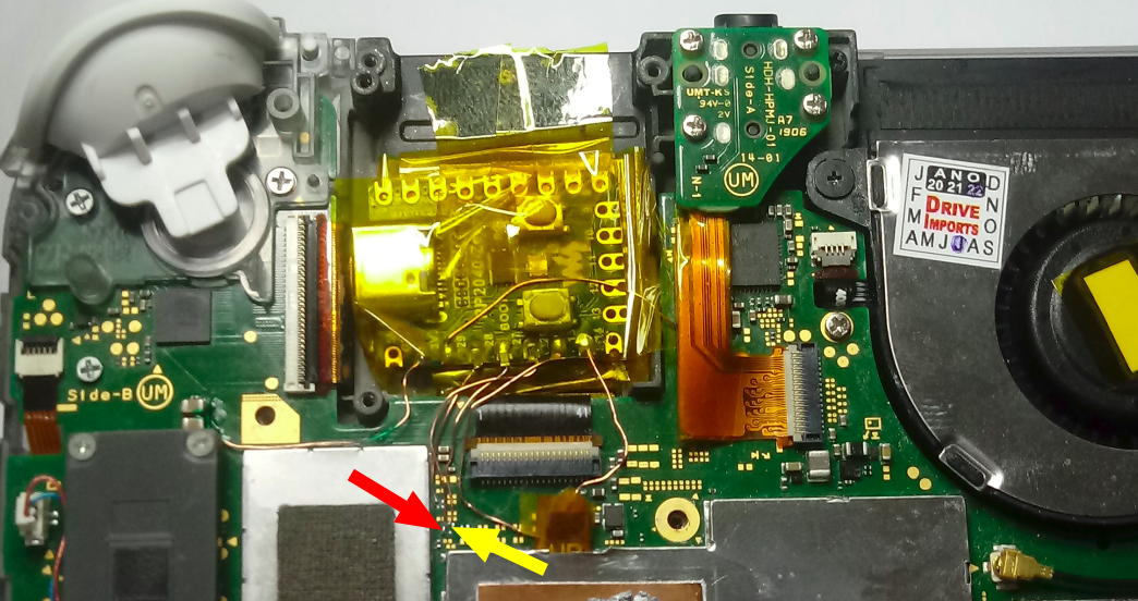

Yes, I have. It was about the cables I soldered. Look at the pic. Somehow the end of these two (CMD & CLK) were touching; As soon as I got that fixed, I then managed to get to write data and the "your emmc is initialized in slower mode" error message was no more.
Here's how it was before:
And for those who're wondering, Yes, I did cut off the cable coming from the cartridge slot and kept the portion of the headphone jack, it works normally. I installed the Picofly board onto the cartridge's spot because I wanted to #1) keep the USB-C port, #2) hunting for cartridges on the switch is a complete waste of time and #3) I also wanted to keep the "heat spreader" making contact with the heatsink. At the end of the day it's a low-end NVIDIA product, and those love to go hot so let's not give it any reason for that to happen.

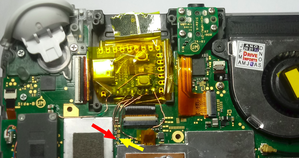

Here's how it was before: View attachment 384518
emmm hate to brake it too you
the metal plating shielding doesnt any heat dissipation, its just an efi shield
also if you wanted better thermals you would remove the copper sticker and have the heatsink directly on the cpu die.
also the mariko chip in the lite/v2 oled runs much cooler than the stock v1 switch in comparison .
and you could either just cut the metal shielding with scissors to fit the pico or at least installed the picofly rotated to access the usb c port via the cartridge slot
