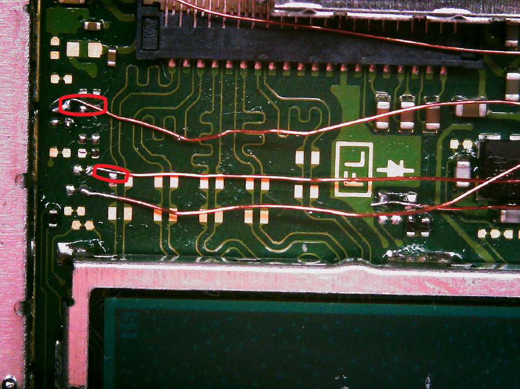

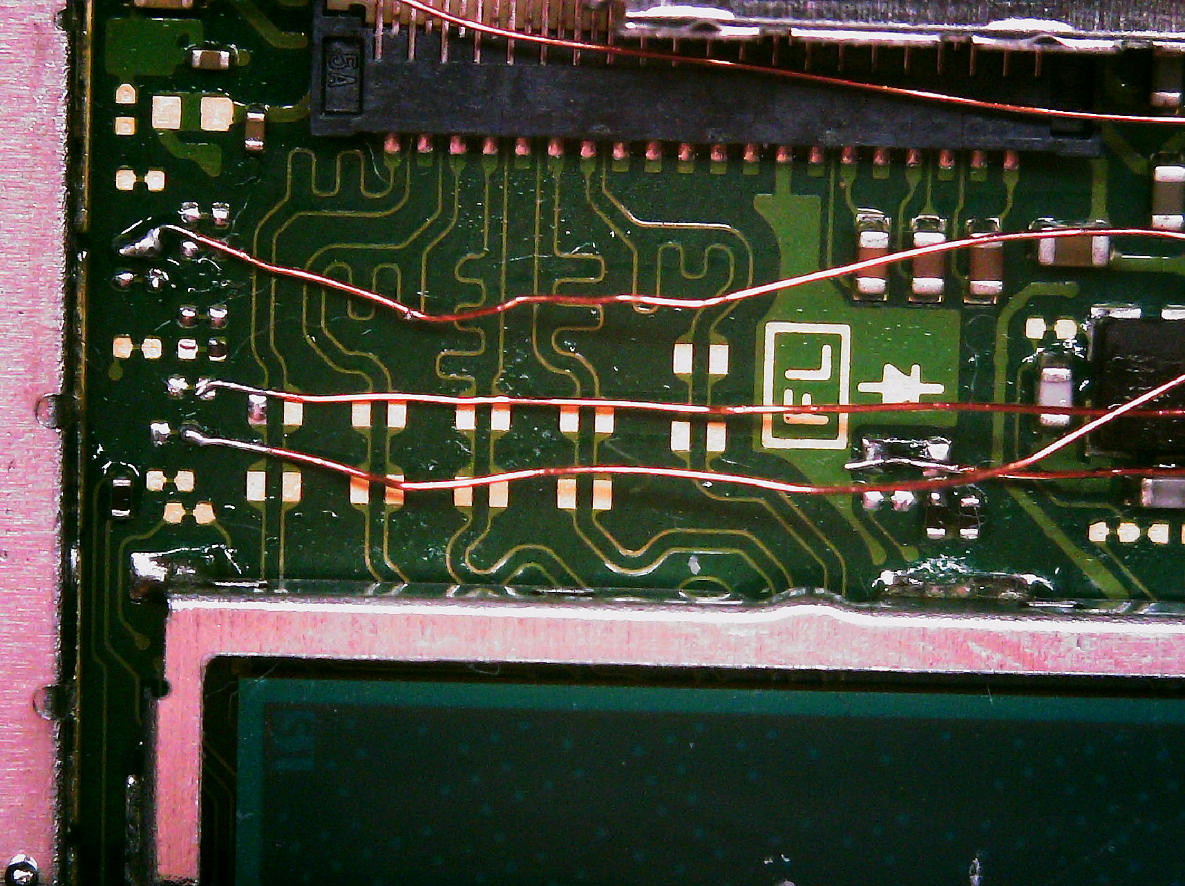

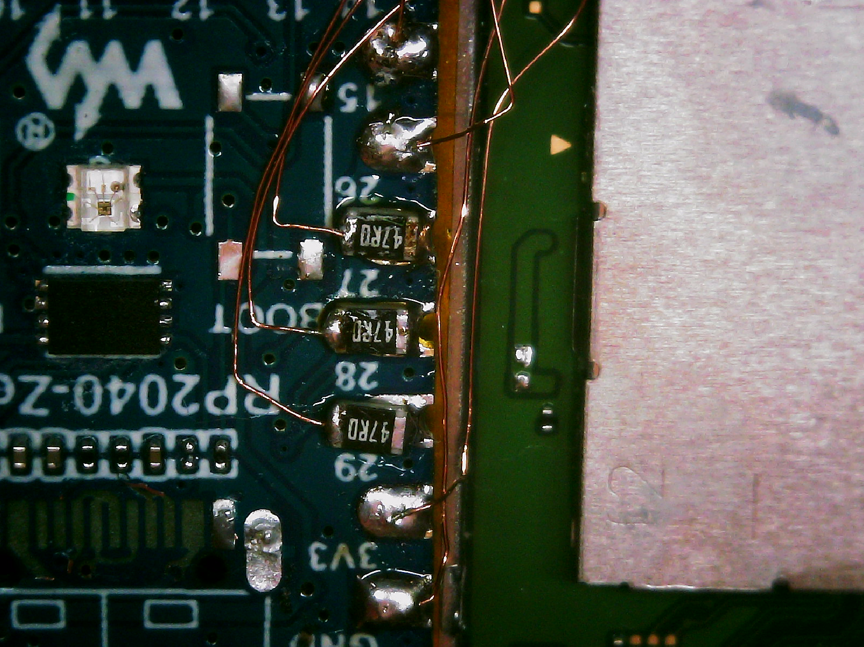

I attempted to install the Picofly w/hwfly v2 cable on my Switch Lite last night and, although my solder points seemed okay, it won't boot. I get a blue light, white light, then a flashing blue (for a while), and finally red before turning off. What did I do wrong? Is there a way to test my soldering with a multimeter? Is there a Discord for getting help with this?
EDIT: I solved it! I moved my 47 Ohm resistors over so that they were hanging off and it made a better connection. They must've been bridging.
When I power it on, I get a blinking blue light for about a minute 10 seconds, then it blinks white, and continues to blink blue for another minute 20 before blinking red then turning off.

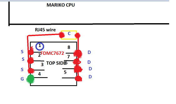

First time here, question, can i try to use FDMC7672 mosfet?
Is there any damage possibility if use wrong mosfet (i mean only the detailed spec which is lower or higher).
Also with this chip i can wired it like bellow attached image.

What are the diode reading that you're getting (red probe on GND)?
Those wires are pre-tinned too much, I see some possible shorts:
