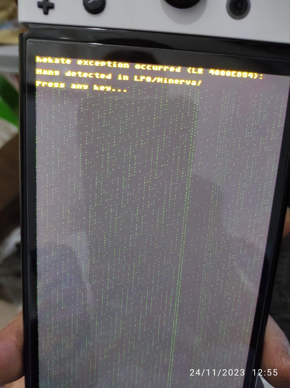

I had a problem I've never seen on this OLED. installation completed successfully, eMMC created, everything ok. the next day I turn it on and I have graphic artifacts and continuous freezes. by moving the wires a little it resumes but I have a Blue screen in the original and a yellow screen already created in the eMMC. I solve it with an unbrick level 1. what could be the cause?
The installation is perfect, I'm experienced enough to say, all the values were in the norm in fact the first day it worked perfectly. I also changed modchips no improvement. Now it works perfectly.
Had this a while ago (hwfly chip). Still don't know for sure what the cause was but maybe you could try and do as I did and hopefully it works for you too.
https://gbatemp.net/threads/help-weird-oled-issue-after-chip-installation.630850/
Reactions: LuigiGad
