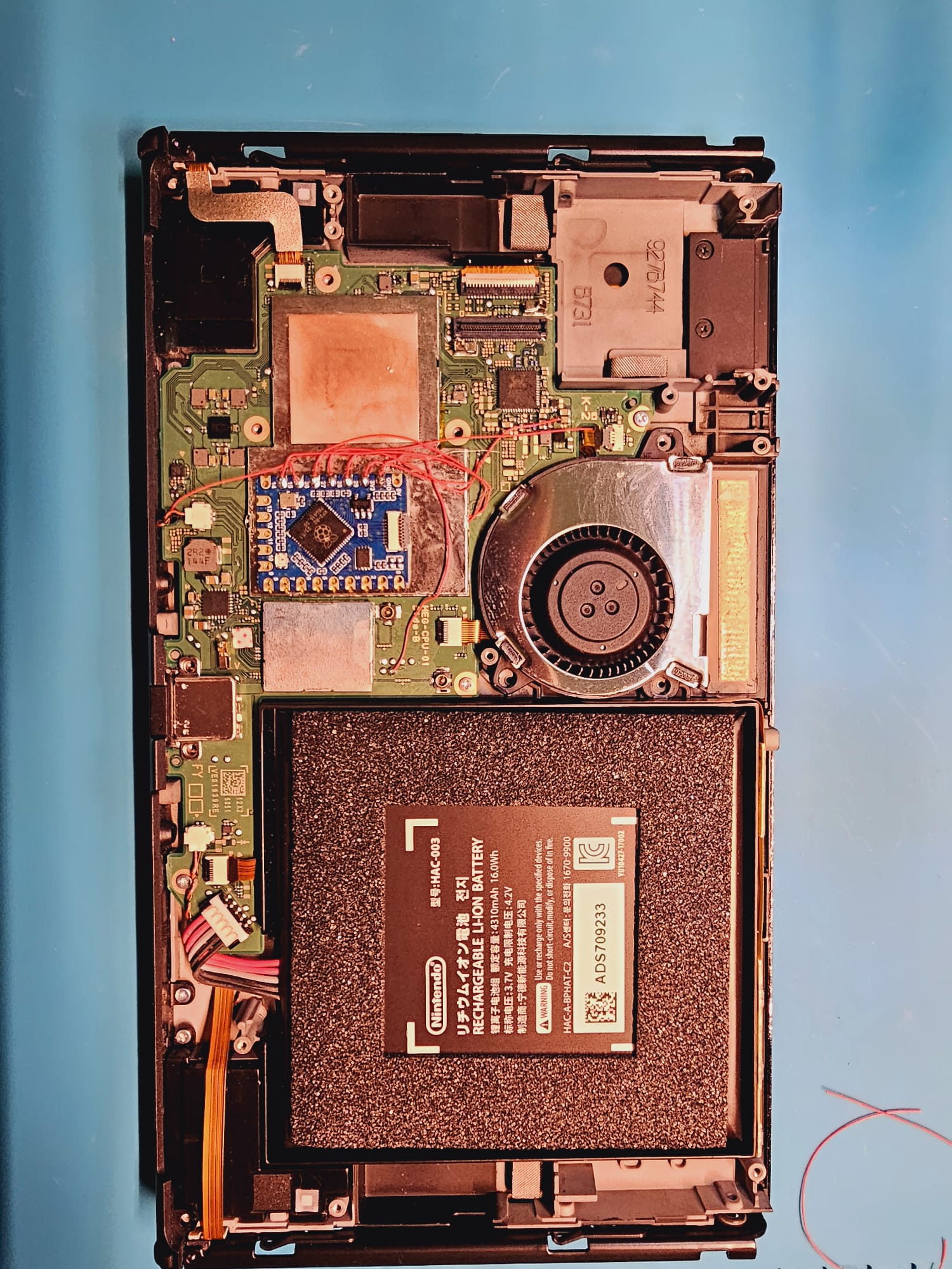

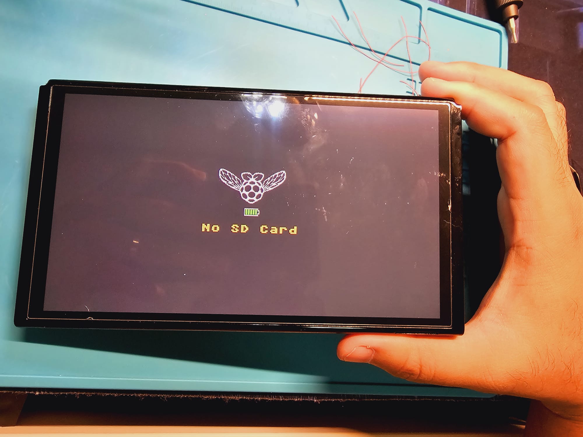

Successfully installed chip on an OLED switch. Couldn't have done it without you guys.
Chip is RP2040 Tiny running at 2.75 firmware.
