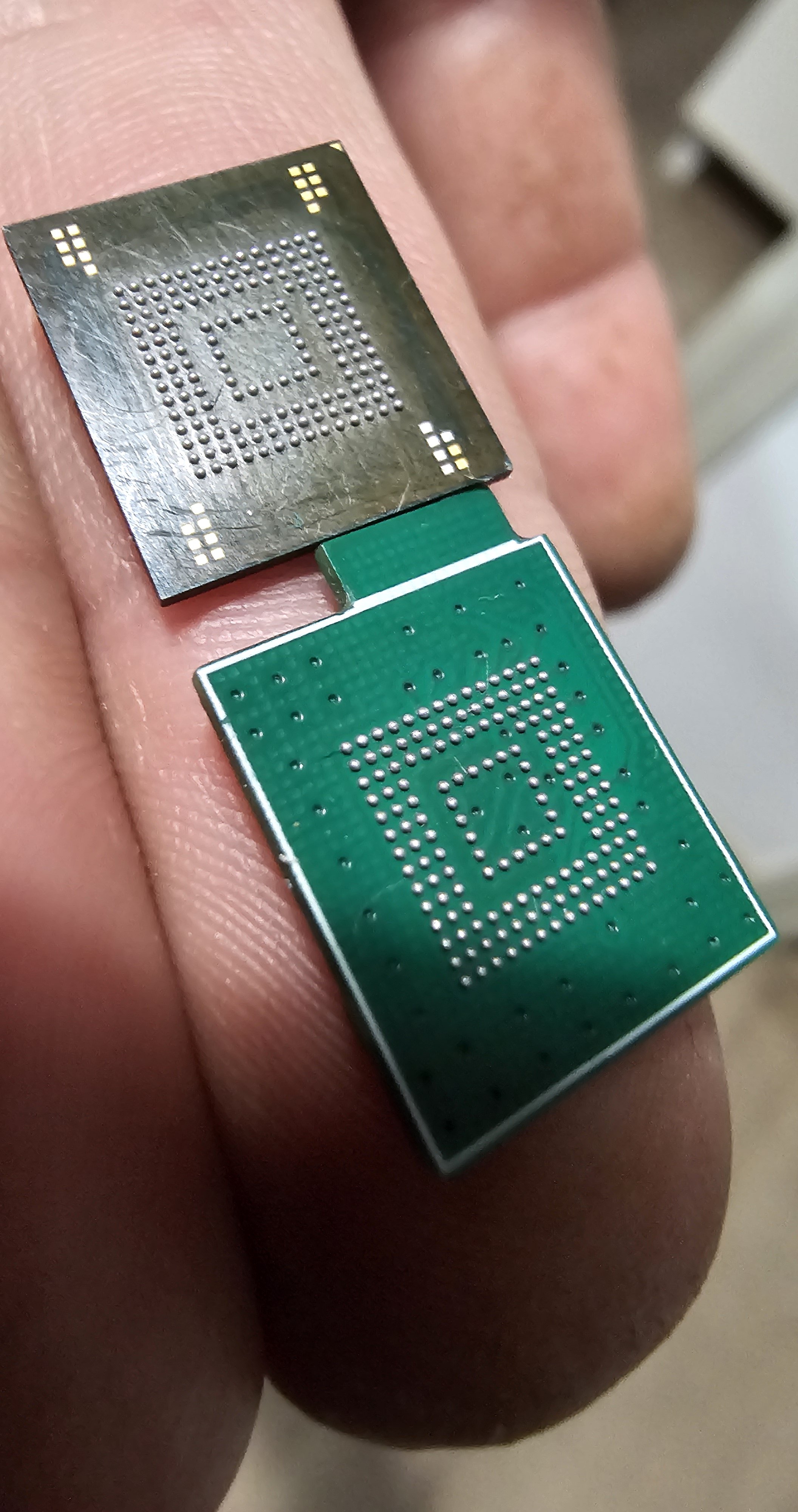

A friend sent these to me. I only tested the adapter on an old HWFLY modchip and its giving me conflicting results. I'm still waiting for my batch of rp2040 tiny to arrive tomorrow or after tomorrow to fully test on a fresh console.

I like the idea! You could use rp2040 tiny to eliminate those giant 0805 package resistors and you could use back mosfet locations to unnecessarily opening apu shield. This way everything can be on back side of the board and as a bonus you can decrease flex cables to one piece.
My friend everything was accounted for, it isn't just for show. Resistor pads are crucial part of the design to make it easy to solder resistors when required. The design is meant specifically for RP2040 Tiny as I teased it last month, but could also be used with Zero. In the case of Zero you can neatly add them here while the Tiny you can add the extra ones when required.
I thought of doing one flex holding everything but that would be a bad design as different thicknesses are required and people might want to use different type of modchips so having the adapter separate makes it useful for more people.
Feel free to do back mosfet. I will only finalize the current design I've made.

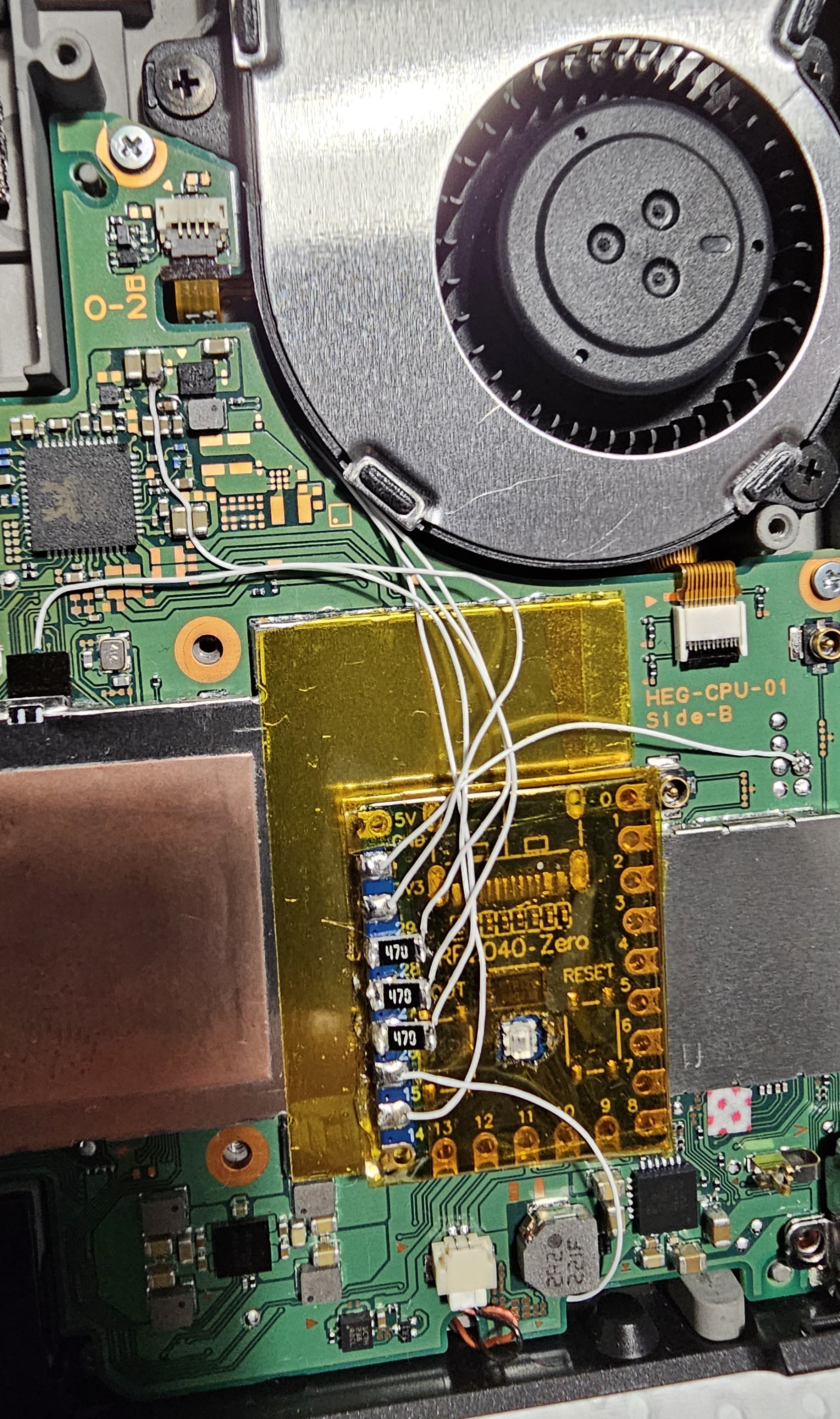

Most likely put some kapton ape on the chip for isolation. With the backplate it will be probably shorted.
I redid the kapton tape and now it functions even with back plate on (I still have like 5 screws of the metal shield removed because I got too lazy). So yeah, thanks for making me re-check the tape.
Now only problem with this is that SysMMC and OFW goes to a black screen and does not work, but that's... fine. EmuMMC works perfectly well.
Edit: I can now access SysMMC and OFW. My eMMC was SK Hynix and was known to not play well with the Flex cable. 30 minutes of Direct Soldering via Enameled Copper Wire later and Its working.

An error occurs when using rp2040 zero "*== No eMMC CMD1 request (poor wiring, or dead CPU)", OFW is loading. But if I solder the old hwfly, then everything works fine. I've tried different rp2040 zero, all works in other Nintendo Switch

So, I installed the flex on a brand new Switch and it glitches fine, not sure why its giving me messed up RGB.
Though I have several remarks,
1) Adapter needs to be below 0.1mm for comfortable installation for that I made a single layer adapter but will not be be compatible with the master flex. I will try to remake it at a later time.
2) There's too much stress on RST point, I feel the tension could tear it. Solution: bend it before you install, this way you relieve some stress, or better soldermask like I did.
3) CPU attachment needs to be longer to relieve stress on flex.
There will be a follow up revision that address these.

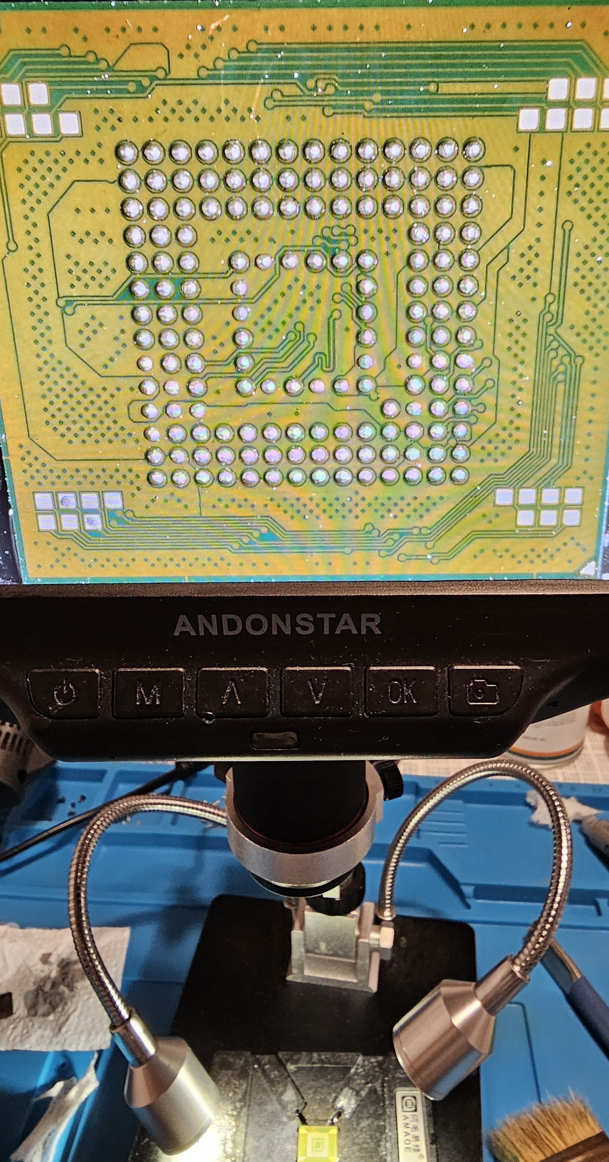

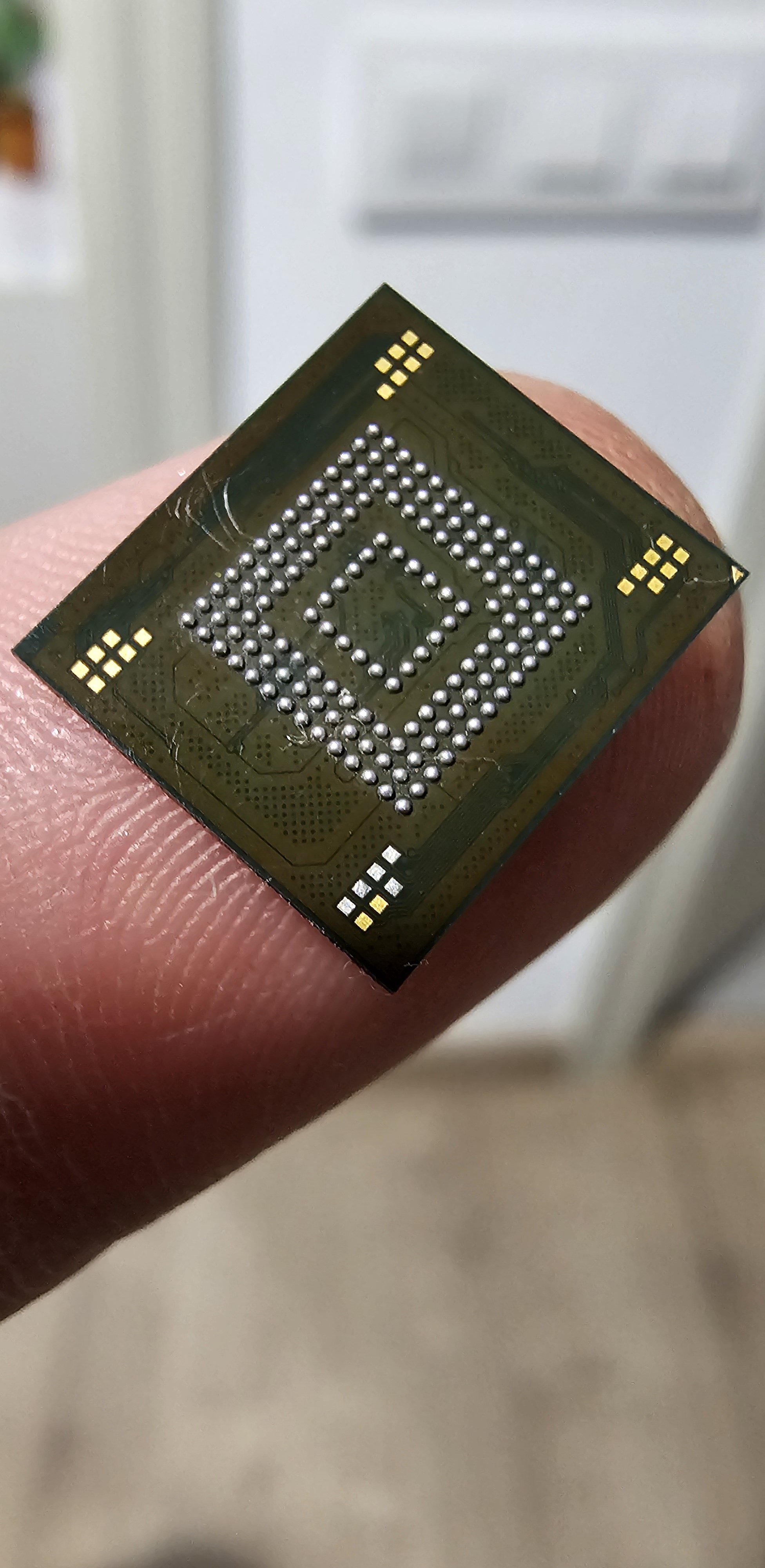

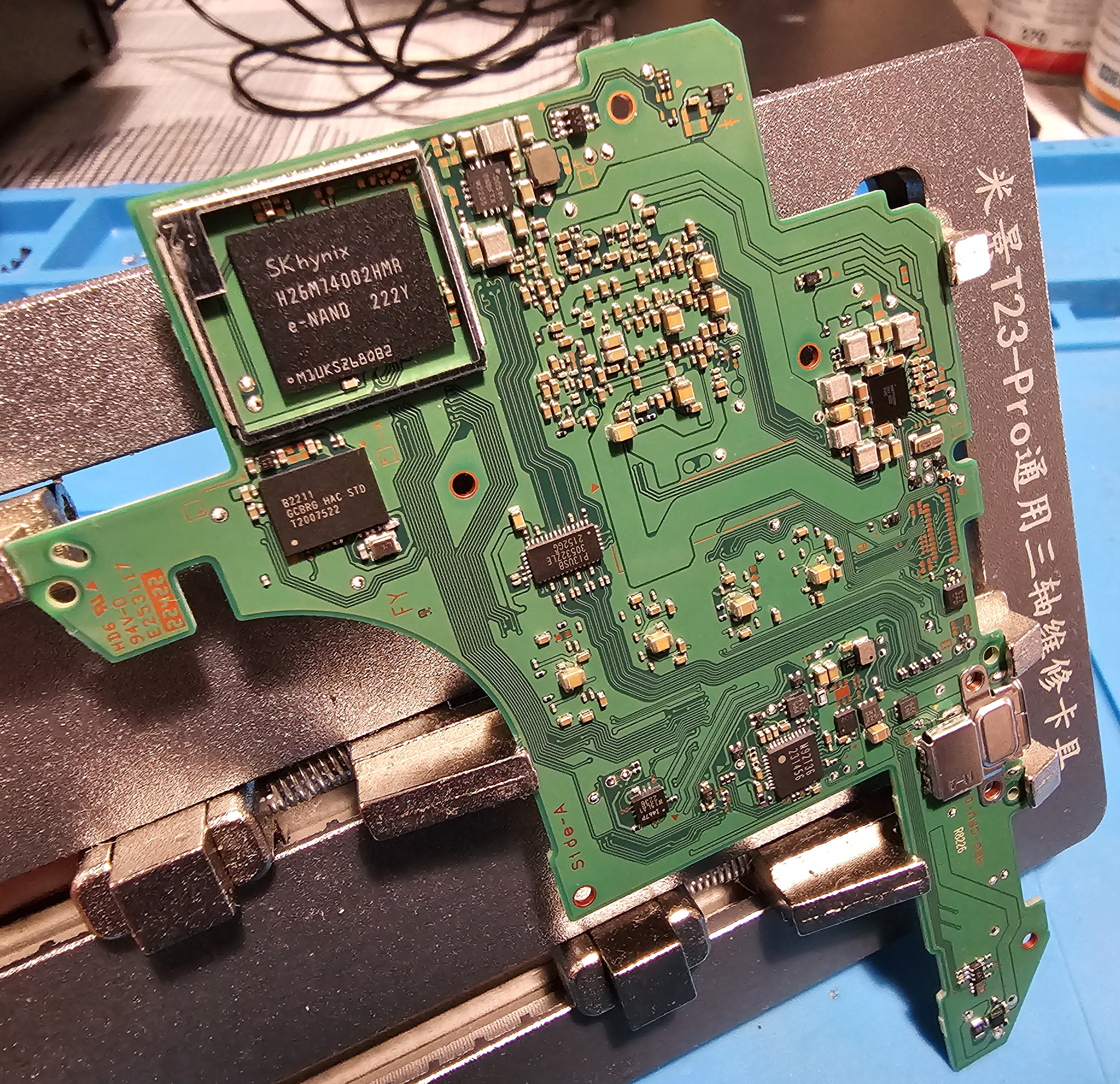

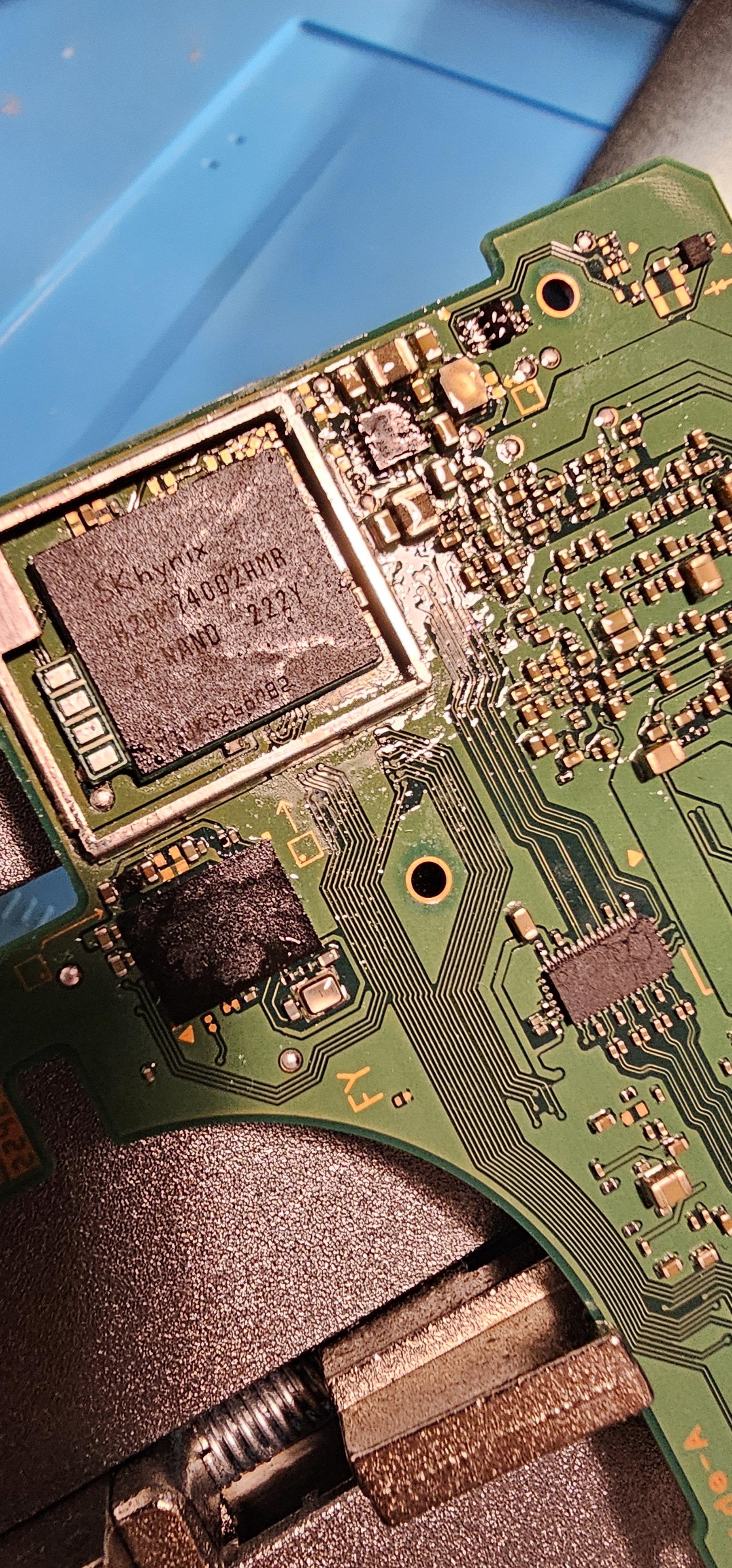

I'm doing adapter first, then emmc. Seems more logical, and it's a good idea to not expose the emmc to more heat than necessary. So the workflow is as follows:
- detach emmc from mainboard
- clean mainboard with solder wick
- clean emmc with solder wick
- reball emmc
- reball adapter (on the bottom side)
- attach adapter to mainboard
- attach emmc to adapter

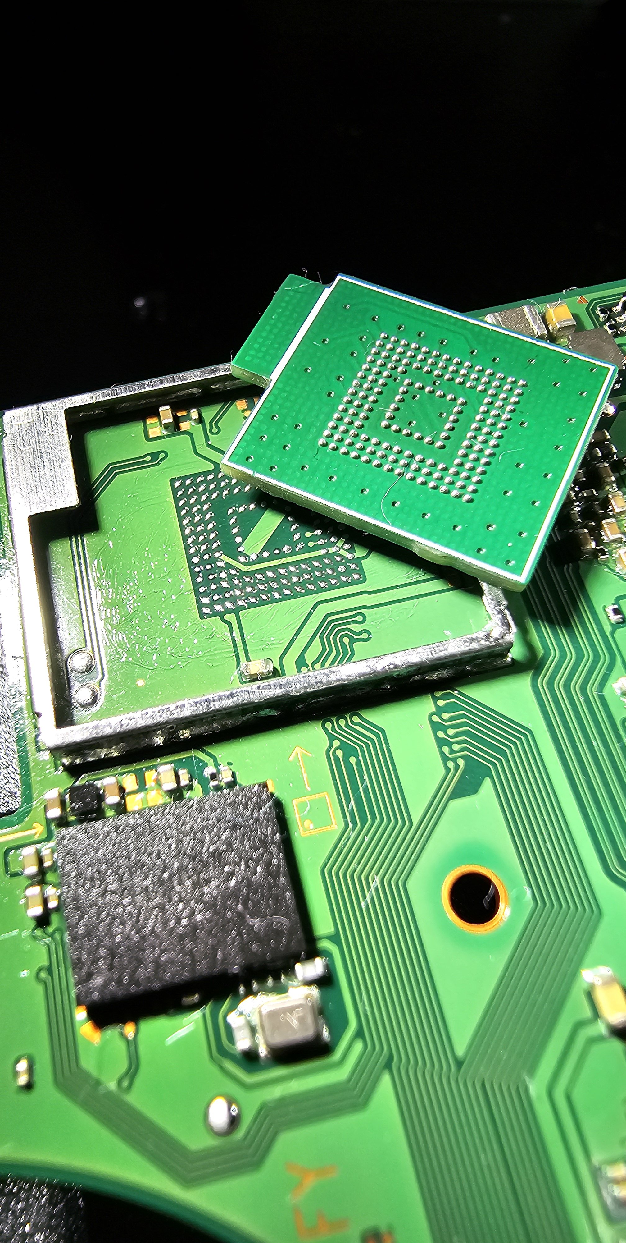

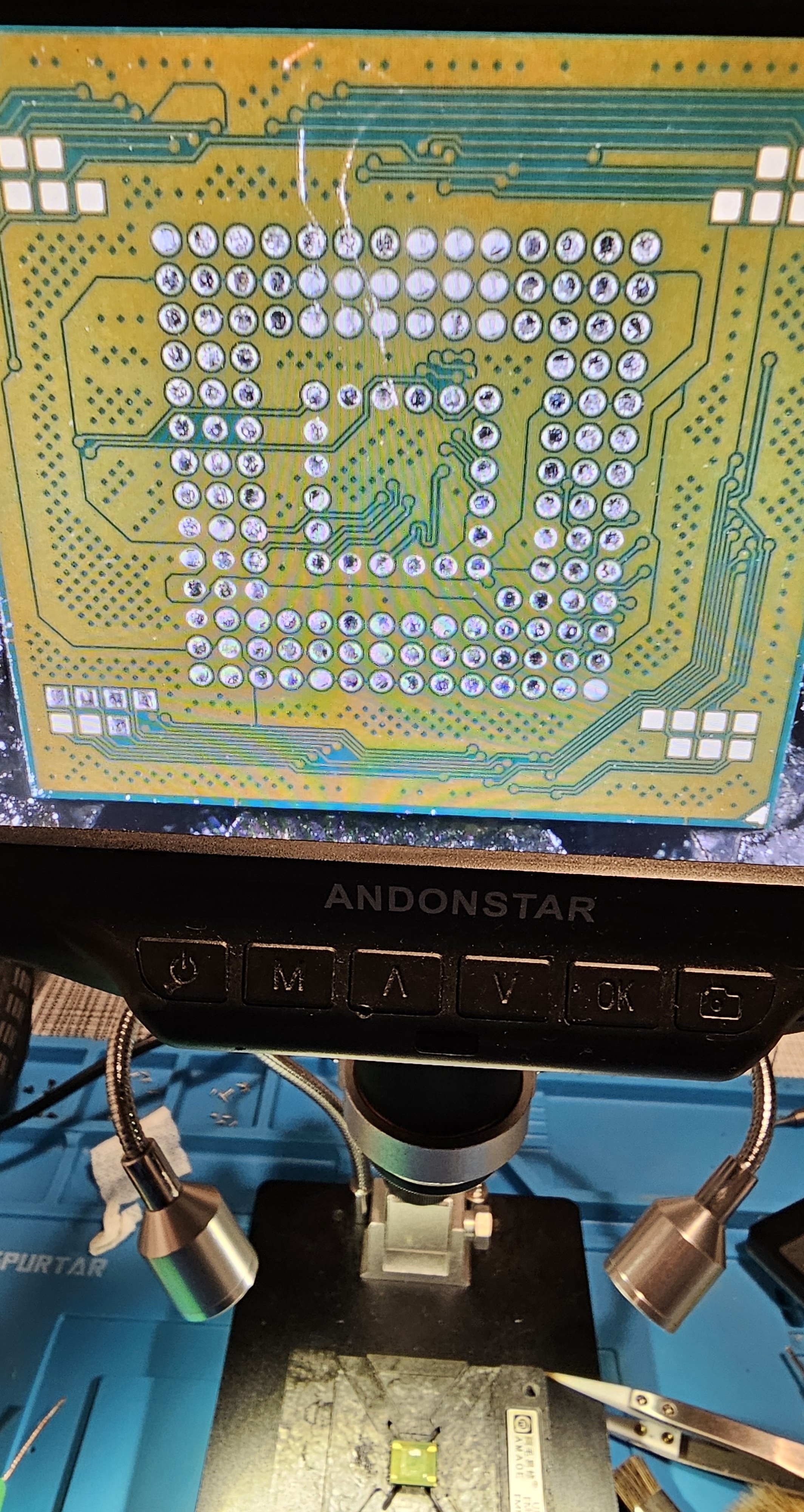

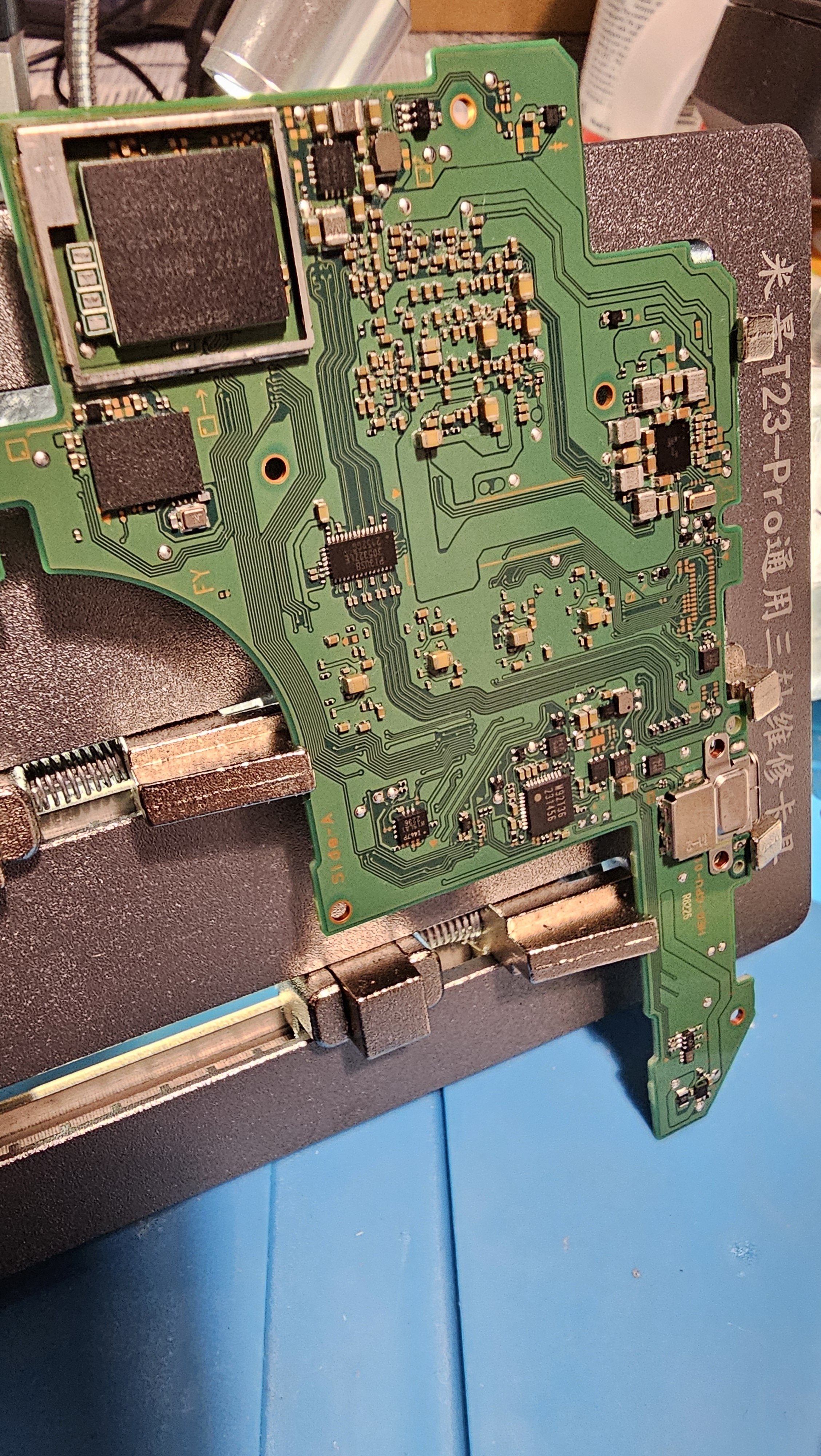

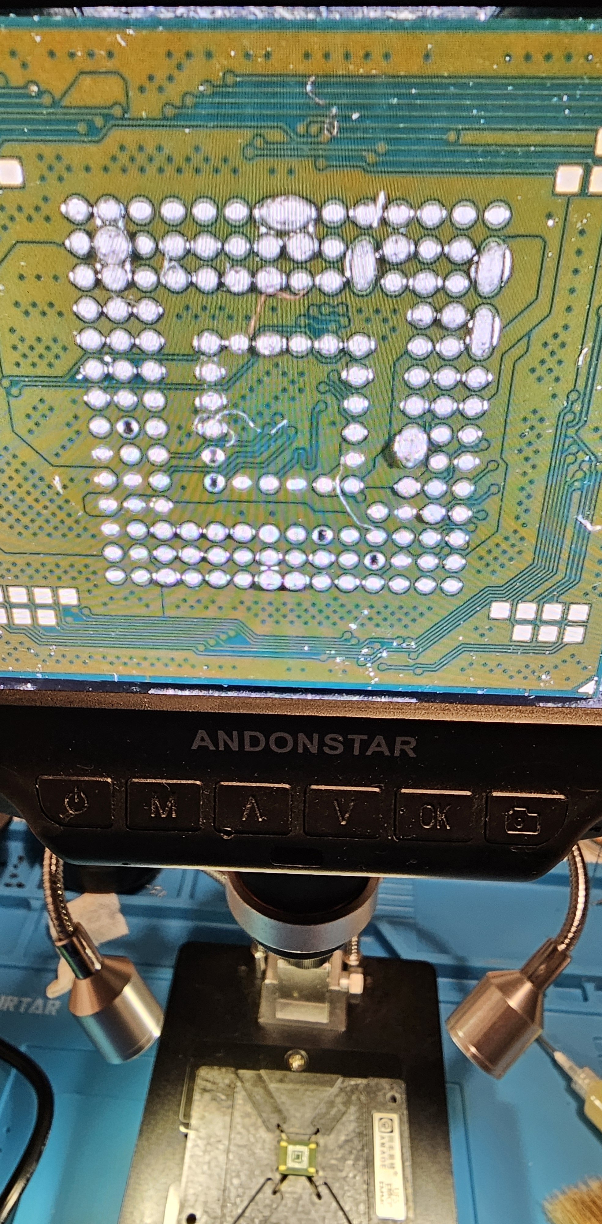

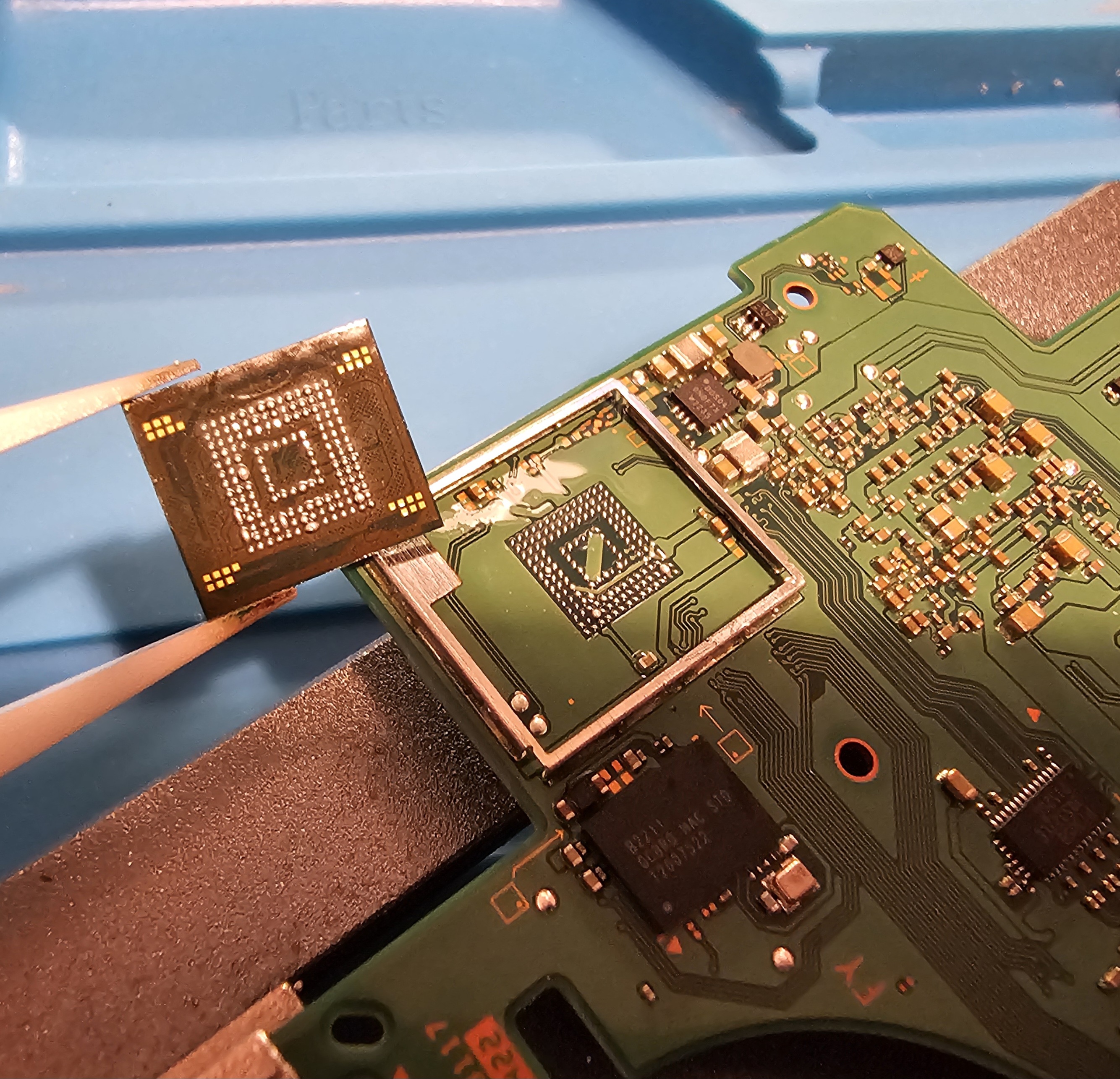

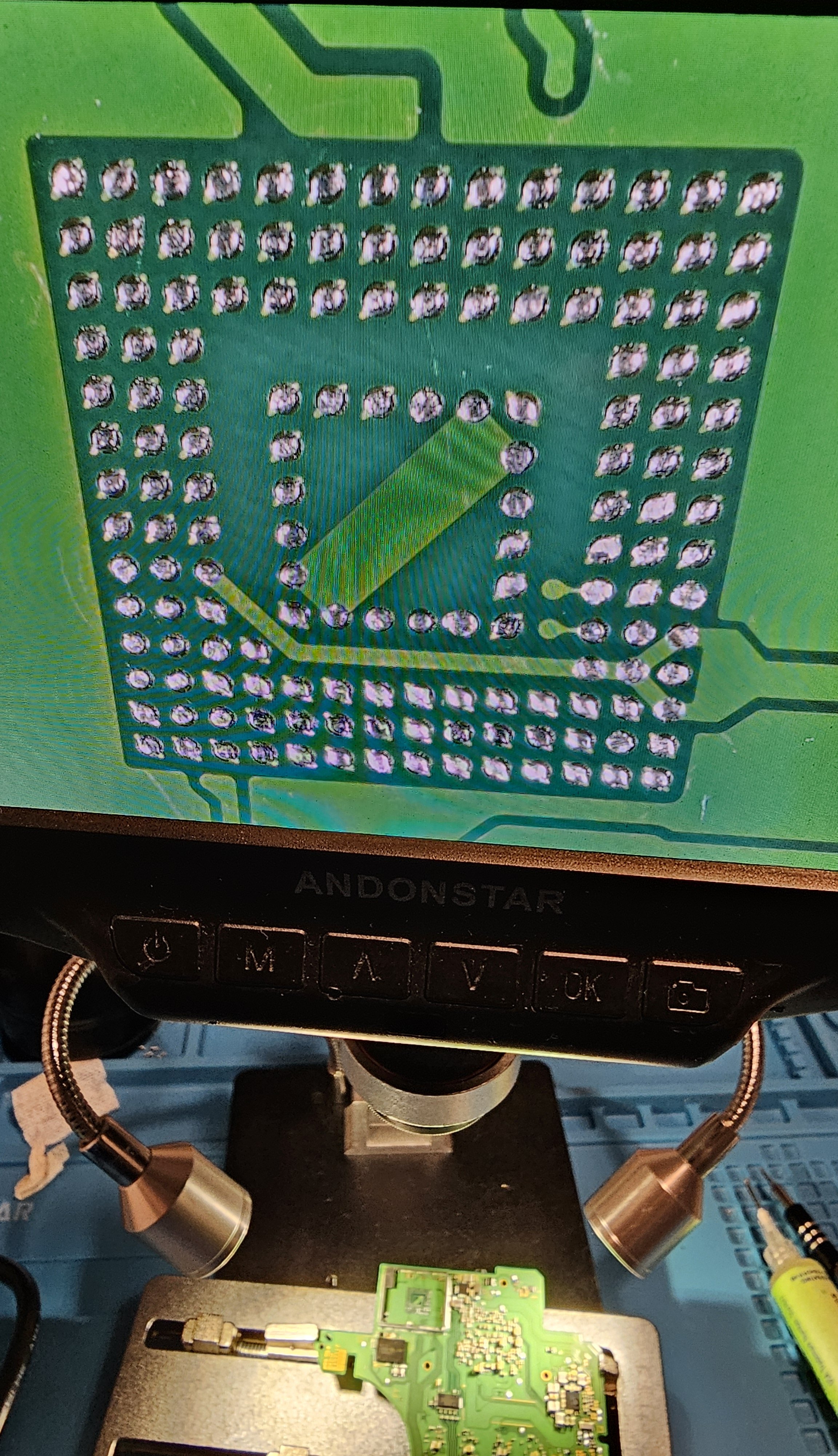

Lot of time but a easy work that second time done. @abal1000x
