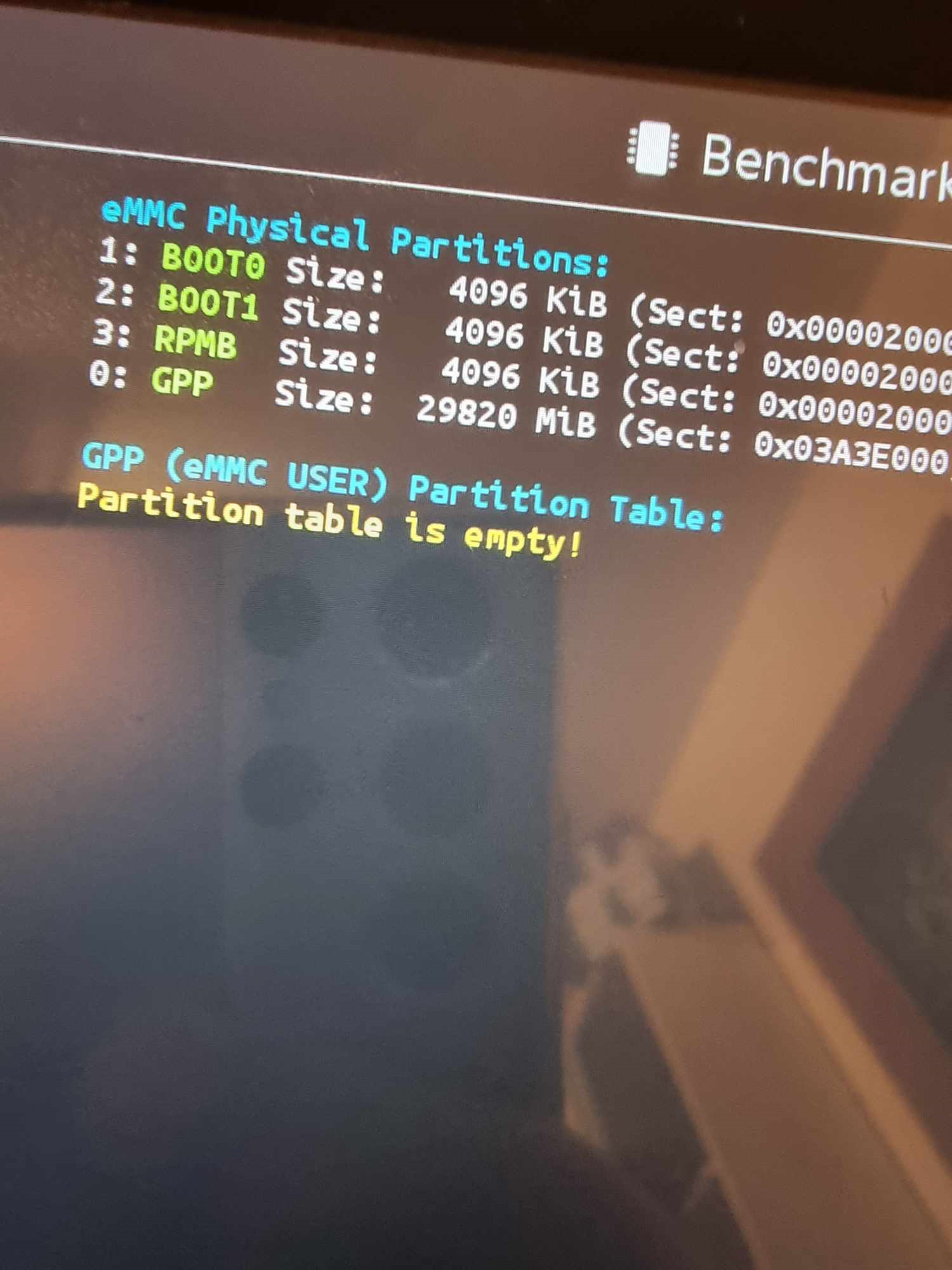

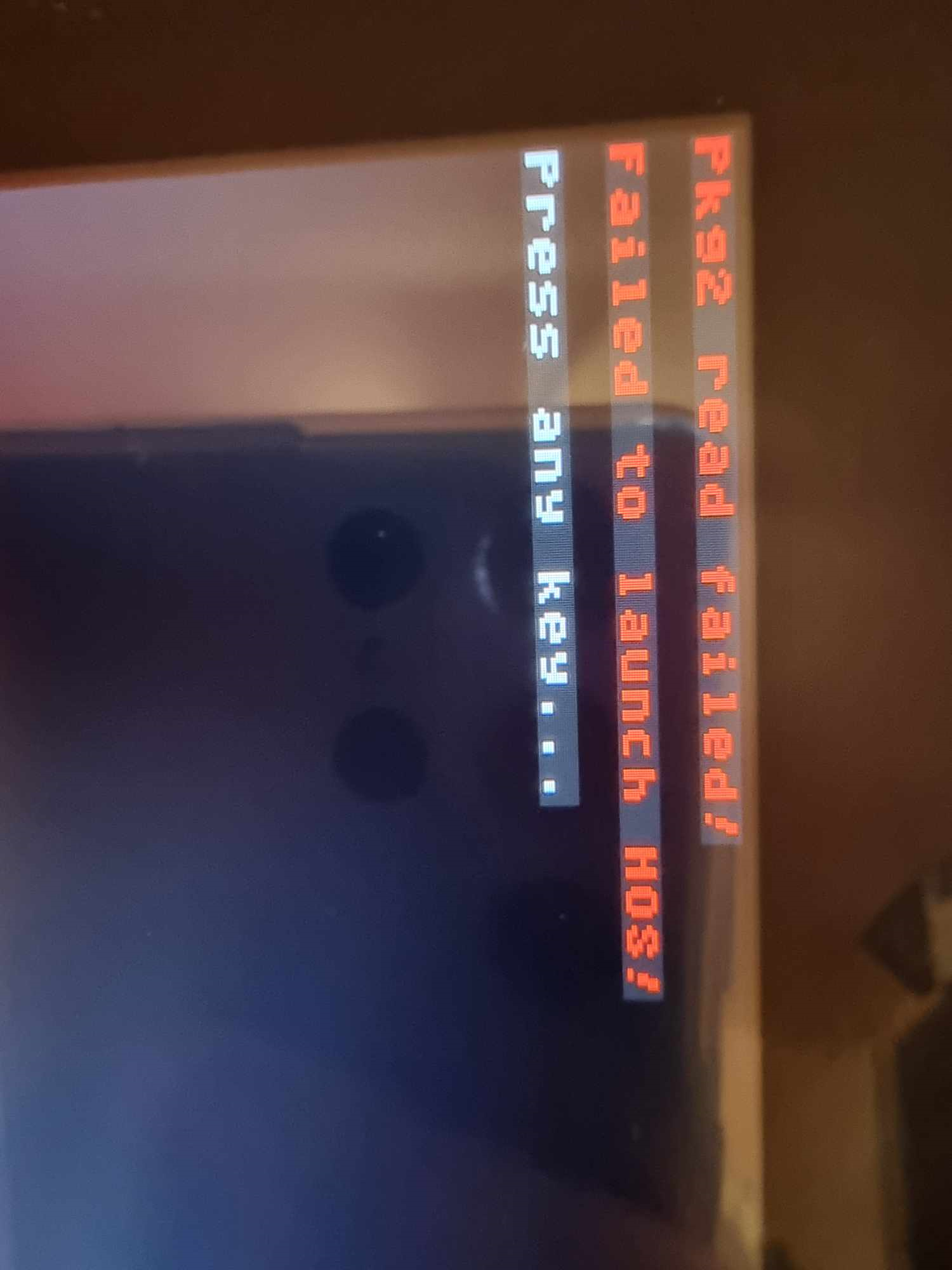

After attempting to do a new NAND write from scratch with prodinfo, OFW was stuck on logo . So i did a NAND restore to my old NAND save (the one that i was getting 3539 error on ).
Now when trying to start OFW i get this screen View attachment 398276
Well. View attachment 398280
I encountered the same problem after installing picofly, I recreated mmc from the donor nand file. Just remember to write a higher version than your ofw software version
i did a donor nand rebuild . Worked for a couple of days, then it started acting up again.
While acting up i put 200 ohm resistor on DAT0 and 200 ohm on CMD, and i was able to boot OFW with no nand rebuild.
After that i did a Nand rebuild again and its been a couple of days "stress" testing it and so far its ok. But i dont know if this will last.
