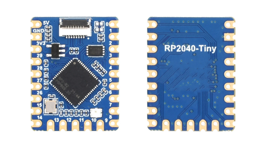

Its useless right now (current fw), bridge gpio25-gnd just means switch the led color code.
Bridge the 24 and 25 doesn't even have any meaning at all in the current fw.
Need rehius to update the fw to give it a meaning :D
My fault. I misread that 24-25 needed to be bridged for the color code switch. Definitely makes more since to ground one.
Still, I hope someone gets the 2040-Tiny board to work. Seems like a great solution.
cgtchy0412
Apr 26, 2023
287
41
436
Indonesia
wow ! i just realize it....
RP2040 tiny really slim:blink:
look the back side :bow: nothing on the back sideB-)
recently
i found from my online shop here(shipment from china i think)
but
they sell it 4x price than the regular RP2040 zero hehehe
lol
is it gonna work if someday we change from RP2040 zero to tiny ?
You can do almost the same with normal Pico, but you you will loose debug led. But not a big issue as long as you solder every point carefully. I even cut/trim it before soldering just after i flashed it.
