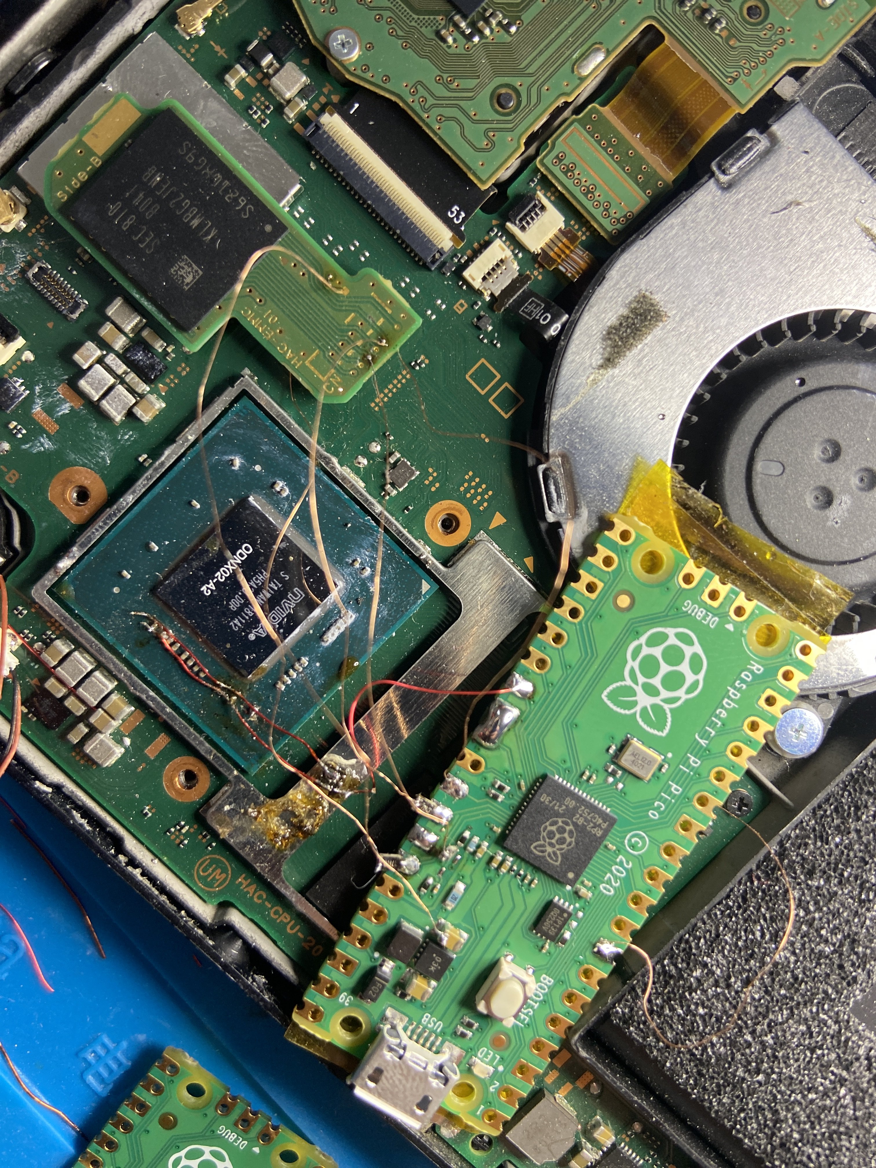

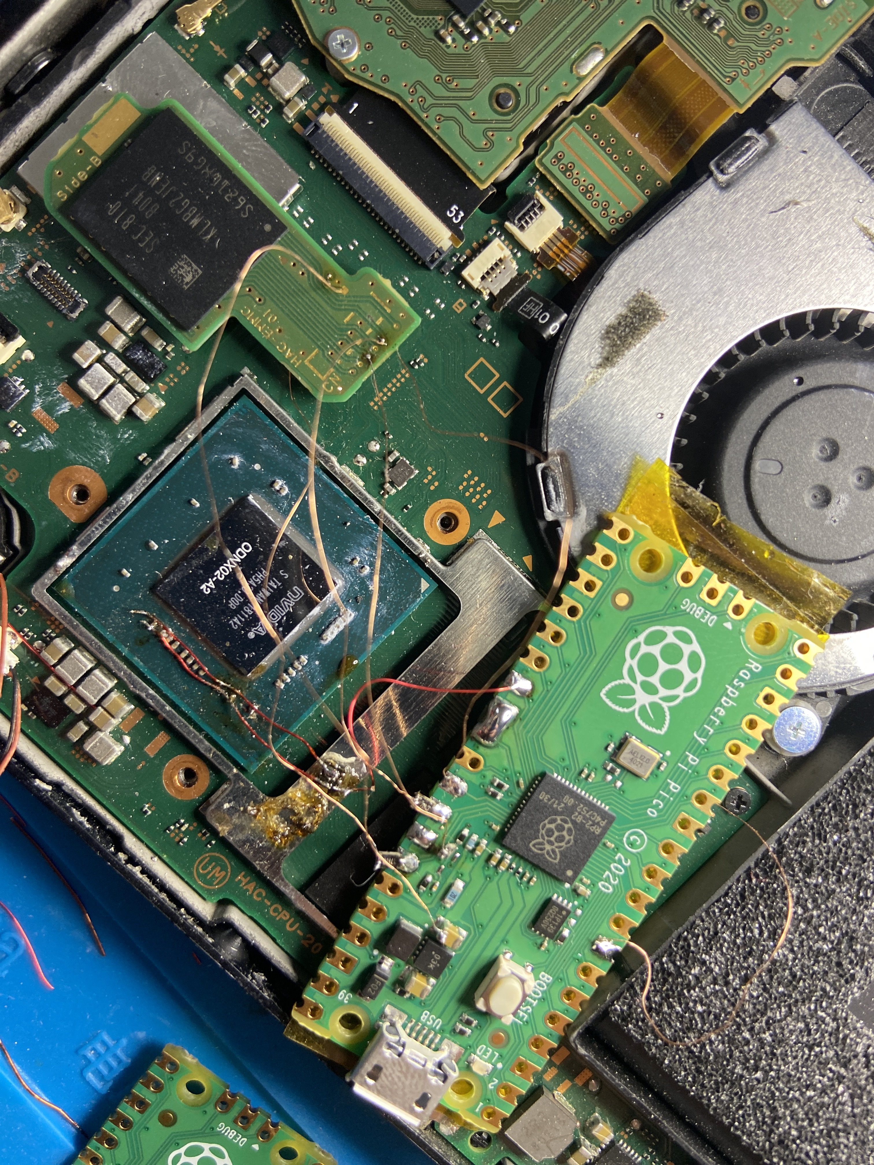

since its runing fine now with the 2 caps stollen from the rp go ahead and reinstall the pico with the caps on it should work
I was so consumed with the multimeter reading that I didn't bother to try it out. Thank you! It did work. I have officially glitched a Switch with a MOSFET.

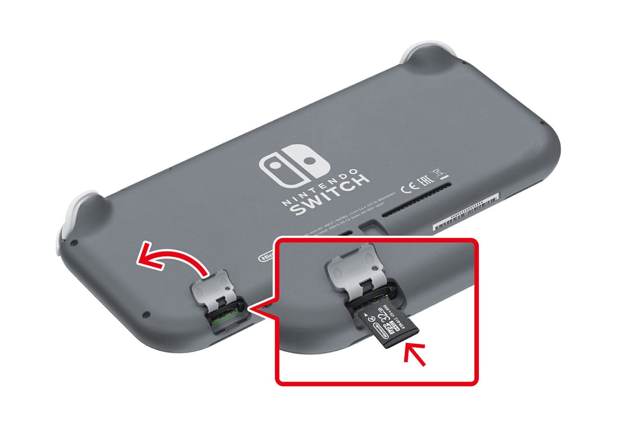

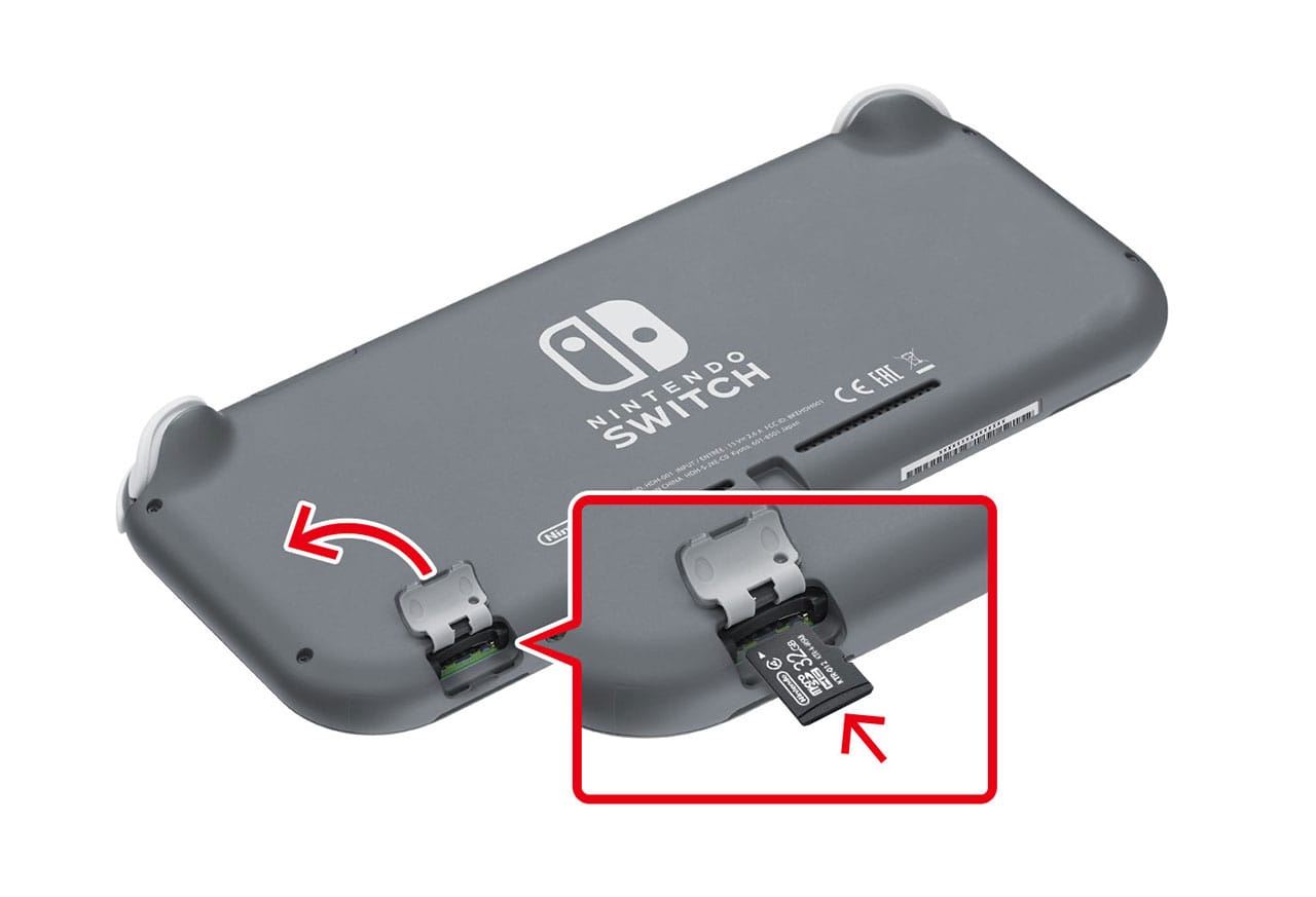

recently im trying to remove my micro sd on lite slot...
i think my micro sd stuck ...
but the switch still read the micro sd when i turn it on...
does it bounce back when we press the micro sd???
when i press the micro sd... it feel hard and nothing bounce ??

Eject spring might be broken.
