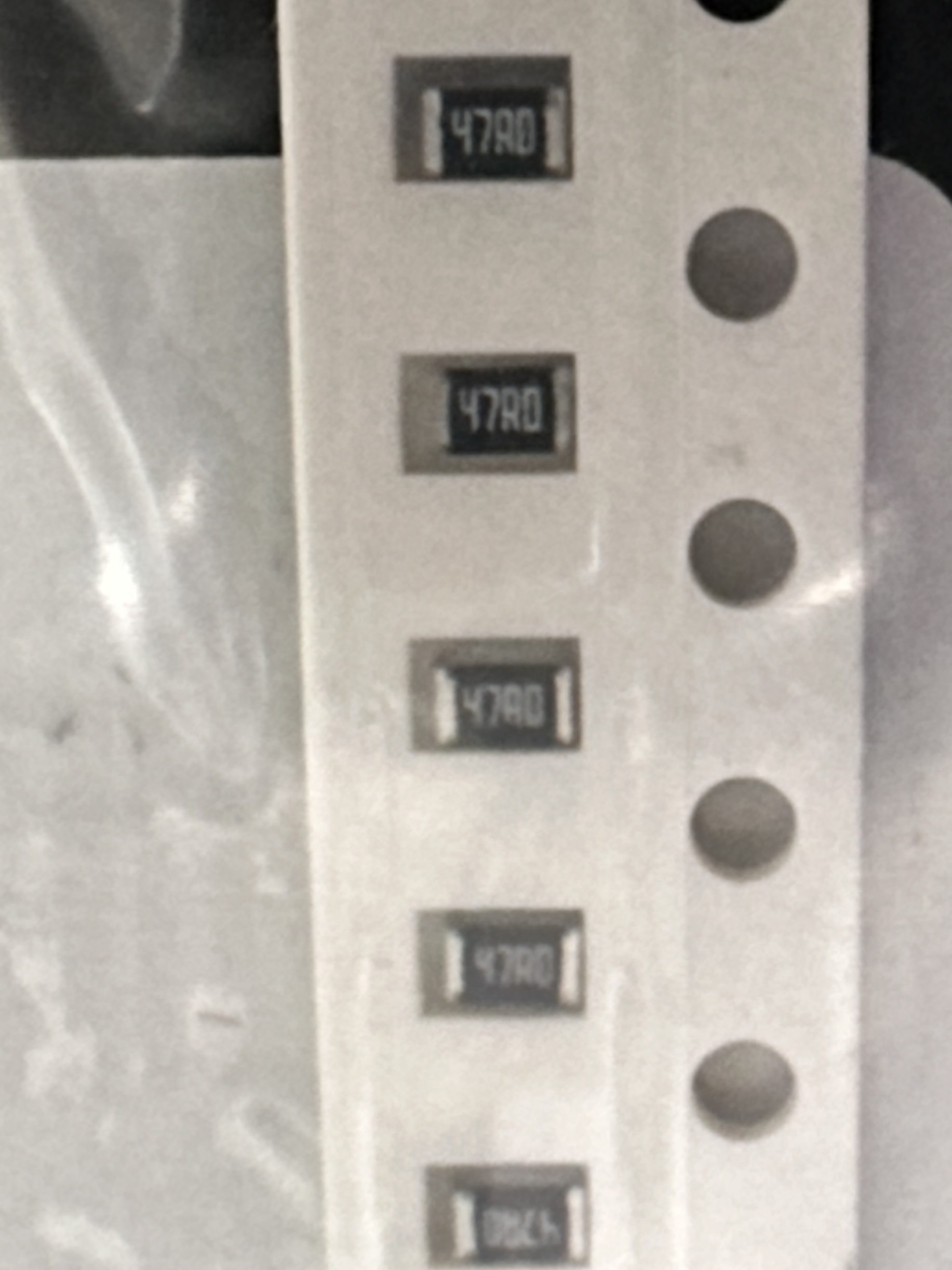

Q: Do I really need 47 Ohm resistors?
A: You can skip them, however in this case you will have to use emuMMC due to the line interference, sysNAND would not boot (sysNAND data can be damaged).

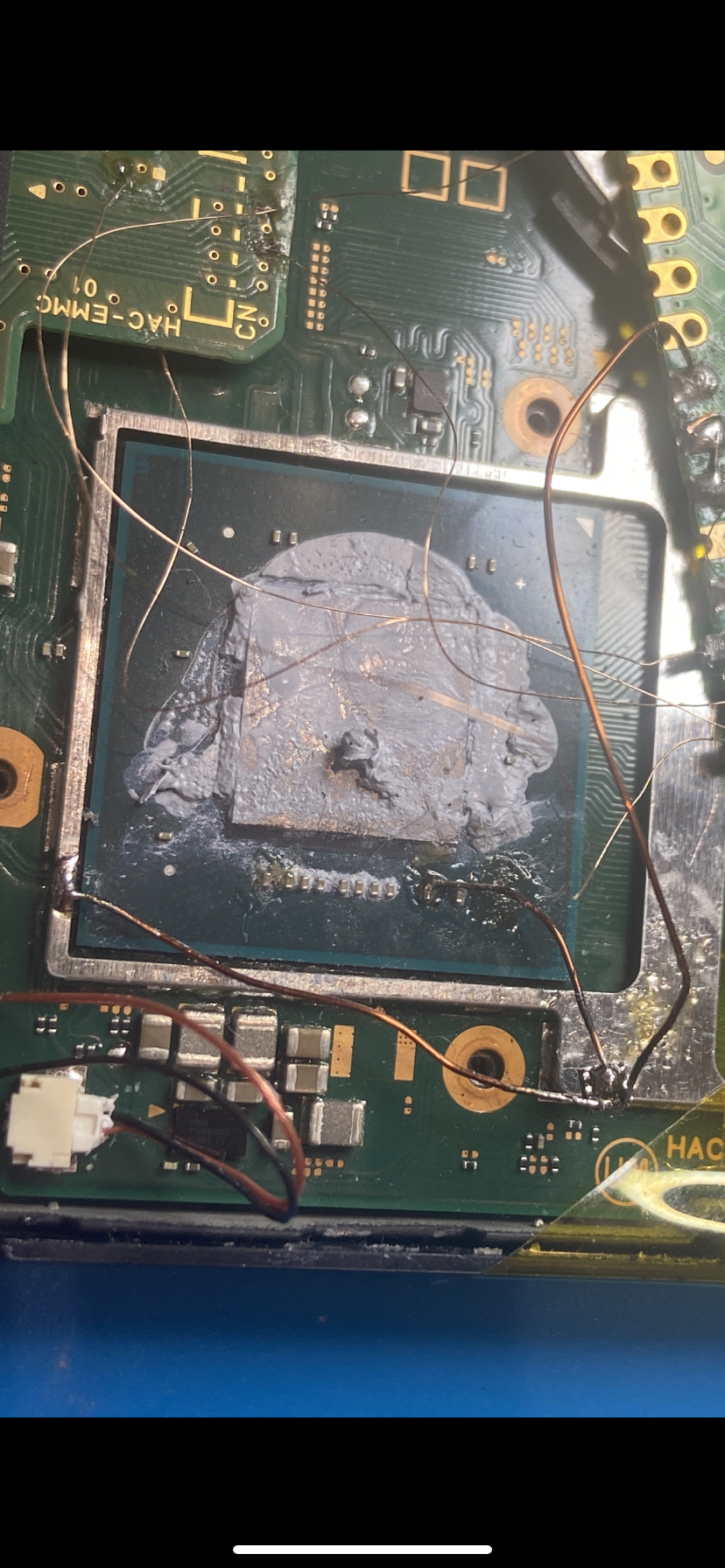

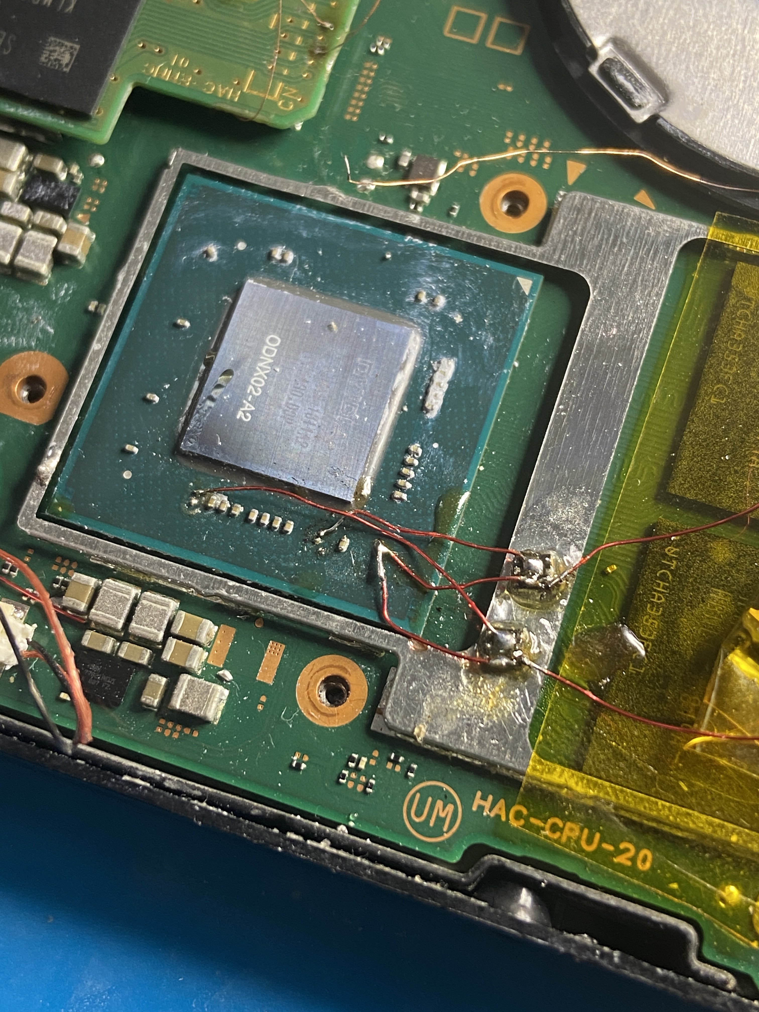

Hello. I've tried 3 different MOSFET types, and two different wires (0.1mm and 0.3mm). I just won't get a CPU value on diode mode.
I've tried the close GND ground and tried two MOSFETs at once. Same thing.
Any advice? Thank you.
"Both capacitors should be connected at the point."。

Hello @FreeLander, looks like you found the dangerous incorrect diagram by sthetix where the 3.3v point is actually direct 4.2v right from the battery. Be careful, such overvoltage may fry your RP Pico and the console. Please use the proper 3.3v point here:

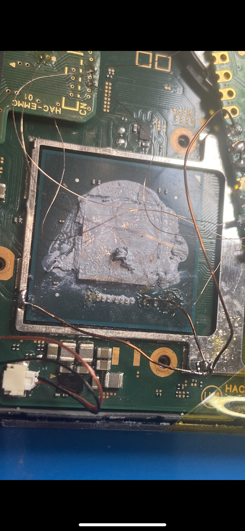

Hello, POPO. Thank you.
I did this and I'm still getting zero on diode mode. I can't tell what is it I'm doing wrong.
I even removed the caps entirely and soldered to the pads directly, but still no luck, and even worse, the console wouldn't boot.
Thankfully, @rehius anticipated noobs like me would do this, so I did his trick by salvaging the caps off an rp2040 and re-soldering them to the console. Now it boots fine, but I'm still determined to figure out how to get a successful glitch with MOSFETs.
I followed every step. 0.2mm enameled, two MOSFETs, short wires, close grounds.
since its runing fine now with the 2 caps stollen from the rp go ahead and reinstall the pico with the caps on it should work

Do you have a clearer photo of your firsts? Also have you tried the flex?
FreeLander
Apr 6, 2023
350
35
467
Hello, Dee.
Okay, but shouldn't I be getting a 0.6- 0.9.0v diode reading on the G point?
Wil try to do a better pic. I have not tried the flex on it since it's a v1 experimental console, I'm kind of hesitant about wasting a cable on it. I'm interested in doing MOSFETs moving forward, that's why I'm experimenting with this v1. I guess my question is, shouldn't I be getting a diode reading on G point?
