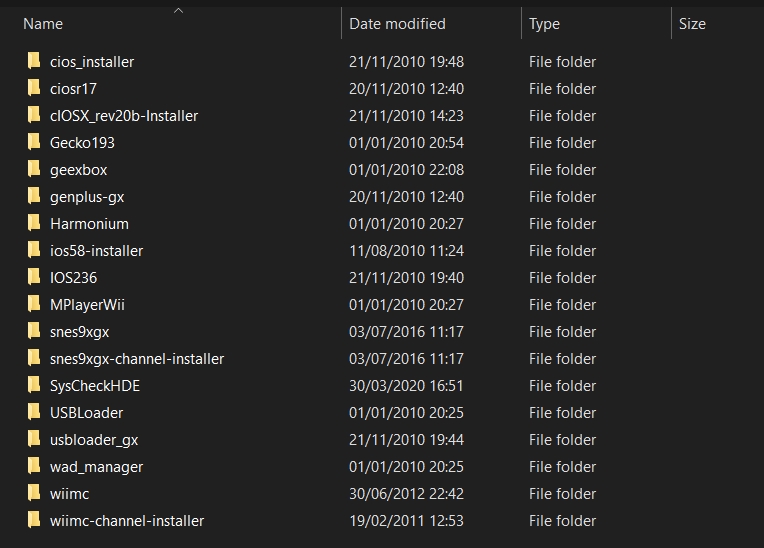

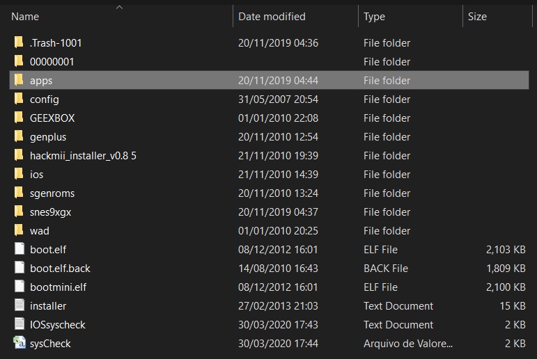

Hi,
I just bought an used Wii that is already softmodded but I think that everything is probably outdated. I had some problems trying to load a HDD on USB Loader GX (it would ask to format my HDD everytime I loaded it, but after formating it the partition would appear as only having 60GB of free space, even though it was empty - a 500GB partition) and when I was finally able to actually open USBloader, I tryed to play Skyward Sword but my wii would reset and go back to homescreen.
I just started learning about softmod about two days ago (when I realized that whatever was happening inside the wii wasn't working exactly how its supposed to) so please bear with me.

Hi,
Here's my syscheck:
Hello.:)
Thank you for the sysCheck,it says a Lot about your Wii.
Before you do anything,please check if you have Priiloader installed.
Please Press and HOLD the RESET Button on your Wii and power it on.
You should get into Priiloader Menu.If not please install it first.I hope it works I am not really sure the latest v0.8.2 works on your Wii.You maybe need a patched IOS36 before you can install it.
So:
Maybe the easiest and safest Way is to use @XFlak ´s ModMii:
https://gbatemp.net/threads/modmii-for-windows-official-support-topic.207126/
This Tool updates your Wii and if you like many more Things.
It maybe will suggest to update your Wii to Version 4.1U.
I remember @Cyan has also an 3.2U Wii so it is maybe not necessary to Update the Wii´s System Menu.:P
Do you have an SD Card attached to your Wii ? If yes,then you maybe use this further please because I am not really sure if bigger SD Cards are working with your Wii´s System Version 3.2
If you have installed ModMii you can use your sysCheck to bring your Wii to an Up to Date Status.
It also gets the Priiloader for you,a WAD Manager and of course the HackMii Installer to update your Homebrew Channel to Version 1.1.2.
or
Maybe this next Steps should be sufficient to get the USBLoader GX and Wii Games loading to work.
You can use the d2x cIOS Installer and install the Custom cIOS -d2x -v8 -final
into Slot 249 with Base [57] and 250 with Base[56].

Ok, so I'll install 4.1U version. Then... can I put only SystemMenu_4.1U and priiloader in the old SD, install both and put the rest in the new SDHC?
Plus, what can I do / should I do with the old SD files?
Here's what's inside of it:
^_^
^_^
Did you also get your personal Guide from ModMii ? It is generated on your Needs and your Settings and will also saved in the COPY_TO_SD Folder.It will guide you which Steps are first.:)
(I can not say what comes first,maybe the Wii Update but please refer to your personel Guide from ModMii).
After the System Update to 4.1U you should use your new,bigger fresh FAT32 formatted SD Card and put the downloaded by ModMii Applications and WAD Files like in your personal Guide suggested on it.
And later it is maybe a good Idea to look for newer Versions of you Applications or newer Homebrew.:)

So, I installed all the WAD files my personal guide suggested and was going to install priiloader and I got the message "Recommended to install correctly IOS236... IOS236 isn't ES_Identify patched : error -1029, aborting mission..."
I believe I have to install IOS236 again, but I can't manage to find that file anywhere on internet, it's been deleted everywhere I try. :( Does anyone have a suggestion?
okay, forget that, I found it on ModMii, sorry. I'll install it and come back with my results. :P
make sure you install the system menu together with the corresponding system menu ios (iso 60; 70 and 80 to be safe) before rebooting or you will get a menu brick.
I was able to install them all toghether. Turns out that snes folder had 500mb of game roms so I just deleted that to get some space. :)
@alexander1970 It worked! Thank you again for your help! :yaywii::yaywii::yaywii:
