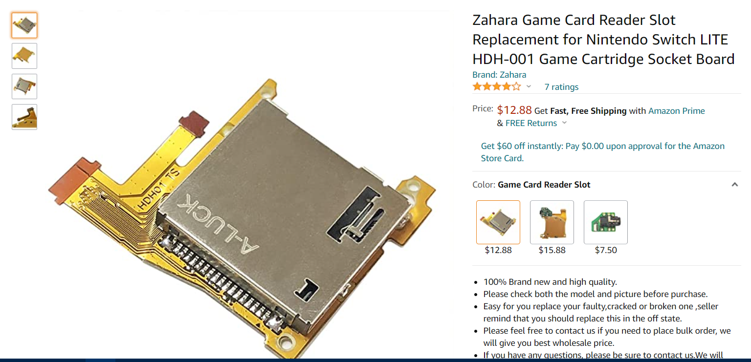

Does a factory reset automatically update the cart firmware? Just finished the factory data reset and still no luck. Craig Lloyd from Ifixit recommended that I disconnect and reconnect the battery connection, of which I also did. No go. I'm scratching my head here. There's no way I got a second bad cart reader is there? This is the one I ordered (Can't post link, sorry for screenshot)

i dont know when the reader gets updated exactly, i wasnt sure if the factory reset updates it automatically. and when it comes to replacement parts i dont know much, i only tinkered a bit on broken 3ds consoles. i ran into the reader problem myself on my jailbroken switch once, but the problem was that i couldnt use the latest cart reader firmware on a lower switch firmware. in this case the reader firmware seems to be lower than the switch firmware. i dont know if that is even a problem.
idk about gc slot replacements but when i had gc fuse issues, the only thing that fixed it properly was updating in ofw when a new version came out. others have had luck just booting into ofw and the fuse burning but i havent had such luck.
