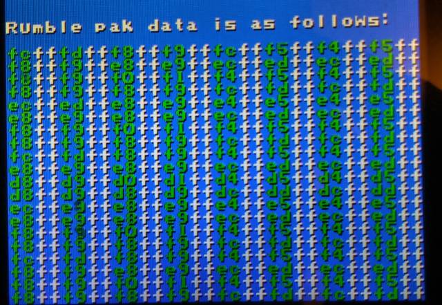

Here is something you can do to help:
1. Take this xdelta: https://www.dropbox.com/s/m5td8dh3w55hd11/RumbleChecker.xdelta?dl=0
and apply it to a retail US DS NSMBDS Rom (0434 - New Super Mario Bros. (U)(Psyfer))
2. Plug in the rumble pak that's undetected
3. Start the game. It will crash on the titlescreen and spew out some data
4. Give me a screenshot of it.
Kwyjor
May 23, 2018
4,323
4,471
Happy to help! A couple of the numbers flickered slightly; you can make it out in the screenshot.

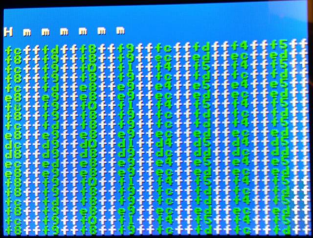

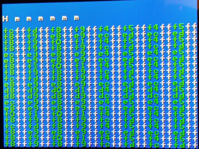

Hmmm, alright...
Could you test another one?
https://www.dropbox.com/s/qnd7crs862epjw0/Test2.xdelta?dl=0
This should be more conclusive...

Kwyjor
May 23, 2018
4,323
4,471
The result seems to be largely indistinguishable, I'm afraid.
To be extra thorough, I did the soft-reset on Metroid Prime Pinball and tried again, and I do notice that there seem to be some slight differences.
