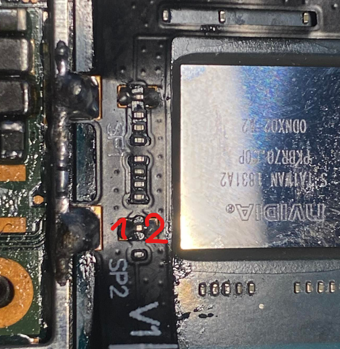

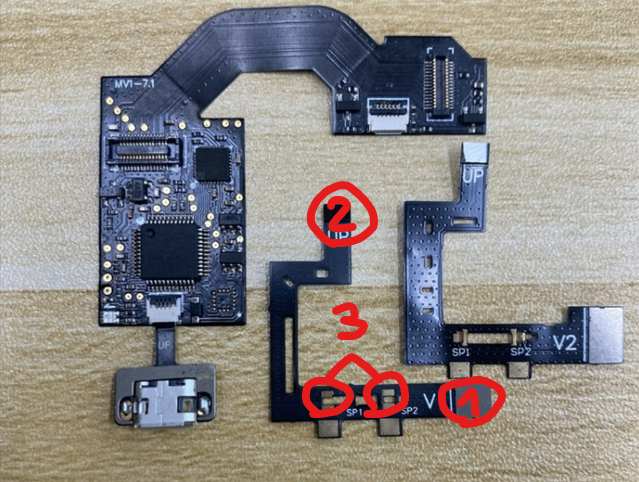

Hey, again thanks for your reply. I'm pretty new to this stuff so let me ask some things just to make sure I understand you correctly:
>Looks like the glitch MOSFET has little to no effect on your device. I would recheck the flex cable,
by MOSEFET you mean chip thats under 1. (pic) correct? and By flex cable u mean whether 2. is seated well enough? If yes, i cleaned it with 99% alcohol and reseated it few times just to be sure to no effect.
>other send is properly soldered to the CPU
You mean whether those soldering points are done correctly?
I'm not anywhere near being soldering master but those looks solid to me. I'll try resoldering everything soon anyway since I'm out of ideas anyway.
> reflow the MOSFETs on the bottom of the flex cable.
by that you mean resoldering chip at other side of 1.? I have another V1 cable i can try but it's in what I'd call "rough state"..
Again, sorry for asking all that stuff, but at the moment im clueless and want to get everything straight.

I noticed when i unsoldered 1 & 2 points from capacitor it still tries to train (no white light). Does it indicate bad chip?
