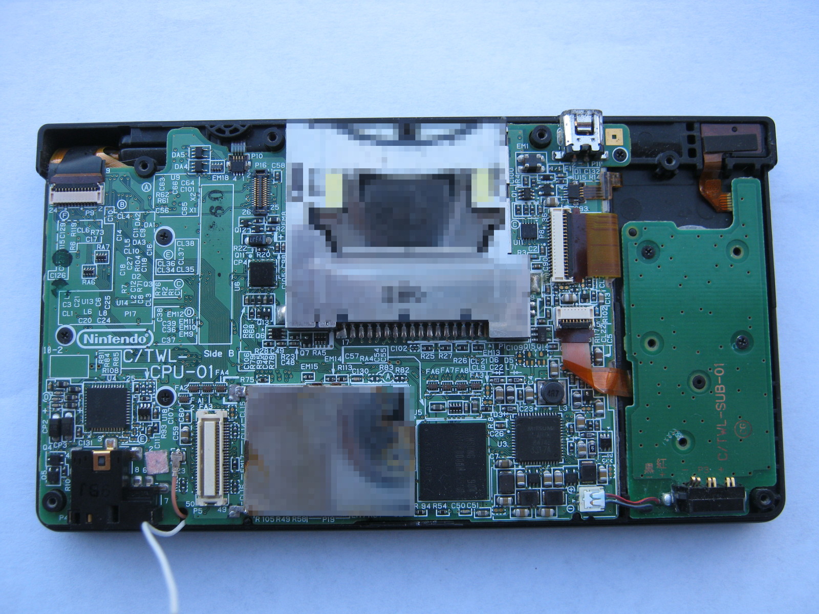

Now that you mentioned junk DS: I have two dead DSi motherboards. Charging should still work.

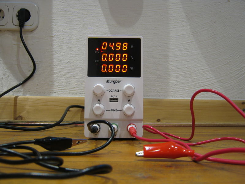

The lab power supply: I've been thinking about ordering one for at least 10 years (not kidding). Time to get one! Such a thing will come in handy anyway. Buying a decent thermal camera just for this would be insanely expensive… guess the only temperature sensor will be my index finger.
Blog entry about this will come – but it will take a while.

The cheap lab power supply arrived. And a water-damaged scrap DSi with hopefully still working charging electronics was also in my "No, I will not throw this away – I may still need it at a later point"-box. Maybe the multimeter can be convinced to measure temperature on the charging IC and/or the EM1 filter while charging a battery with various voltages.
Thermal camera is just toooo expensive for this small experiment. When would one need this again?
Thanks @IC_ for bringing up the voltage topic. Looks like I will have to solder some wires to the power connector… oh well. Hope it works.
