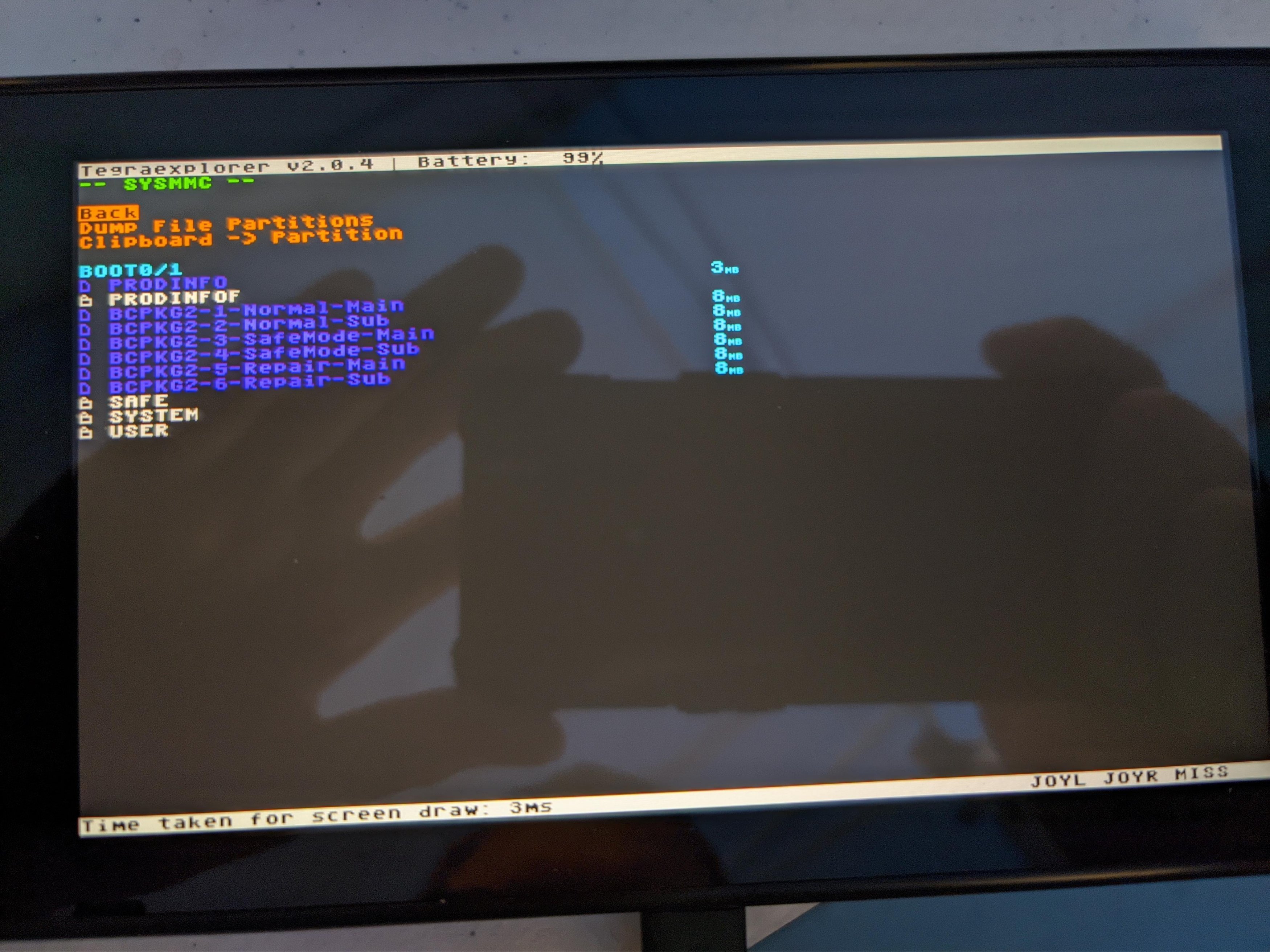

Is there an updated version to this step? Current Tegraexplorer don't have [SYSTEM:/] EMMC. I have no idea where to find 8000000000000050
Update:
Found it
Browse EMMC > SYSTEM > save > 8000000000000050
