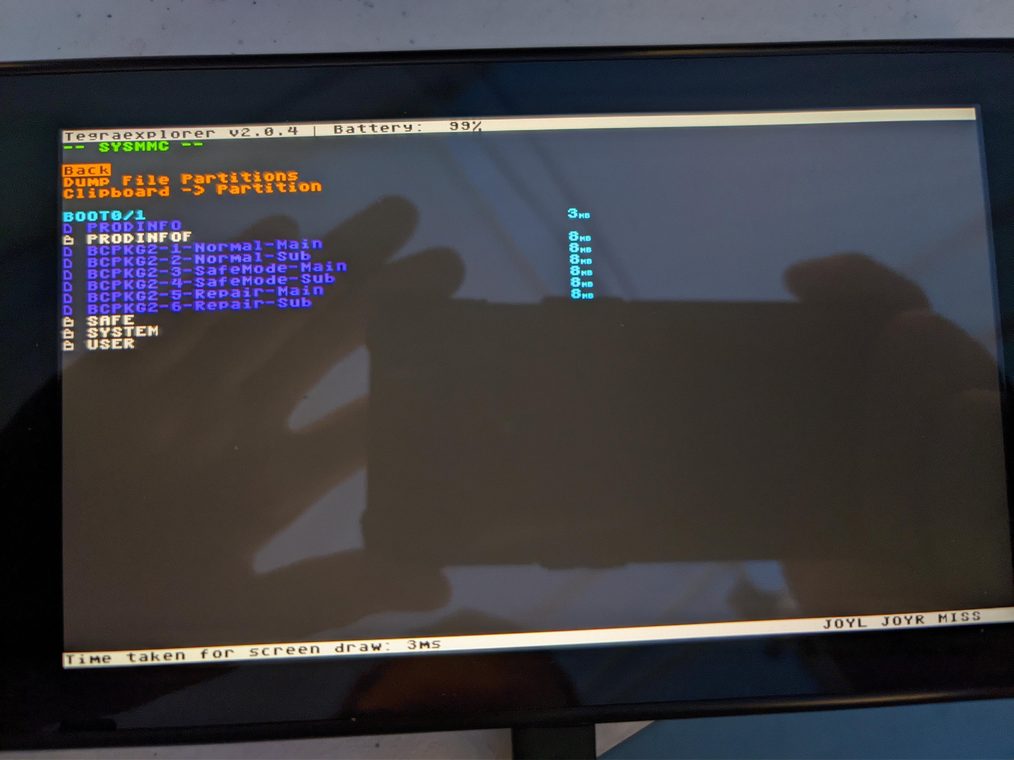

I do not quite understand what is being changed here for me it says 01 when I enter 29484 at the hxd
Everything easy, only because I don't know where to enter the 1, it looks like this for me
Thanks
Thanks
Do you know which firmware version is on this console? And it's currently still prompting to connect the joycons when booted?
Mrblue
Oct 4, 2018
15
44
193
Austria
Firmware 11.0.1
I have no joycons
After a reset, he wants the Joycons on the start screen
Which number should be changed? or is it already there in the picture 01? I have not adjusted anything!
Thanks :)
shchmue
Developer
Developer
Dec 23, 2013
791
2,367
Firmware 11.0.1
I have no joycons
Thanks :)
it’s already set in the photo. it’s possible the check has changed in firmware 11.0.0
