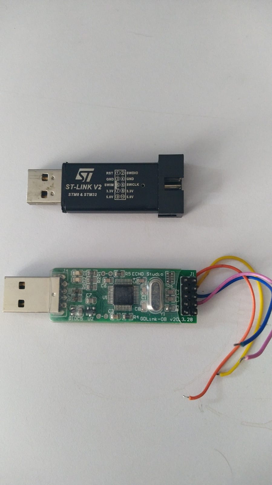

So... can someone look at my pic and tell me whether I need a GD-LINK or an STM-Link? And are there instructions for doing the SWD thing on this particular model yet? pic on page 10: https://gbatemp.net/threads/tutorial-how-to-flash-the-hwfly-clone-chips.606008/post-9728860

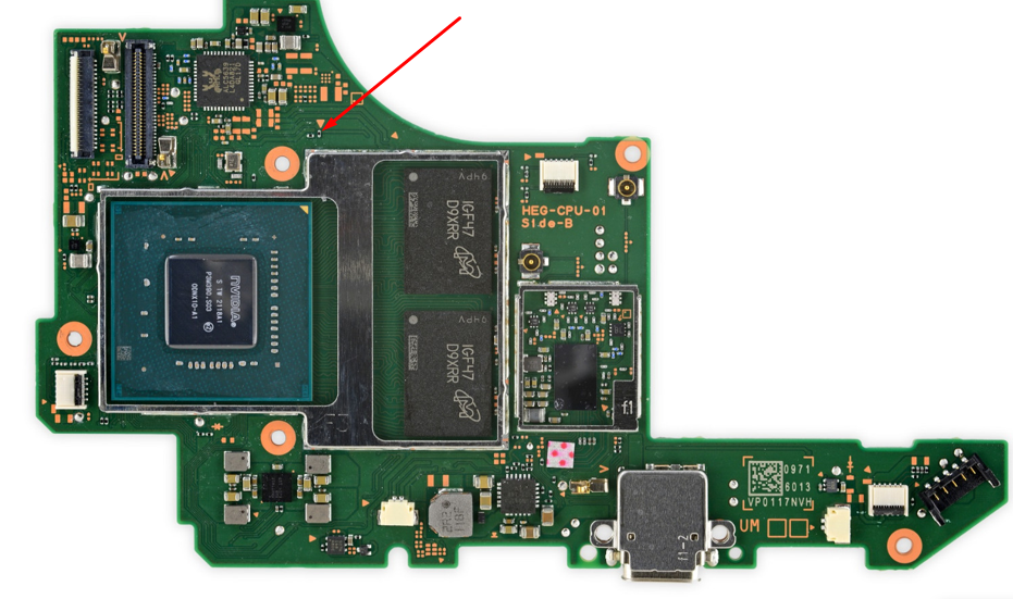

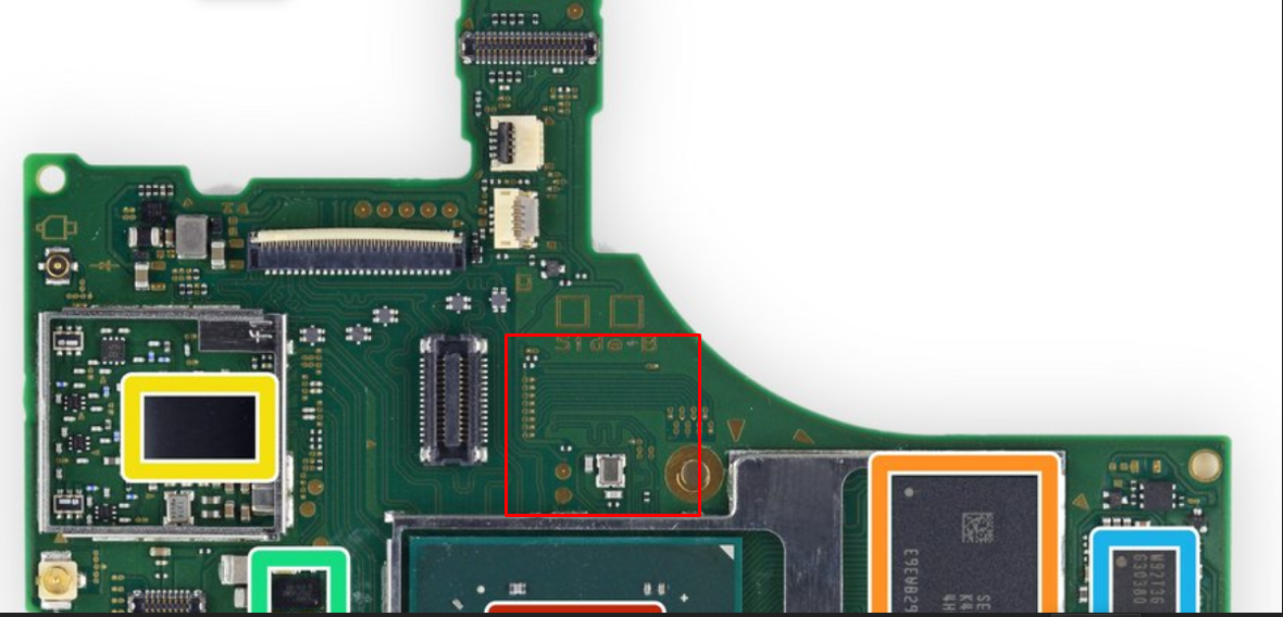

hey where can i find the cmd point in the older switch motherboard.
I don't know which one it is I'm trying to use this board as a donor for my OLED

I assume you mean the modchip? Otherwise this just won't work.
the point where the cmd goes to from the modcip. i think its
47kΩ ±1% 0.05W 0201. so where trying to find the​
47kΩ ±1% 0.05W 0201 on the older switch so i can take it off and put it on my oled​
