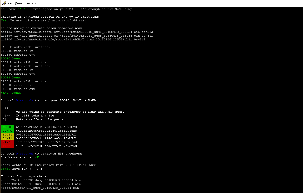

Some cool features for all non technical people or all struggling to get biskeydump payload working on their switches ! Happy days !
  • You can simply boot distro, execute dump_nand command and script do everything for you !
  • It's actually dumping BOOT0, BOOT1, and main (big) NAND device to file
  • It's checking MD5 sums automatically to make sure your dumps are not corrupted (And probably the best below ;-))
  • It's extracting TSEC Firmware required by @rajkosto biskeydump. Not enough ?
  • It's automatically format the file into C Array format (tsecfw.inl)required if you want to compile biskeydump fusee-loader payload yourself. Still not enough ?!!
  • It can generate ready to use biskeydump v3 (fresh git pull from repo with QRCode so you don't have to retype keys from screen - thanks @rajkosto !!! ) payload for you, so you don't care about compiling stuff anymore !! :toot:
Of course it's not ready to use payload, it doesn't contain firmware part, but well... script will inject firmware from your dumps for you automatically :}
Remember: That you can participate in this project. If you don't have time or skill just post your ideas there. Some of them might be implemented in future releases.

  • First there is a check if all required block devices are available under system (mmcblk1boot0,mmcblk1boot1,mmcblk1)
  • Then it checks if you have enough free space to fit 32GB dump. If not unfortunately it quits with error.
  • When everything is fine it just prepare commands set to start dumping process, you will be asked if you want to proceed
  • After dumping process (usually takes less than 10 minutes on 64 sdXC SanDisk card) checksums are calculated to make sure everything went fine. If there is a checksum mismatch you'll see an error
  • Next it will ask you if you tempted to get your BIS Keys to decrypt your NAND if you select yes again:
    • TSEC Firmware will be extracted automatically from BOOT0
    • tsecfw.inl file in proper format will be generated
    • new version (v3) of biskeydump payload will be served for you in /root/biskeydump_armed.bin and I hope you know what to do with it.

My NAND dump only came to 4.2MB that doesn't seem correct, i used a fresh pull of the git into /opt/ did you implement compression on the bin file?
I only have my save for zelda stored on the switch mind.
[root@kombos /]# cd /opt/sw_nand_dump/
[root@kombos sw_nand_dump]# ./sw_nand_dump.sh
 ___
|[_]| Nintendo Switch NAND dumper
|+ ;|  -//- [email protected] -//-
Checking if your SD Card root partition can fit NAND backup:
You have 115 GB free space on your SD ! It's enough to fit NAND dump.
Checking if enhanced version of GNU dd is installed:
Yes. We are going to use /usr/bin/dcfldd then
We are going to execute below commands now:
dcfldd if=/dev/mmcblk1boot0 of=/root/SwitchBOOT0_dump_20180428_201958.bin bs=512
dcfldd if=/dev/mmcblk1boot1 of=/root/SwitchBOOT1_dump_20180428_201958.bin bs=512
dcfldd if=/dev/mmcblk1p1 of=/root/SwitchNAND_dump_20180428_201958.bin bs=512
8192 blocks (4Mb) written.
8192+0 records in
8192+0 records out
BOOT0 Done.
8192+0 records in
8192+0 records out
BOOT1 Done.
7936 blocks (3Mb) written.
8158+0 records in
8158+0 records out
NAND  Done.
It took 0 seconds to dump your BOOT0, BOOT1 & NAND
   ))   We are going to generate checksums of NAND and NAND dump.
  |~~|  It will take a while.
 C|__|  Make a coffe and be patient.
 BOOT0  a0f0614044541ebd3c668bac447c4cca
 DUMP0  a0f0614044541ebd3c668bac447c4cca
 BOOT1  a876f650792d6e0f8a4c972e99dd8460
 DUMP1  a876f650792d6e0f8a4c972e99dd8460
 NAND   6256b895ecedbb400d1bf020d6866e75
 DUMP   6256b895ecedbb400d1bf020d6866e75
It took 0 seconds to generate MD5 checksums
Checksums status: OK
Turns out the script needed editing to change line 11: nandpath="/dev/mmcblk1p1" to nandpath="/dev/mmcblk1"
