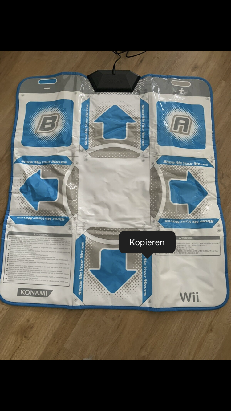

but on vwii (wii) games i not can use hid to vpad or ?
how to play wii games (Dance Dance Revolution) vwii mode on wii u with the Adapter and a Dance Mat.

View attachment 205357but on vwii (wii) games i not can use hid to vpad or ?
You are right - HID to Vpad is only for Wii U not vWii. You could try one of the Mayflash adaptors (https://www.amazon.com/gp/offer-listing/B00BS520SG/ref=dp_olp_afts?ie=UTF8&condition=all or http://www.mayflash.com/Products/NINTENDOWiiU/W014.html) that lets you plug a GC controller into a Wiimote (but may have problems with the later ones with built-in MotionPlus) and make it show up as a Classic Controller. The GC to USB one would need support written into the *game*, as the Wii doesn't exactly have an operating system. Otherwise your best bet is to get a Wii that has GameCube ports (they removed them in later models).

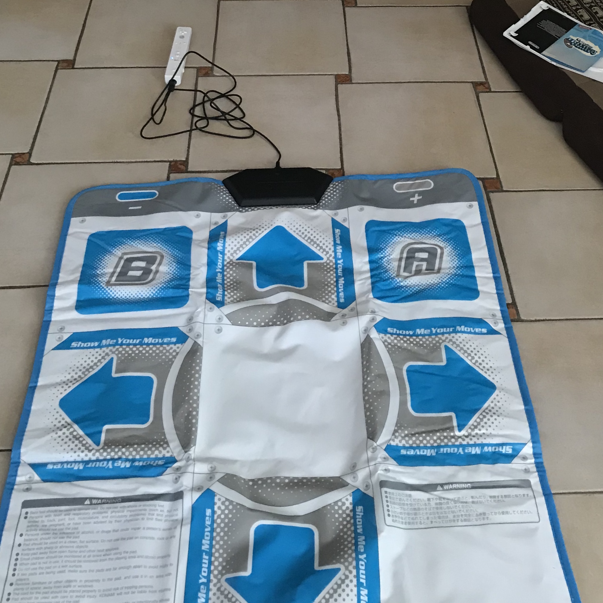

i get today this Adapter
what next steps to get this working with Dance Mat ?
i can not believe it works in vWii Mode on WiiU with a Dance Mat.
i have 2 wiimote (with and without motionplus)
Connect it to the socket on the end of the wiimote (try the non-motionplus one - it is reported to have better compatibility and it's not like you'll be waving the wiimote while using the dance mat) and plug the GC plug into it. It should now appear to DDR as a classic controller.
