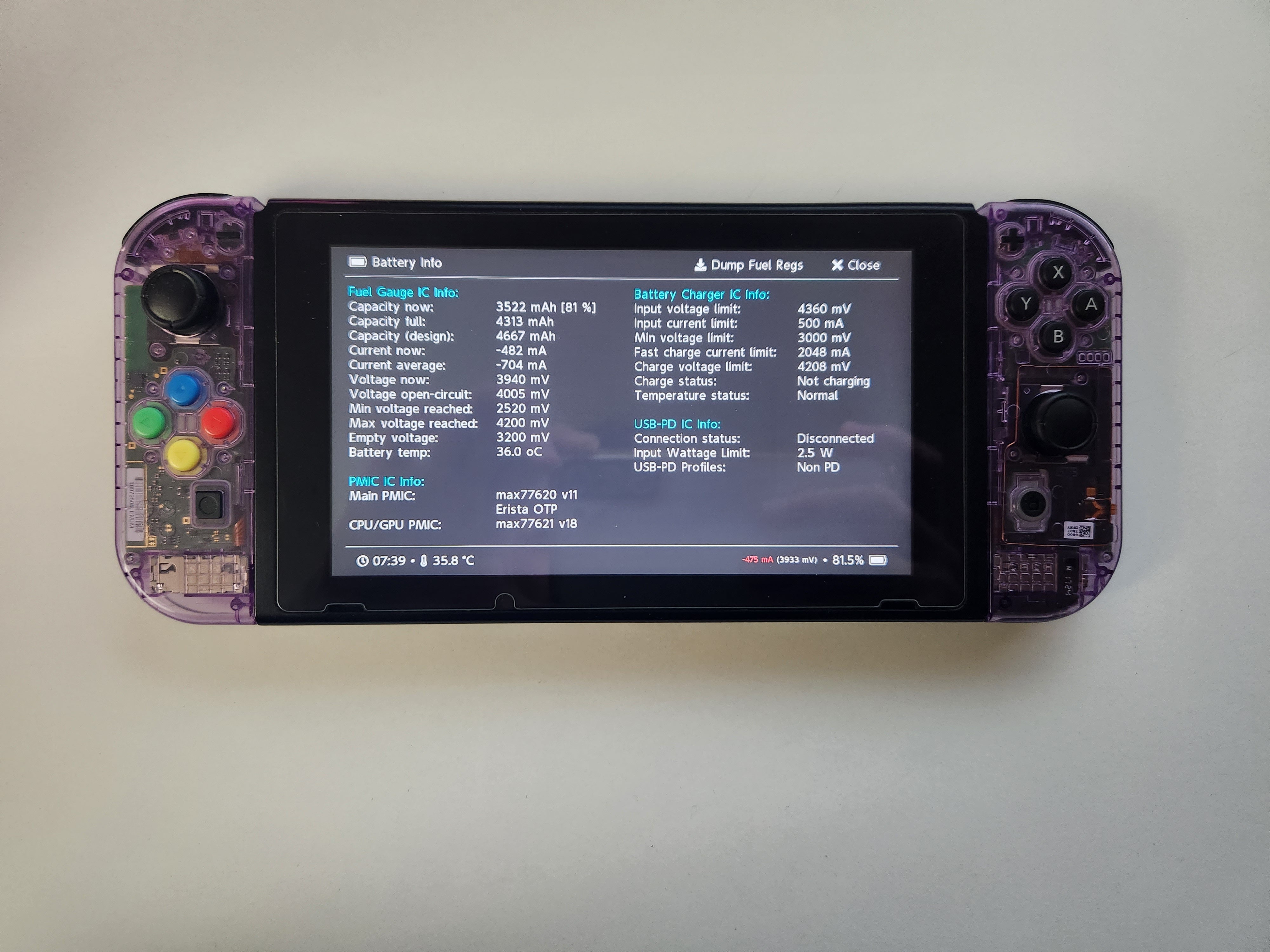

I have an original switch that I hard modded almost as soon as the firmware for the trinkets were released with a custom designed board with a samd21e on flex to reduce the cutting of the EMI shield. Everything worked fine for awhile. I had a few moves in my life, the switch got neglected and whenever I got back to it it was 100% dead, took 2 nights on a non-pd charger just to get it to report RCM before nearly instantly shutting off.
Once I got it charged up over the coarse of a week I realized that some of my magnet wire had rubbed through each other and I had to modify my hack a bit to prevent it. Even though I could see RCM and send a payload from a PC or phone, the hardmod chip could not. I rearranged the wires but since then I realize outside of rare instances the switch just won't charge, if plugged in it doesn't lose battery but it doesn't gain it either. Originally I thought it was the USB-C port however I tested all the connections with a breakout card. I use hekate and checked the battery info and that's when I saw its properly negotiating USB-PD and getting the correct voltage but the charging IC is reporting its overheated and won't charge. Attached is a view from hekate.
preview
Where should I start debugging this, or is it just time to replace the charging IC?

I have mine since late 2018, I only been using the oem charger, so it definitely your chargers you are using.
That's what's odd cause I have not introduced any new chargers to it. Oh well. I will test a bit more but seems the most likely cause
So I just did the test procedures I found.
As soon as I plug in 5v only or USB-PD the charging IC reports hot. Whenever unplugged its fine so something is wrong with the battery charge IC. Guess ill order one and replace it, fun little weekend project
