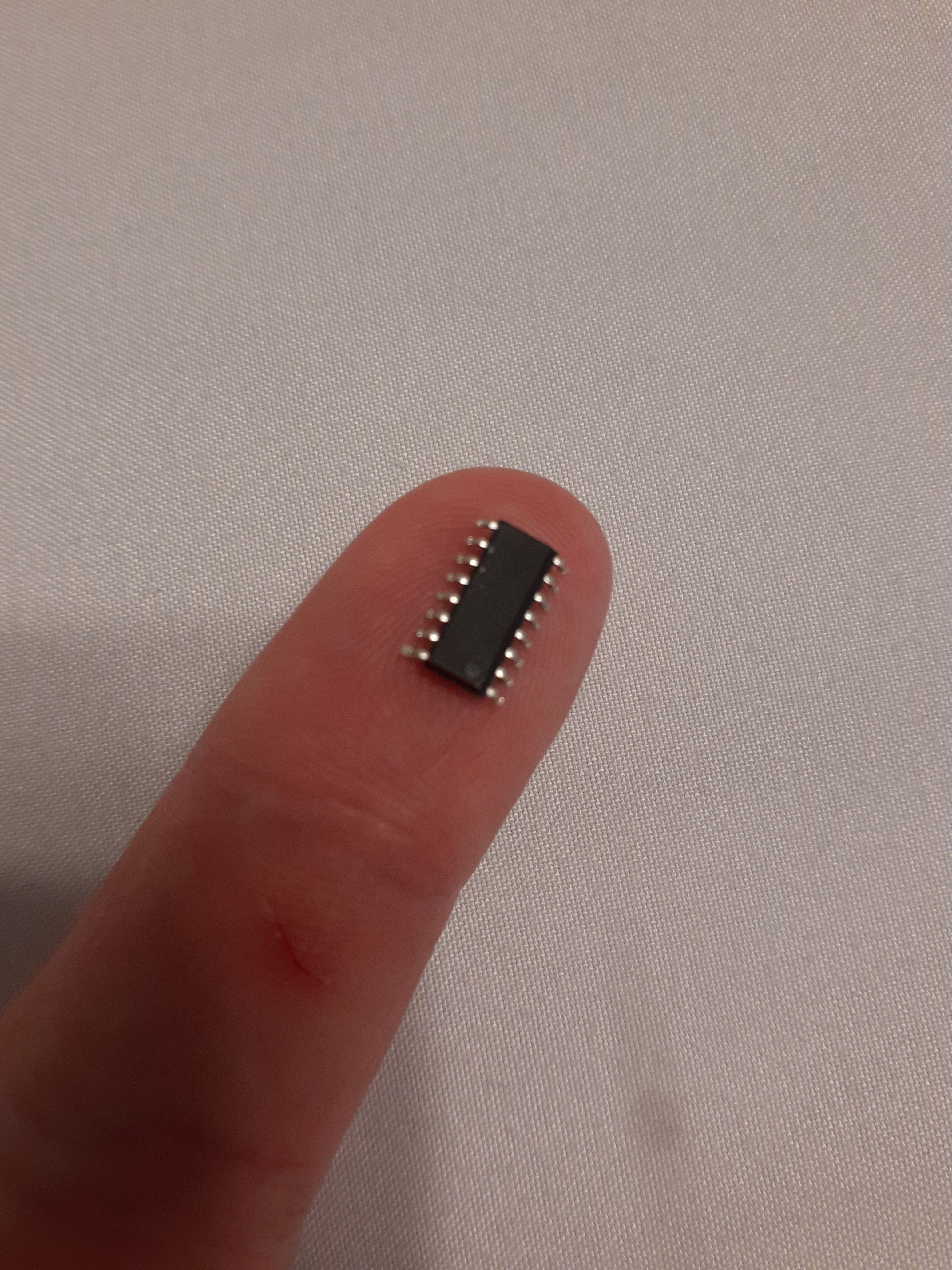

@NeoHoth I was able to find one of the chips I had from ONE of the daughterboards from the aftermarket modules with the pot-look-alike-hall-effect-rockers. I couldn't salvage the other one since it was still attached to the other module. Is THIS chip the one that is the DAC microcontroller? If so, then IDK, somebody needs to actually create a DAC from an ATTiny85 microcontroller chip instead of having to use one with too many pins unless we know how to get these working while soldered to the rockers or parts of the Pro Controller board with the correct solder points.
EDIT: I was able to salvage the second chip from the second daughterboard by getting it out of my garbage can (mostly due to myself being a dummy tossing it in there without knowing about the chips).
I guess this is a DAC chip (with SPI Flash and Voltage Controller Combined) that is actually adjusting for hall sensors those are soldered to those 3-pin connections per axis.
I am an amateur in the field of microcontroller electronics, so it is better to ask or wait for an expert's viewpoint.
I'll ask him about these chips and whether they can be soldered to any kind of controller of course.
EDIT: I looked up the model number of the chip and it's an MC32F7361A0K-21828-27 (look up MC32F7361on Google) microcontroller chip so these might have a DAC built into them. Now we need to know whether it can be possible to solder these chips onto a DIY breadboard, or use some precision micro-soldering for each pin to use for both the X and Y axes of both sticks.
EDIT 2: If it would be possible to reverse engineer these kinds of chips for open-sourcing for all game controllers to use either some hall effect rockers or any hall effect sensor and a magnet with any MCU like an ATtiny85, it just might work well.
