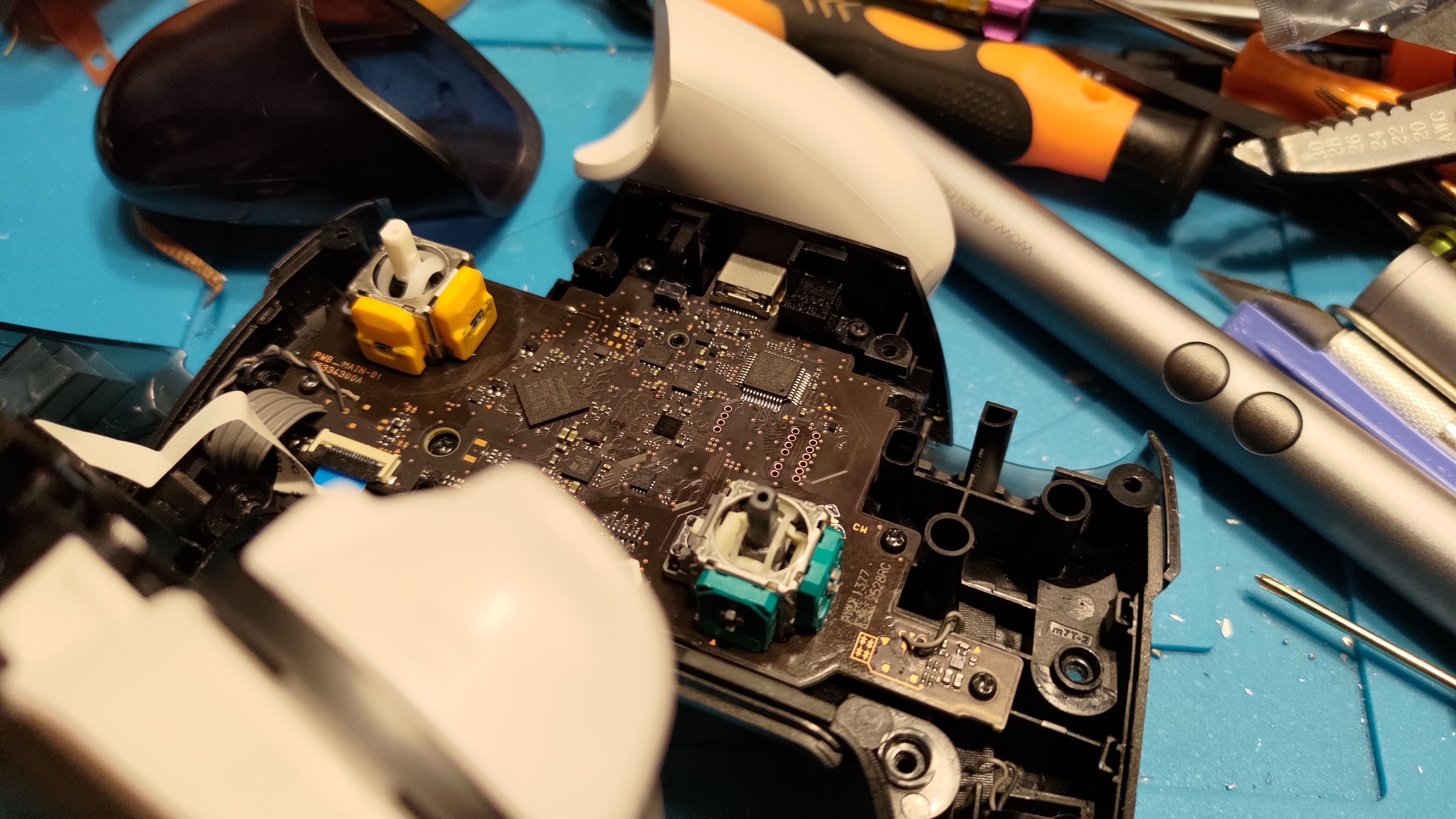

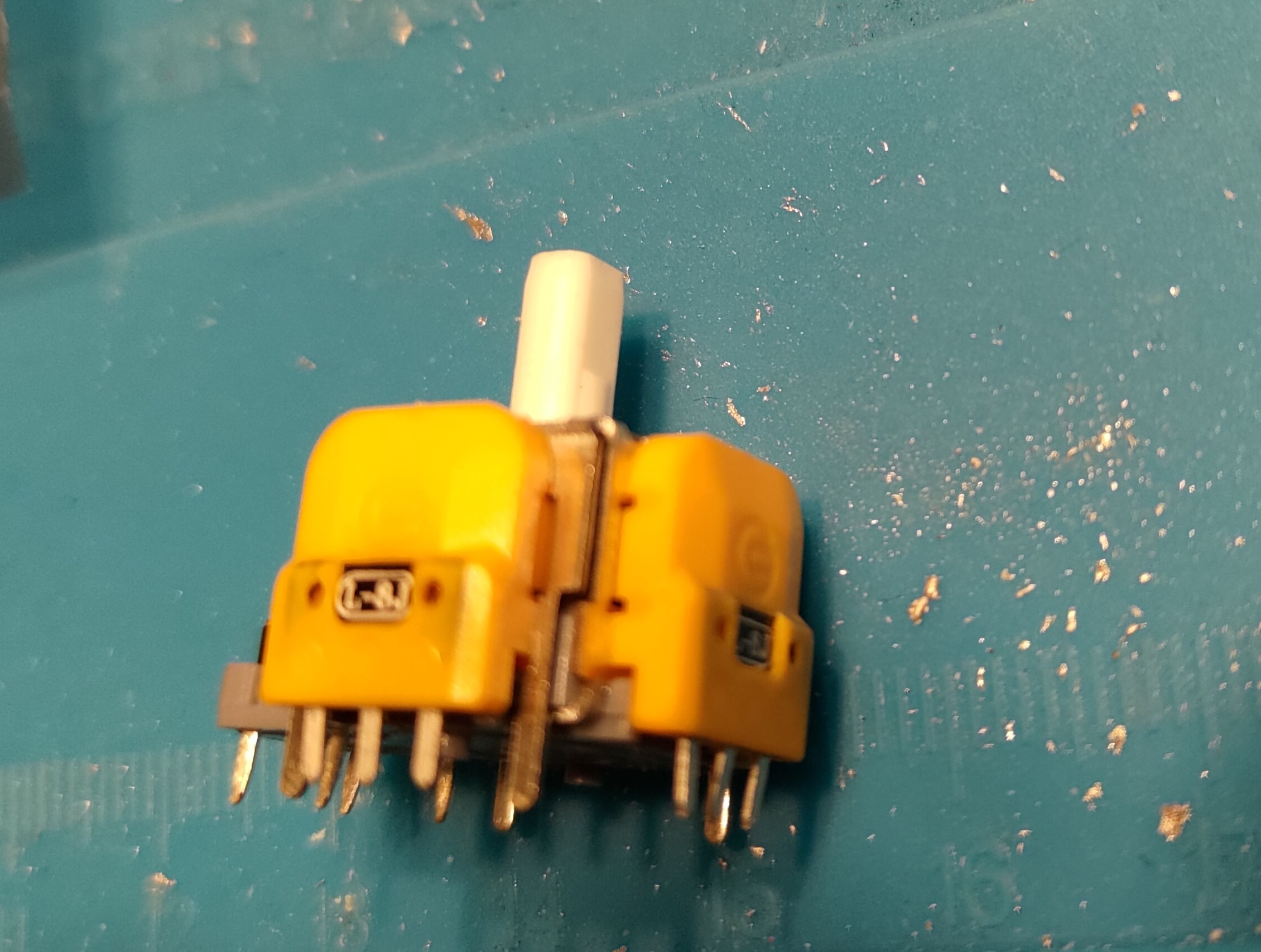

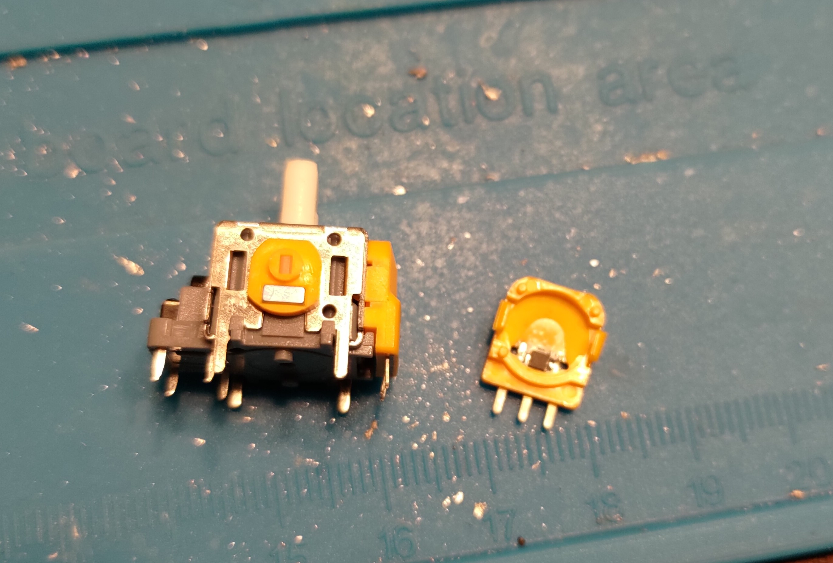

You sound like you're giving up. Well I have to say there is a light at the end of the tunnel. And I'm enjoying it right now.
I bought two different hall effect sticks from aliexpress the blue ones, branded K-silver, and just today I received the other yellow ones with the white shaft.
The blue k-silver blue ones are no good, I got all the issues you describe. Tried all sorts of things, changed them like 6 times, thinking I got some faulty ones and that among the 10 I got there had to be at least one good one. But no. I messed up one controller board. My advise, tape the connection on the rumble motors before trying to solder/desolder anything, those things are fragile AF.
Ok, enough rambling. The yellow sticks with the white shaft, actually do work, they have a G on them, I pressume is Gullikit but I have no idea if that's true. I installed one today, and to my surprise and joy (after all the shit I did before). They actually accept calibration with no issue with the controller fully assembled (Yes I tried calibrating the other ones with the top part off, it just wouldn't work).
The sticks are alright, they are quite more precise than the regular potentiometers. However they are a bit easier to push, and that makes them feel a little bit loose. But yeah if you think you will benefit from having hall effect sticks those yellow ones do work and quite well. You just have to get used to the little bit lighter resistance on them
UPDATE
The deadzone felt larger than the stock joysticks. So I remembered what you put about the joycon toolkit. I manually reduced the deadzone to 48 instead of 96 that was the value It was showing me. It works a lot better. I'm affraid to try lower values lol, but this looks insanely promising
UPDATE 2
I got the deadzone down to 1A, which for some reason is what comes right below 20. Also reduced the range from F33 to F20 on the Joycon toolkit. I think I'm going to leave it at that, it feels very responsive an accurate. Go buy these things and set them to your liking XD

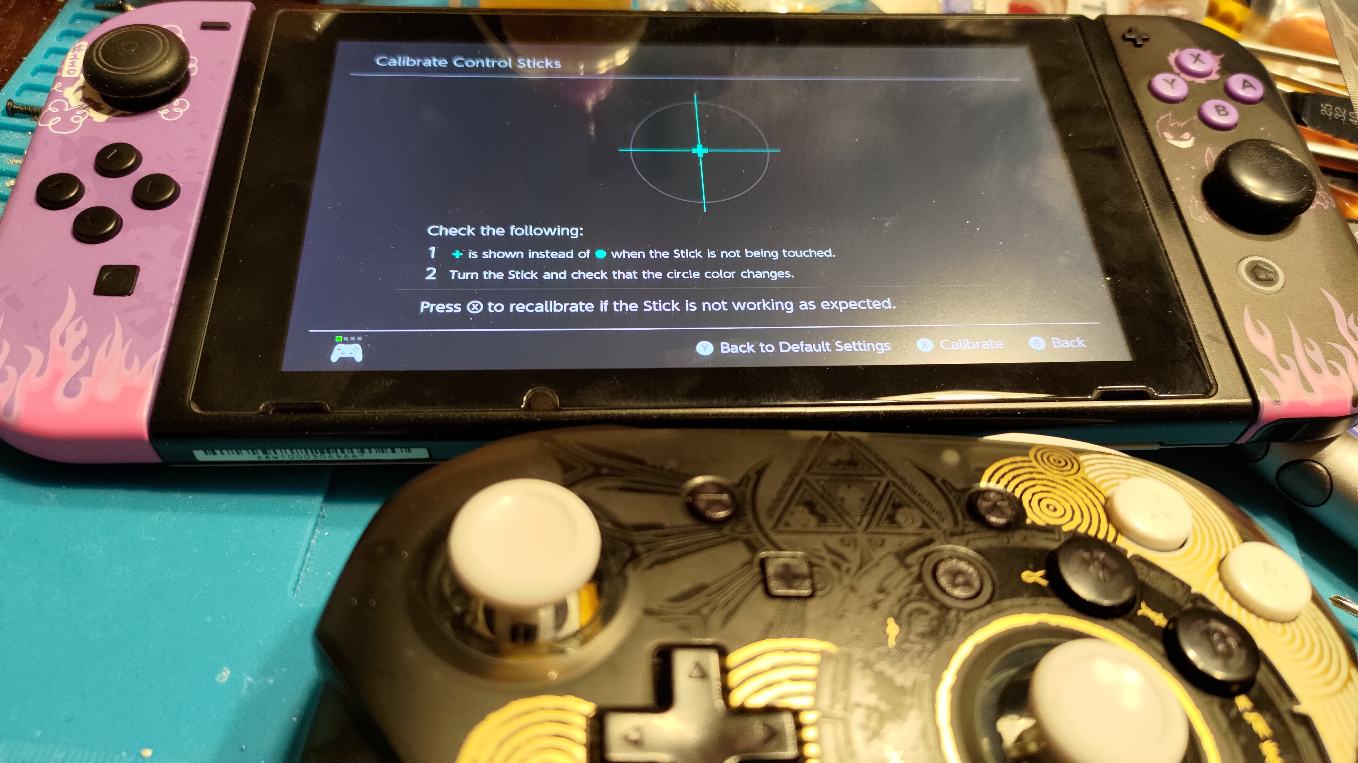

I only plan on using them on Switch.
I experienced the shorter range on the other ones.
Looking at these ones on the switch stick test, they appear to have the same short range, and are off-centered before the calibration. However, for some reason on these ones, the calibration actually goes through and they gain full range of motion.
The only problem was the deadzone which felt larger and the range a bit too large as well. I was able to fix it, by manually reducing them using the joycon toolkit on my PC.

how is circularity on these sticks? Do they reach 100% range too early (like the stick registering 100% when you didn't fully tilt the stick)?
Yes they reach 100% to early. On the Switch you can correct this behavior with the calibration tool.
