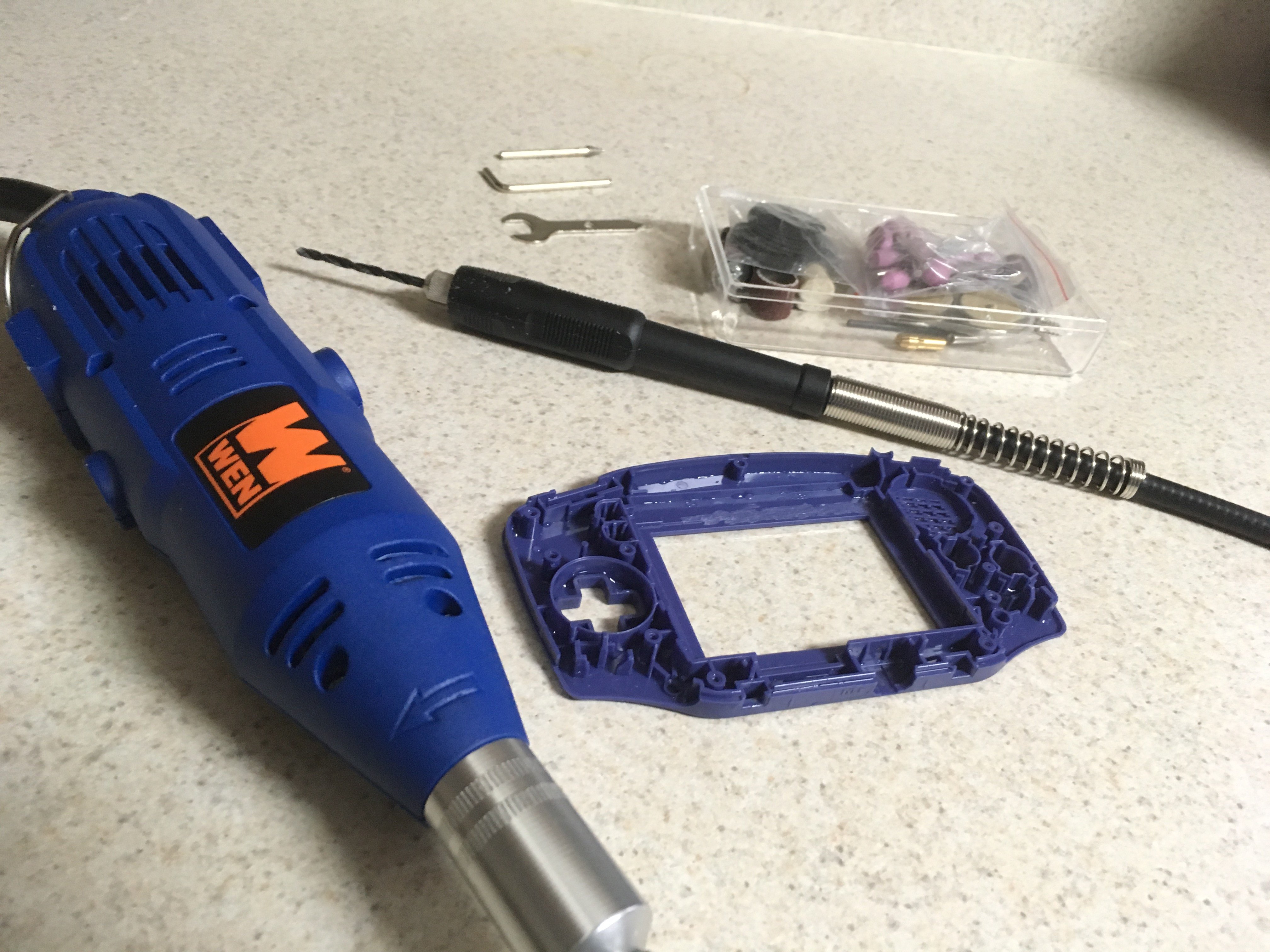

Got my rotary tool today so I'm starting on the shell modding while I wait for the rest...

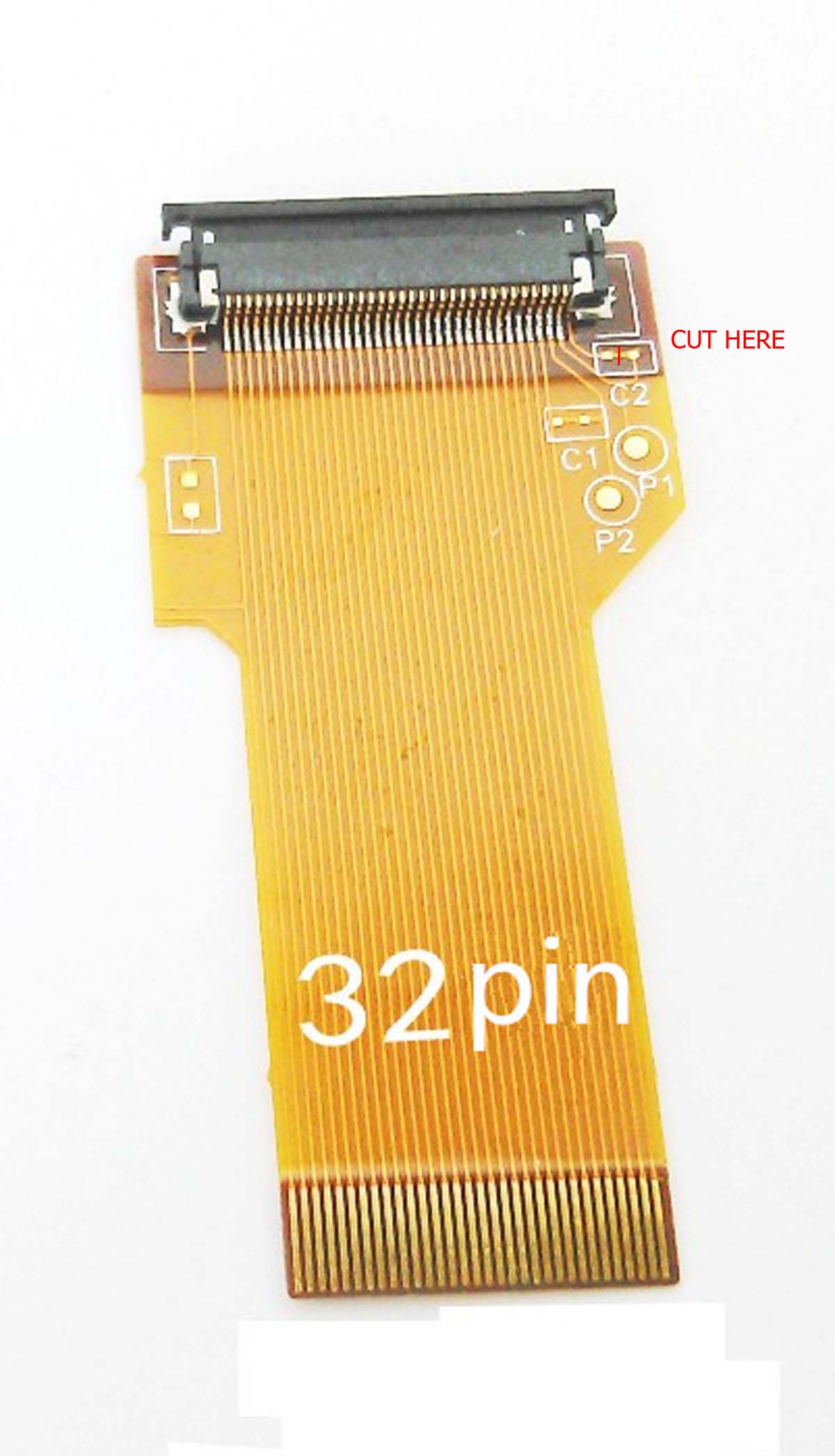

I've measured the voltage on the left leg of DA1 and it is about 13V, while you are using 12V with the step up converter. If the DA1 leg already provides a high voltage, what is the problem with DA1 then? Can't it supply enough current?
I have ordered a 32 pin adapter and my intention was to directly solder the P1 to the DA1 leg. In this case, is mandatory the cut for isolating P1 and the 5V rail? I have seen that most people just solder it without cutting, with no problems (apparently...).
Could you indicate in a photo the trace that needs to be cut?

Hi ServenIkhana.
Yes, there are about 13.5V on the D1A pin, but after connecting the LCD backlight the voltage drops to 11V, because it cannot supply enough current. LEDs are non-linear devices, so altought it could be hard to believe, there is a big diference in brightness and current between 11V and 12V. Unfortunately, there is no point inside the gba with 12V, capable of supplying enough current for getting the LCD maximum bright level. And that's why external circuitry is needed.
Referring P1, I can't tell if it is mandatory to isolate it (using my 12V step up regulator I can assure is mandatory to isolate), because as soon as I received my adapter I cut the trace (just to be safe). But there are people complaining about the console turning off after soldering the cable, so I asume this could be the reason. Anyway, I highly recommend you to isolate it, to avoid shorting the 5V rail with the 13.5V one. In the 32 pin adapter I have is very easy to do, I attach a photo showing where to cut (don't know if yours is different).
After cutting that trace, the backlight will no longer be powered trough the 5V rail (it will stop working), so you can connect it to wherever you want (3.3V, 5V, D1A...).
