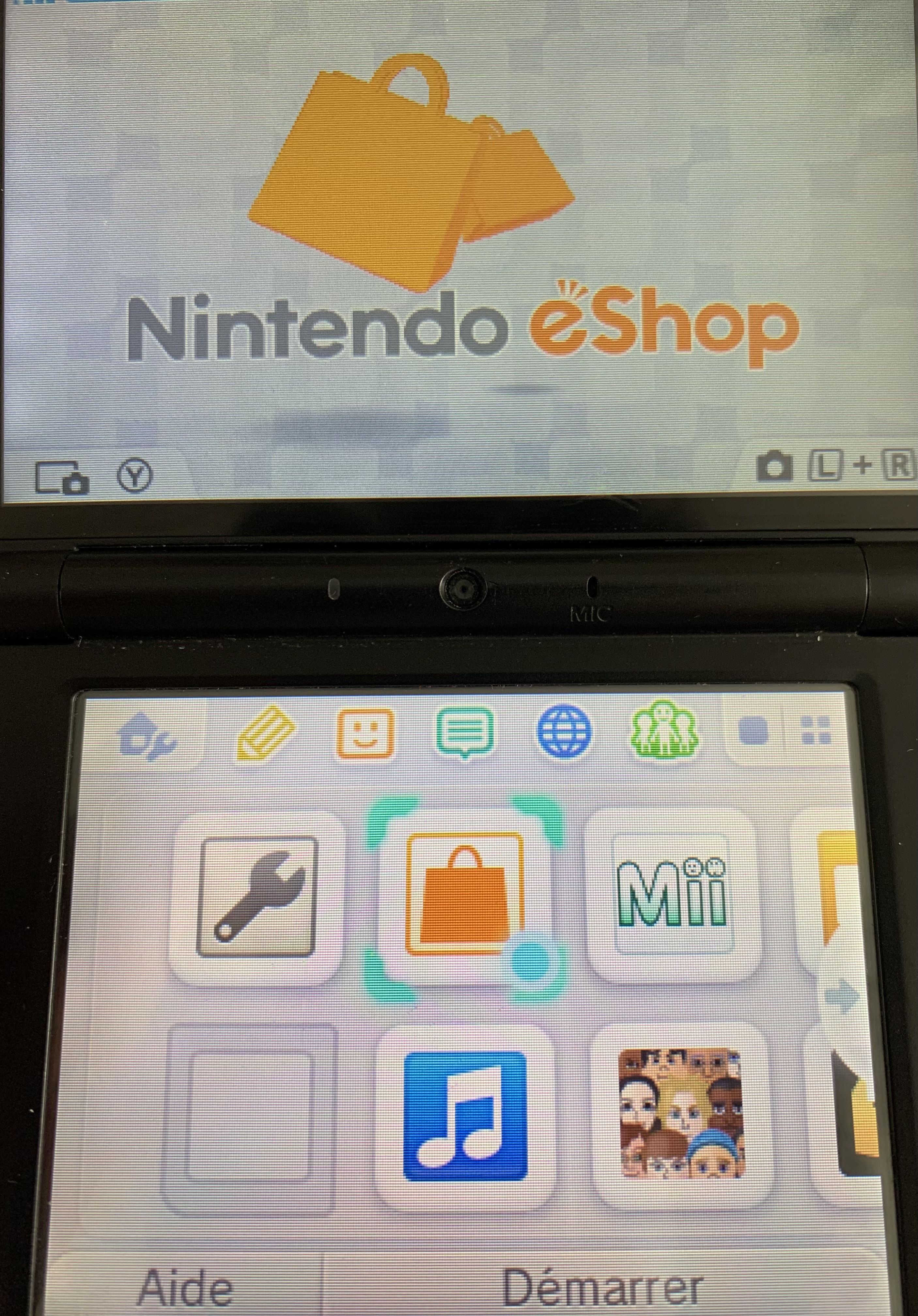

I mean, you can also wait longer, I'll release some homebrew eventually to callibrate your screens with... It might not be user-friendly, as it's mainly intended for repair shops, but yeah...
Okay thanks, I think it's not a problem if it's not user-friendly (as long as there is a tutorial...). Do you think it will be available in a near future ?
I think I could try bringing up to standard just barely enough where it could be used with assistance without having to teach a lot of math and all that magic stuff.
Prepare yourself:
- select which color you want to match the screens with (gray, white, red/green/blue, etc.), as TN and IPS have different color curves, can't really callibrate that
- select two brightness levels (yes, it has to be two, not one, nor more) where you want to exactly match the brightnesses
- you'll still have to match all 7 brightness levels, even though only two of them will match perfectly
- these settings are lost when you factory reset your 3DS
Early adopters tax, I guess.
If you don't want to deal with this then please tell me, so I can act accordingly.

Thanks for your answer, I am not sure if I have to tell you now but I don’t know which color I want, if it’s IPS or TN I think it’s not a problem or the color you think is the best.
Aren’t there 5 brightness ? I think I would select the brightness 5.
If I don’t want to deal with that what will change ?
There are 7 brightnesses, level 0 is hidden, and level 6 is just level 5.
If you don't want to choose a color, I'll choose light gray, as usually that's what matters.
Well, if you don't want to deal with the other brightness levels, then I could make it work in the math, but then the brightness will be noticably off in other levels.
If you want level 5, then I recommend selecting level 3 as the other one, that's how you'll get the best brightness uniformity for all 5 levels.

By the way, here is a photo of the screens (you can’t see the difference in the photo as much as in real life)

Will light gray looks like normal, like the original color ?
Then, I meant level 6, sorry(if it’s the level 5, which is at 142).
I am not sure I understood, I have to choose 2 brightness levels on which the brightness will look good, am I right ?
The other levels won’t look good looking when speaking of brightness, am I right ?
Light gray is chosen, as if you average the screen contents over a long period of time, you should get light gray.
I can't choose level 6, as you can't select it in Home Menu. It'll have to be level 5 and level 3.
Yeah, you're choosing two brightness levels which you can match *perfectly*. For the others, there is no guarantee that they will be brightness-matched for the selected color.
