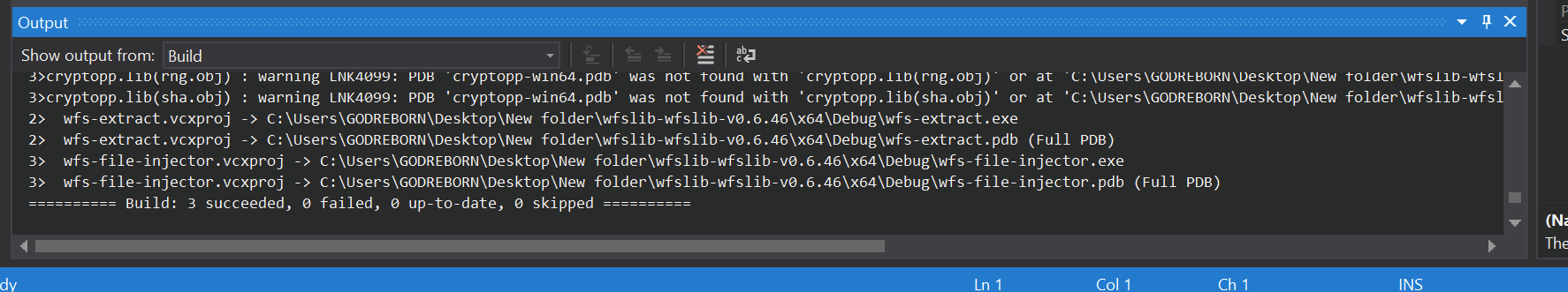

I figured that out, but now I get this:
it's a problem associated with boost, and I have no idea how to fix it.

I think this is what I'm supposed to use, but I'm not sure how. at first, I tried adding them to the directories listing, then I tried overwriting the files in boost with those of the iostream/boost/include iirc:. however, both resulted in the same error above. I read that this is an issue with earlier boosts, but I tried 1.77 I think it was.
https://github.com/boostorg/iostreams/releases

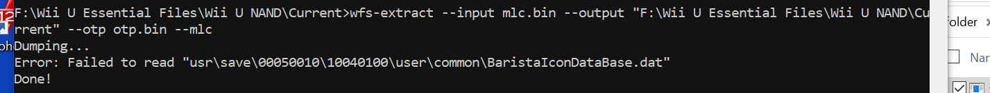

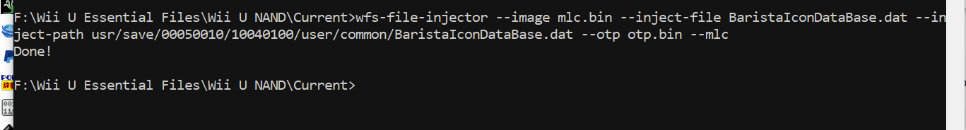

I compiled the new version of the injector, and it worked with capital letters:
however, it still errors with the extractor. it cuts off part of that file above when it's reading the mlc. I don't know why. I think it's a bug of some sort.

Well, I fixed the error above by injecting the BaristaIconDataBase.dat back into the mlc. The original has issues with uppercase files.

I had a file in the mlc dump that I think was corrupted, so I ftp'd the file then used wfs inject. It sometimes does and sometimes doesn't work. It worked for me though. It was the BaristaIconDataBase.dat.

what's odd is that that file I mentioned seems to be cut off when extracted, even with the forks, compared with if you were to ftp it. I don't know if the allocated space is what's causing that to happen, but I've dumped the nand like 3 or 4 times, and every time, it's that file that's corrupted (I think). it will say "cannot read BaristaIconDataBase.dat." not sure how it happened, but one time it worked. I had to compile the fork with a fix for uppercase locations, because the original will say that it can't find the location if it has uppercase. it injects without error now, but only sometimes will dump afterwards without error. I kept the dump that always works, but as I mentioned, it seems to be cutoff that file or something which makes me wonder if other files are cutoff. even when the dump dumps everything successfully, without error, that file is still cutoff.
