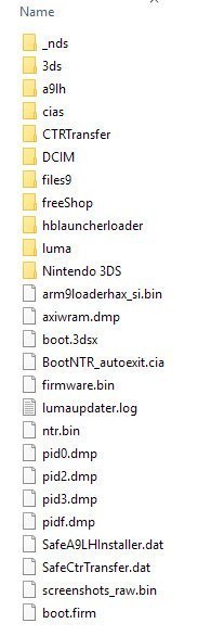

Hey, thanks for the reply! So I replaced the boot.firm file that was already on the SD card, but the 3DS still booted into Godmode9. I tried holding Select as I was pressing the power button, then tried pressing Select right after the power button and holding it. Still no dice. I'm attaching a screenshot of what the the root of the SD card looks like, if it is of any help.

ok perfect, time to upgrade your hack
https://3ds.hacks.guide/a9lh-to-b9s
make sure you follow this completely once that is complete
https://3ds.hacks.guide/finalizing-setup
follow this one completely,
then you will have a your system fully hacked and setup again
