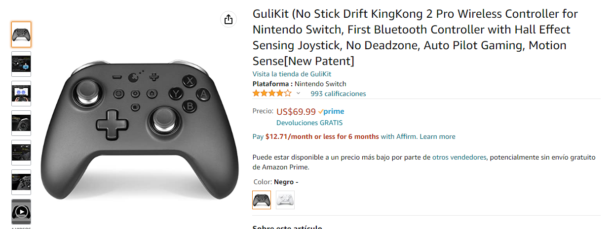

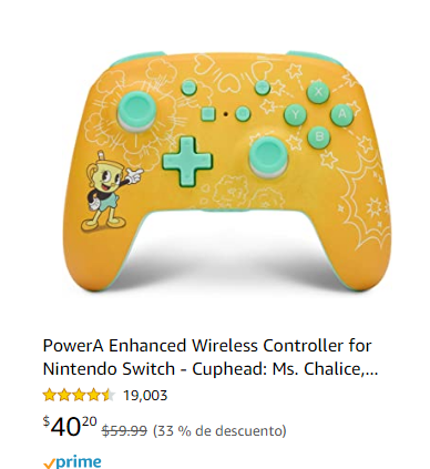

So yes, that's better. I think of these two, one for the anti-drifting issue, and I'm just looking to know if these would work for the Wiiu with bloopair and I suppose, that they do work for switch.

If they work with a Switch they'll most likely work with Bloopair as well.
oh thank you very much, maybe they haven't told you but thank you for your contributions to the wiiU scene, I imagine that the others think the same but, from me, thank you for everything you do, you are great, and well then, let's buy the one from switch.
