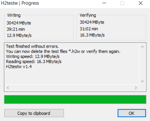

I format it again and now is working. I'll let you know when it is finished
Even when the sd card is removed?
What do you mean by "it was not possible"?
Check the sdcard lock slider, it should be in the "unlocked position". Also try with another sd card adapter.
Hi, I'm back. It says Test finished without errors.
