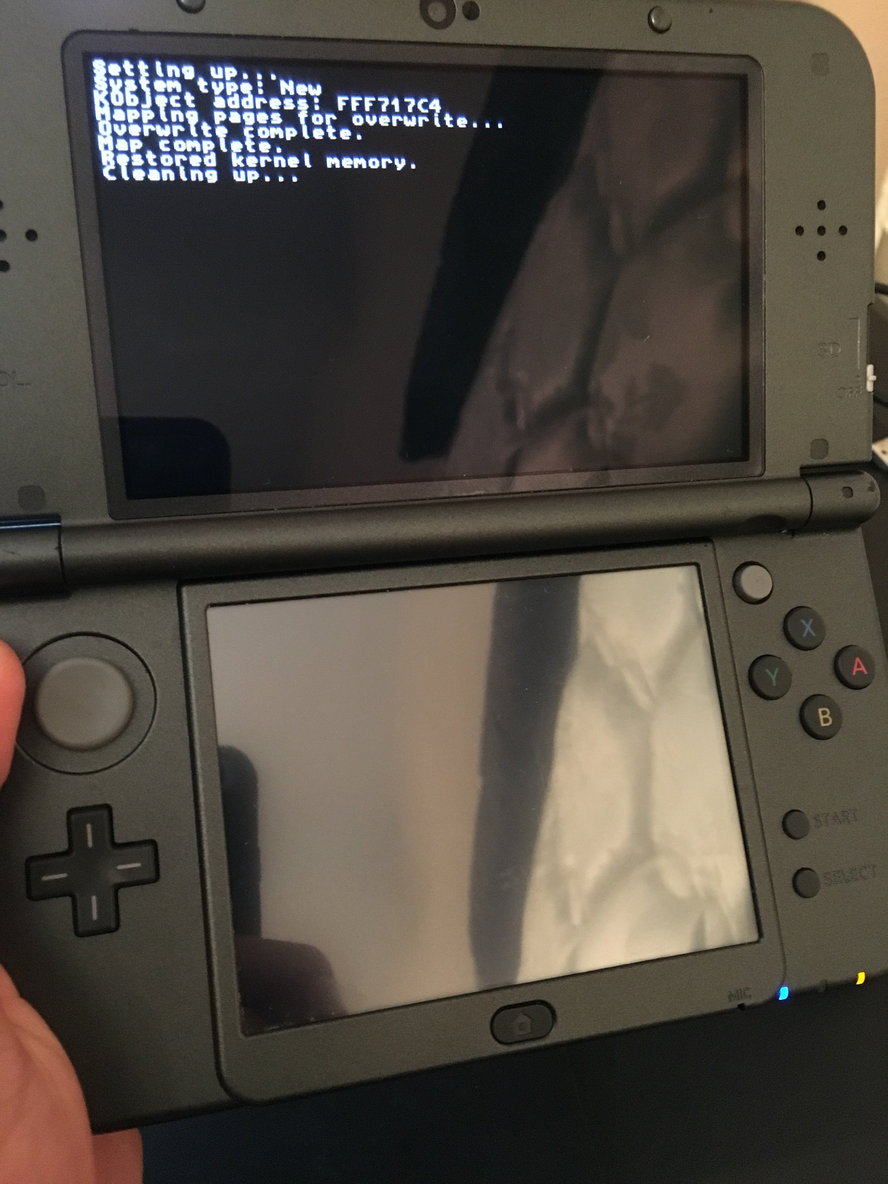

6. Launch the newly-installed Boot NTR Selector app. The first time you open it, it will check for updates and walk you through a setup process. Allow it to download the newest version of ntr.bin and choose your congifuration (setting #1 and setting #2 both work with this guide).
7. When prompted, select the latest version of NTR to boot (at the time of writing, the newest version supported is 3.6).
===NTR CFW setup is now complete on the N3DS===

4. On the N3DS, launch the BootNTR Selector app we previously installed. You will see a few lines of text, before returning to the Home Menu.
5. With the cursor highlighting an empty space or folder icon, press X and Y together. A menu will appear on the touchscreen. Select "enable debugger".

Hey everyone.
I am having some difficulties installing NTR CFW on my 3DS XL.
My 3DS XL version is 10.7 and it is the new 3DS XL
I have gotten to the point where I have Ninjahax installed and a homebrew menu working. However, when I try to run FBI, I get the following screen stuck on cleaning up.
Additionally, I am having trouble finding the Nanquitas' NTRCFWLoader.zip described in the instructions. I have found something called BootNTRSelector2.0-FONZD-Banner.zip. Is that the same thing?
Thank you!

Hey everyone.
Thank you!
The .zip you mentioned in your post is correct, that contains the NTR boot selector .cia.
As for FBI, are you using the latest version (2.4.2)?
Metalbacon
Nov 12, 2016
10
40
42
Ah! I was not using the latest version. I ran FBI very smoothly after finding it.
However, I now have a different problem. I get an error when trying to install BootNTRSelector2.0-FONZD-Banner.cia
Note I chose the option to install from the SD menu. The other menus (CTR NAND, TWL NAND) "failed to open file listing archive"
Have you tested other title managers for installing the .cia file? Personally I use DevMenu.
Metalbacon
Nov 12, 2016
10
40
42
I have tried using NASA and it looks like something is installed quickly when I select BootNTRSelector2.0-FONZD-Banner.cia. After that I'm not sure what happens. Is something supposed to show up on my home menu on the 3ds? Nothing shows up. And I don't see anything new on my SD card when I browse through the menus on the Homebrew program.
NekoMichi
Retro Collector
Jun 4, 2015
1,441
Minus World
www.youtube.com
2,982
I have tried using NASA and it looks like something in installed quickly when I select BootNTRSelector2.0-FONZD-Banner.cia. However after that I'm not sure what happens. Is something supposed to show up on my home menu on the 3ds? Nothing shows up. And I don't see anything new on my SD card.
Wait, are you running FBI from the Homebrew Launcher, or through a CFW?
Metalbacon
Nov 12, 2016
10
40
42
I was running FBI from the homebrew launcher 1.1.1. My understanding is that I needed the homebrew launcher to run a .cia manager program (FBI, NASA, Etc) before I could install the NTR CFW.
Please let me know if I am doing this wrong. All this is really new to me and I've been trying to learn and work on this for a few days now. It's pretty frustrating coming into 3DS homebrew cold turkey, I have to say!
NekoMichi
Retro Collector
Jun 4, 2015
1,441
Minus World
www.youtube.com
2,982
No worries, I had the exact same problem when starting out. :)
In order to run NTR, you will need a CFW, it cannot be installed from the Homebrew Launcher. Is your 3DS currently running firmware 10.7 or below?
